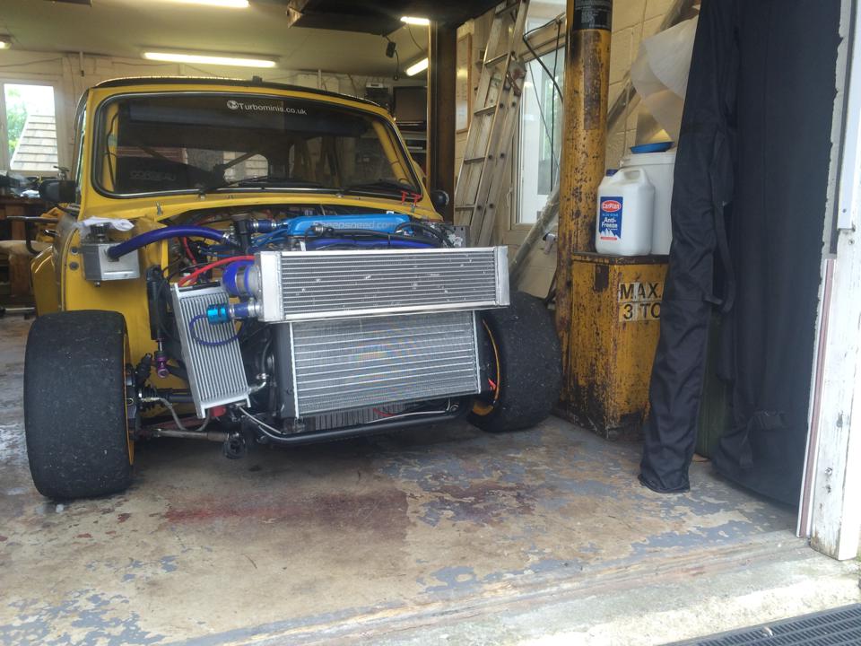

The top end tank is curved towards the headlamp end and feeds in from side at the top as shown by the yellow oblong.
The rad piping will be quite straight forward and tidy
I will either try and angle the rad further back at the top or see how much I can get it curved back
The oil cooler is about 20mm from the down pipe but still looks like it might work more like an oil heater than a cooler, I will probably end up with fewer rows and move it further down. It can also move about 25mm over to cold side of the turbo if I cut the upper bracket off as circled. Then I will probably have a mesh opening in the lower part of the front panel to feed air to it.
Edit:
This is the grille fitted with the rad in place but not the oil cooler, the head light is fitted to check for clearance.
The lower part of the front panel has been hacked off when I was trying to fit a long thin IC some time ago so I think once I have properly figured out what needs cutting out I will need to get another one

In order to try and make a decision one way or the other I got hold of a tatty secondhand Honda 1/2 size radiator so I can try it properly as I was guessing at the size of the end tanks.
The end tanks are smaller than I expected and it all fits in easier as a result, I have been able to lift the rad up so that all of the lower part of the core is exposed to direct airflow and not hidden behind the lower apron. Meaning I won't need to cut any vents into the lower front panel.
The inside of the wing rain channel also doesn't look like it will need to be cut
I have angled it back as much as I can in order to get some airflow to the top 1/3 of the rad
And if I go this route it will need a shroud to stop the air just flowing over the top of the rad
If I can make an off the shelf rad work it will save a lot of time and money as some of the quotes have been off the clock...
Edited by Aubrey_Boy on 12th Jul, 2017.

that looks neat might want to box the other sides up to the grill as well perhaps that would make some positive pressure in front wile moveing at warp speed
get a ic in front if it too?
evolotion
2909 Posts
Member #: 83
Glasgow, Scotland
as the rad is a manky one, i would defo try twisting it slightly, would make for a much neater fit if the top of the rad was twisted clockwise (looking down on it)

Yeah I bought the rad for 2 reasons, 1 to make sure of the size and the second was to curve / bend it to try and angle it backwards. Two of the rad fabricators I spoke to wouldn't bend a rad but they would 'cut n shut' - so the image below was my wooden 'cut n shut'.
Making it like this really helped all of the clearances and could mean getting a larger core area so I got a S/H Ally rad to try and bend it as I am happy to give it go on this one and if it looks OK maybe get a decent Ally one and do the same to it.
Is that what you meant?
Is your rad Koyo? Do you know if all the Koyo 1/2 rads are 'N-Flo'? I only ask because I will need to relocate the inlet and outlet, if you look at the diagram below;
If I do relocate the inlet / outlet and they are 'N-Flo' I will end up having to completely re-do the end tanks to make sure I use all of the rad.
