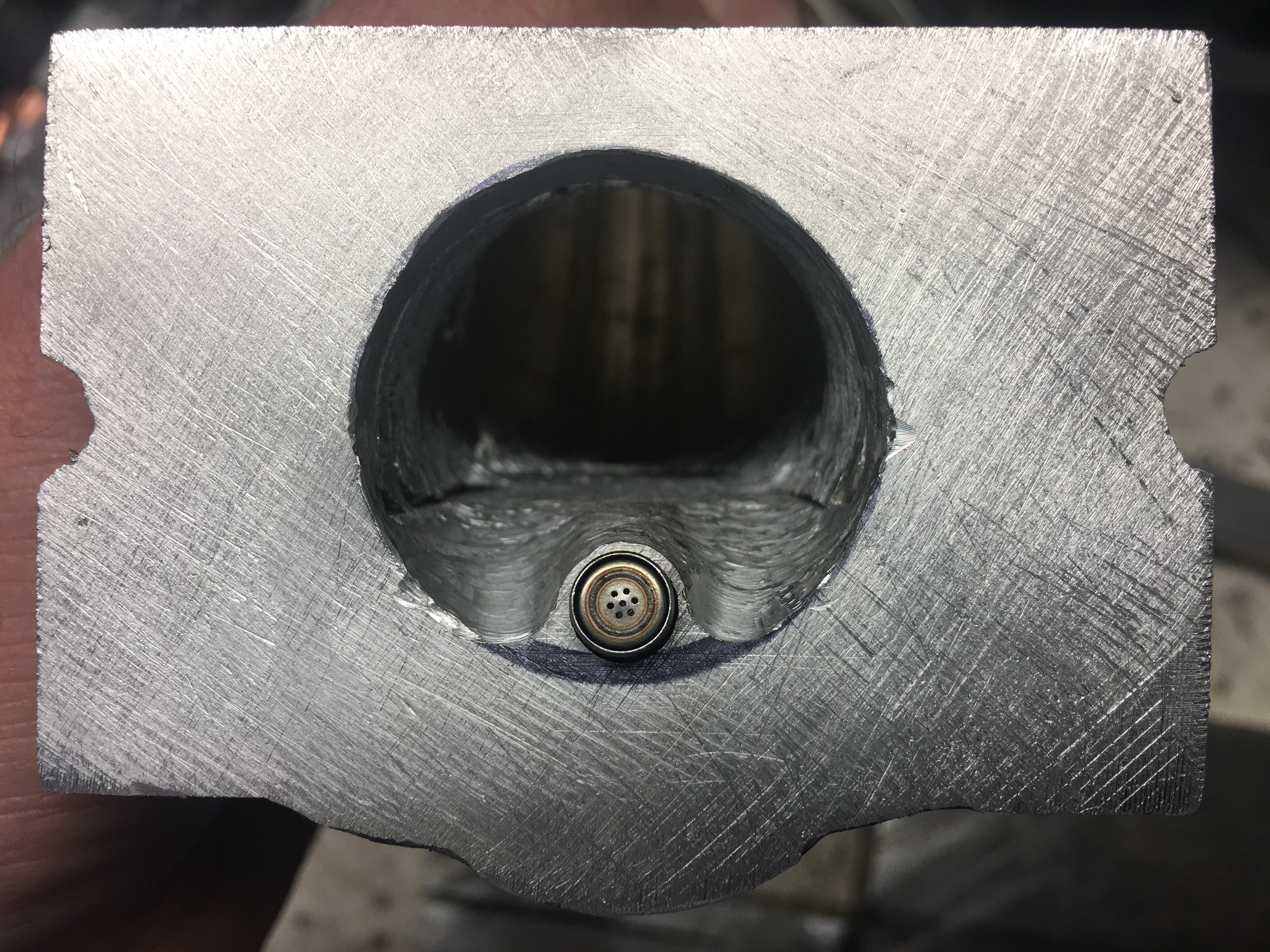

its been half a minute since the last waste of time trying to get it correct so lets try again for the 16th time possibly it might work out hey?
so the SU is at least for me to much guessing to get a profile that works so its in the bin
ive got the MS3X and cam crank angle jobbers nd most of the others to where i think EFI is just the way to go
so kinda want to still use the charge cooler but in a plenum sort of way not sure if it will be of use due to radiant heat but i think ill try it anyway not sure if having the bends at an angle will affect/bias air flow?
two positions may work but i think ill try the up front place to get the extra length in the runners what for the air charge ramming effects the bends in the uncut length are about the 480mm center line distance but ill need to chop them sort of close to the start of the bend to not fowl the fire wall n such
thinking i want to stay with using E85 fuel so that makes injector choice a bit hard defiantly need two per runner possibly something smaller for low speed then a big honker for mid to high?
with the E ill need 30-40% more than normal so perhaps 400 and 1600 not sure if having a big change like that would make it hard for the change over point?
im thinking the big single pulse method is best ?

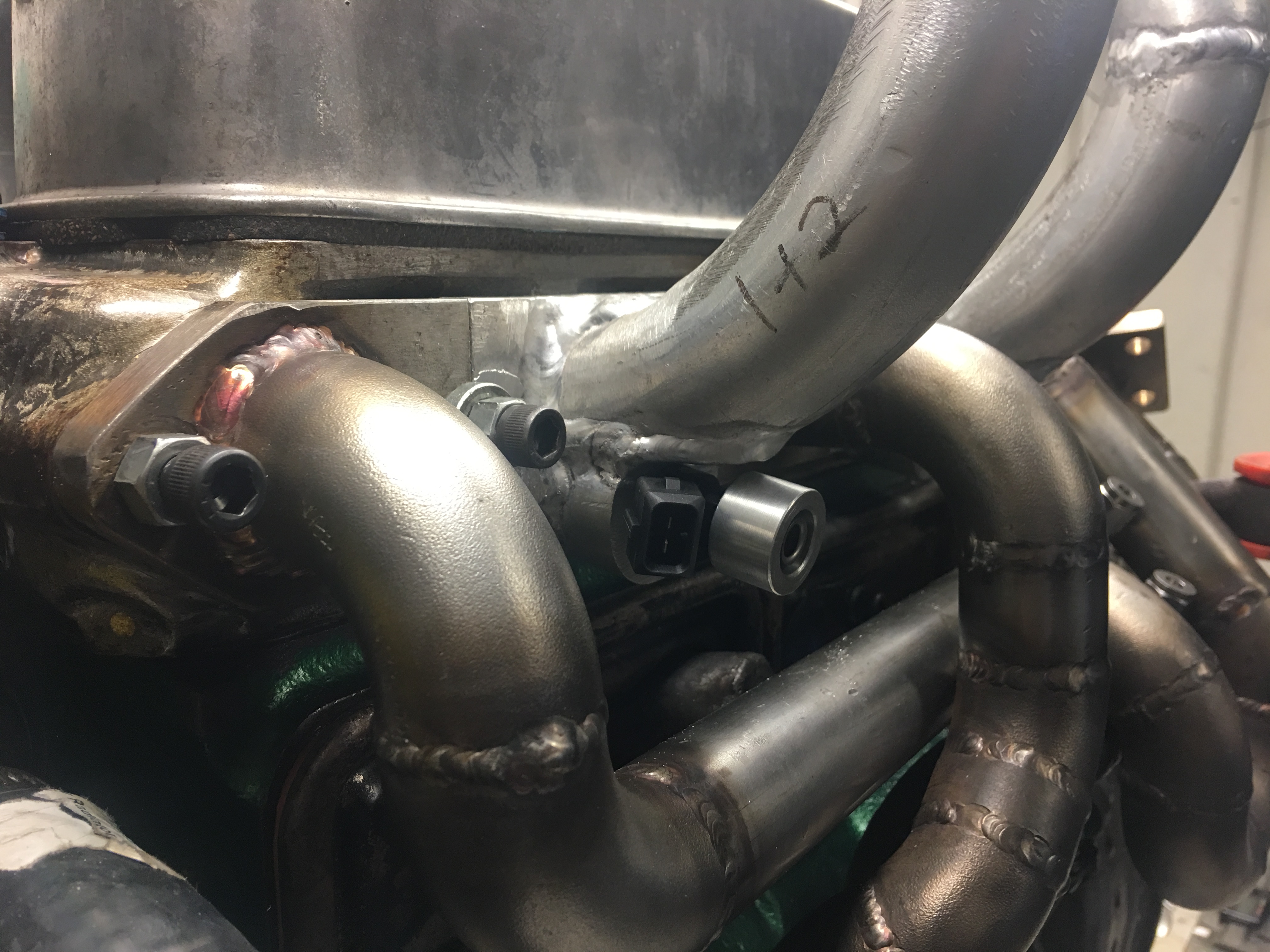

sort of need to figure out the injector numbers to work out where they will go i think the best placement is super close to the head face and vertical ie on top or under or both so long as then don't point to one cylinder or the other
once i know that ill have a try at spinning some injector bosses out to weld in

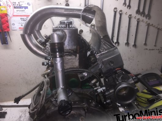

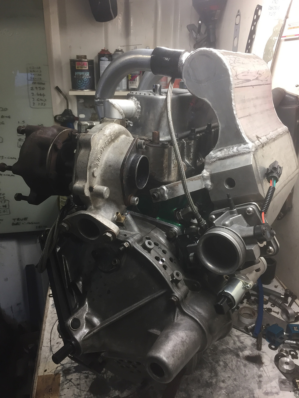

well a little progress i changed the layout a little
getting the dip stick out will be interesting!!

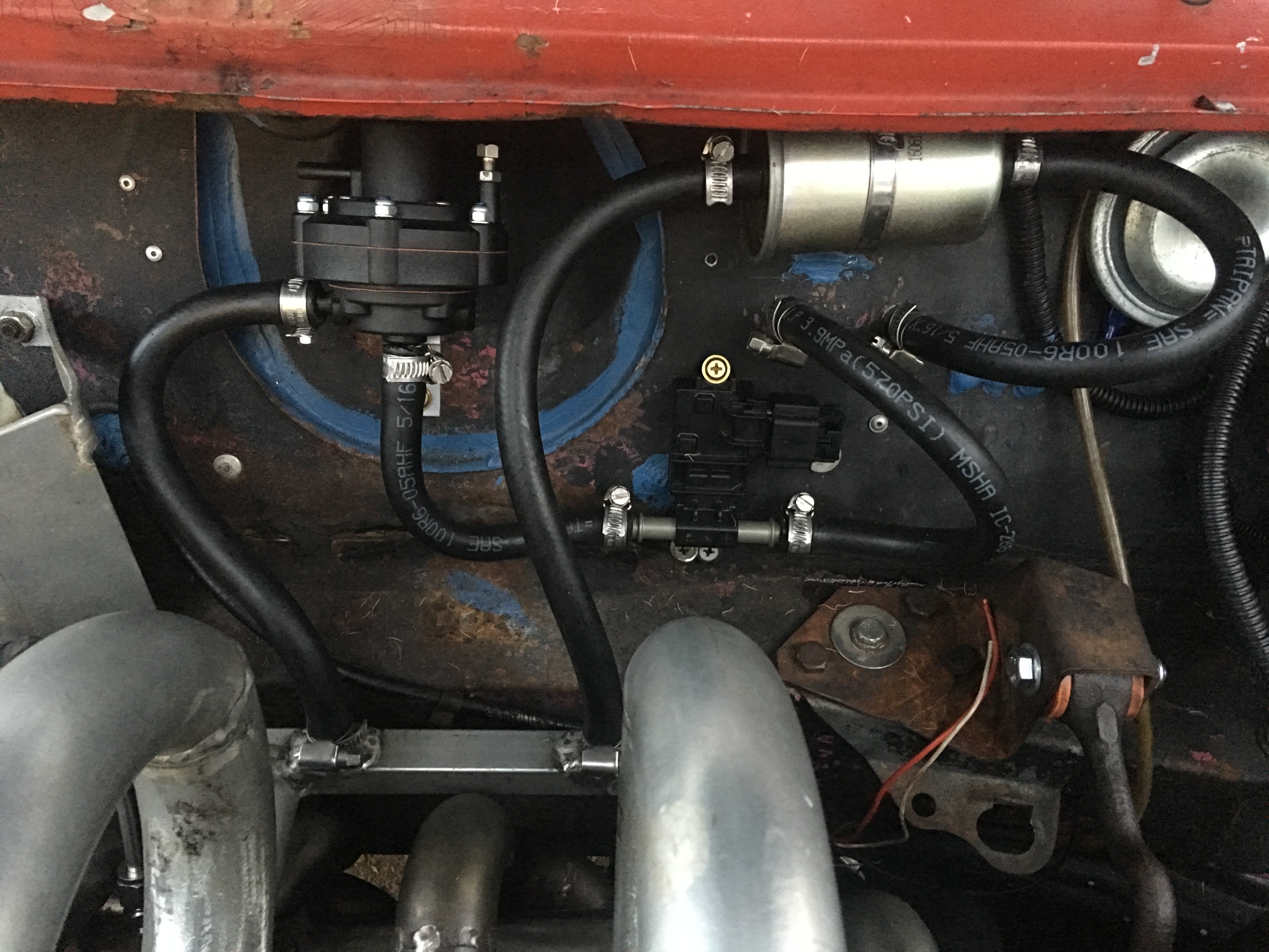

what type of fuel reg do most use? the malpassi ones? or should i get a new one more suited to efi
ordered a shinny new turbo and some sc10 1" normal bore tube bends *happy*

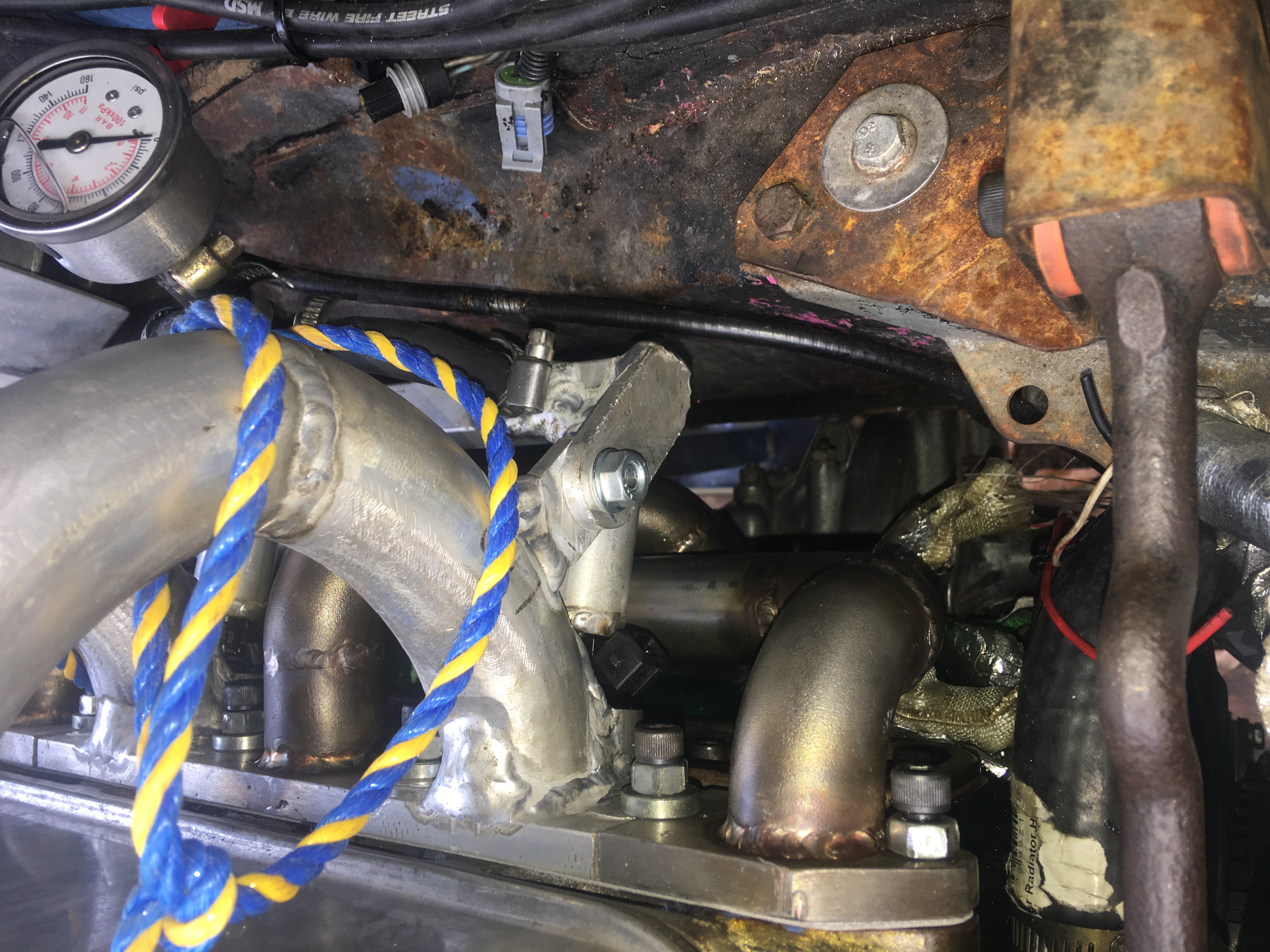

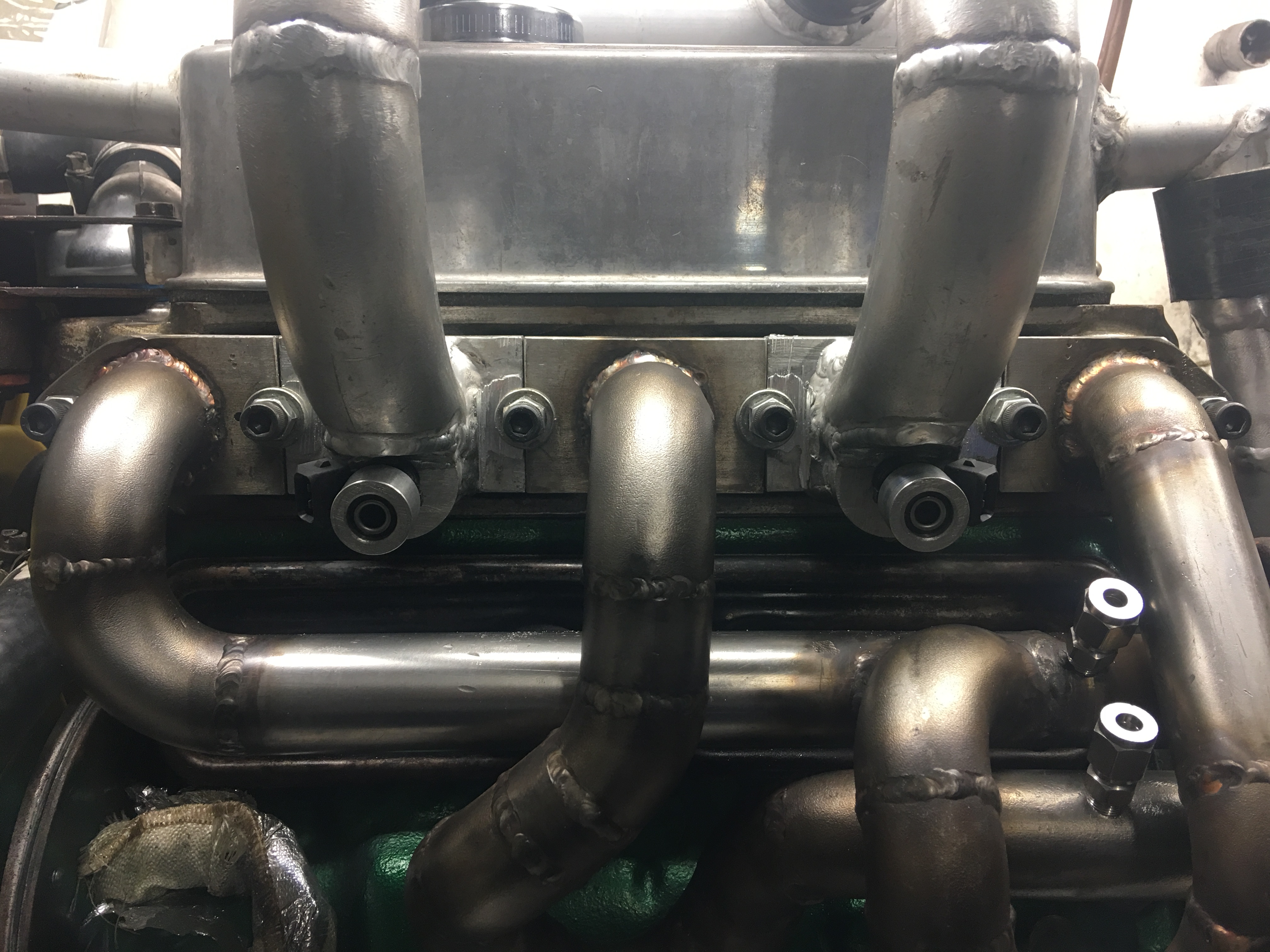

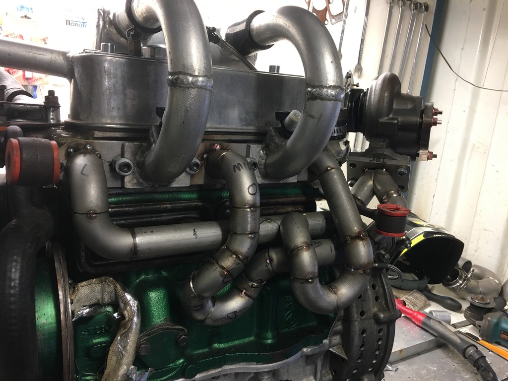

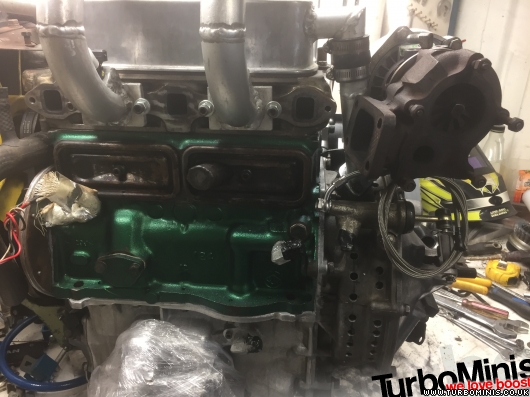

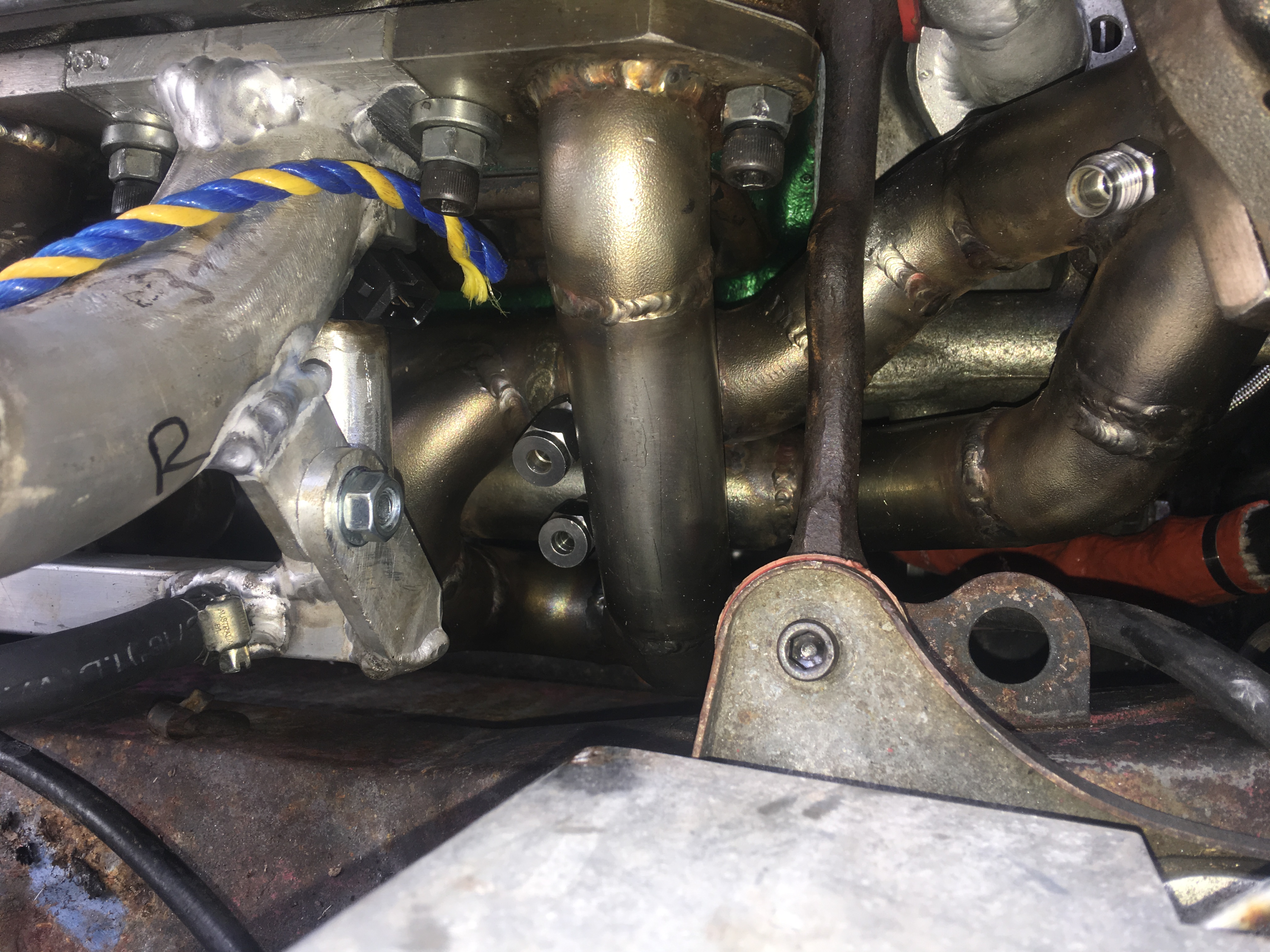

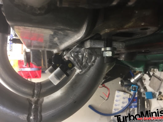

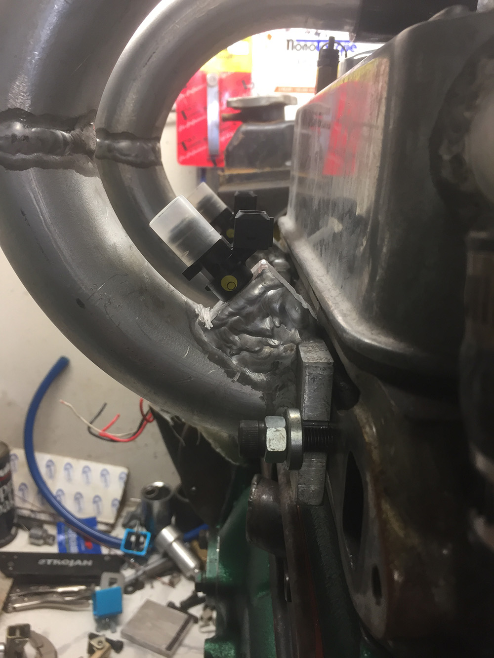

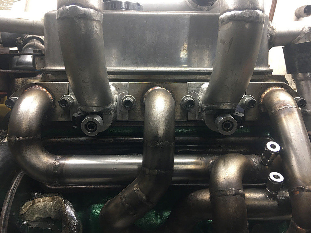

a little progress and some sloppy fabrication
not sure if the clutch slave will be ok or not?
figure there should be enough steel to disperse the heat without melting or making the seals go hard hopefully not boil the fluid ether ill probably try to wrap that bit but i guess the only way to know is to try it
quite hard to get past the steady with a full bulkhead and pre vert slave if there was more space id have brought three tube all the way to the turbo hence trying to take up a bunch of length for the center branch and to join the outer before passing the steady whilst trying to copy the lcb type headers that work well
probably going to do a hood exit dump but still wanted to keep space below the steady to allow for a proper exhaust if the fumes are to much or if the cops make me
i wanted to keep well away from the intake ports/runners to give flexibility for different manifolds and injectors dunno if it will be any good or not

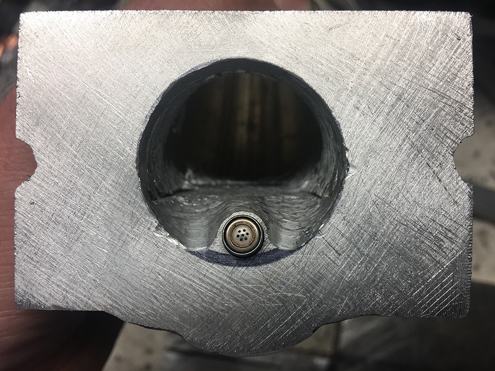

thinking i might move the injectors to be dead square with the head and on center of the port but i need to check if the bulkhead is in the way
http://www.turbominis.co.uk/photo/fullsize/3913/
http://www.turbominis.co.uk/photo/fullsize/3914/
Splendid solution to the IC.
You could use the later verto type slave arrangement. This hs the slave mounted on a bracket on the side of the 'wok'.

i hope heat soak isnt to bad with the big alu mass there but we will find out i guess
do i need to change the flywheel and all that clutch biliousness or can i mis match the pre vert flywheel and clutch with the different arm and slave location?

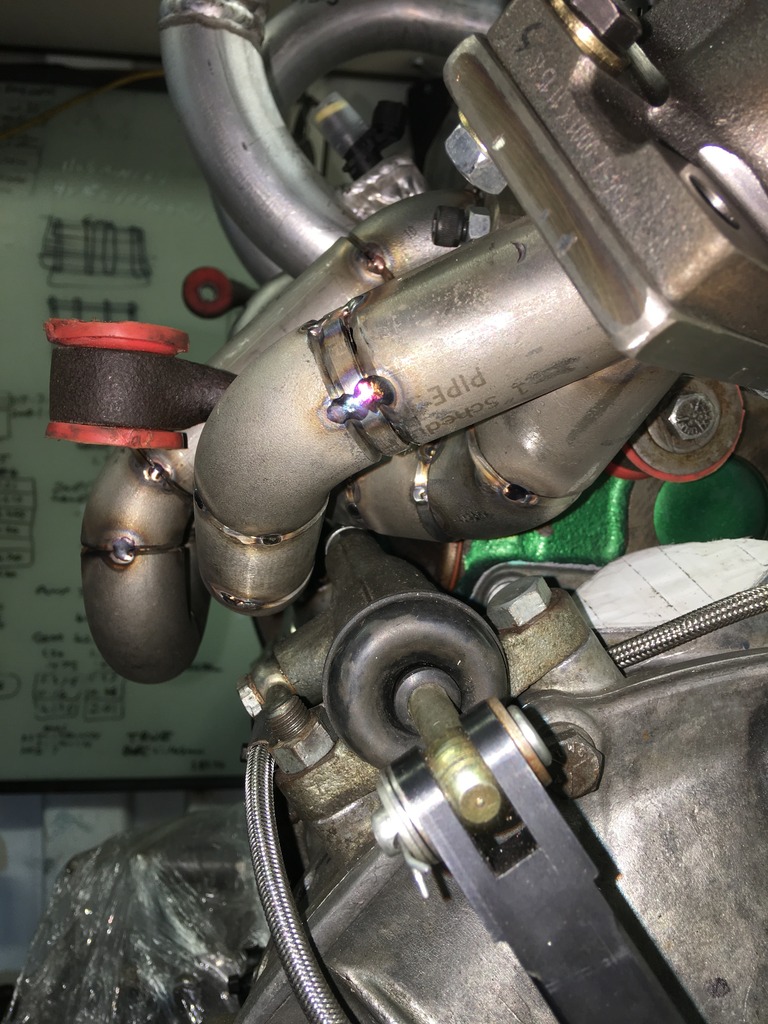

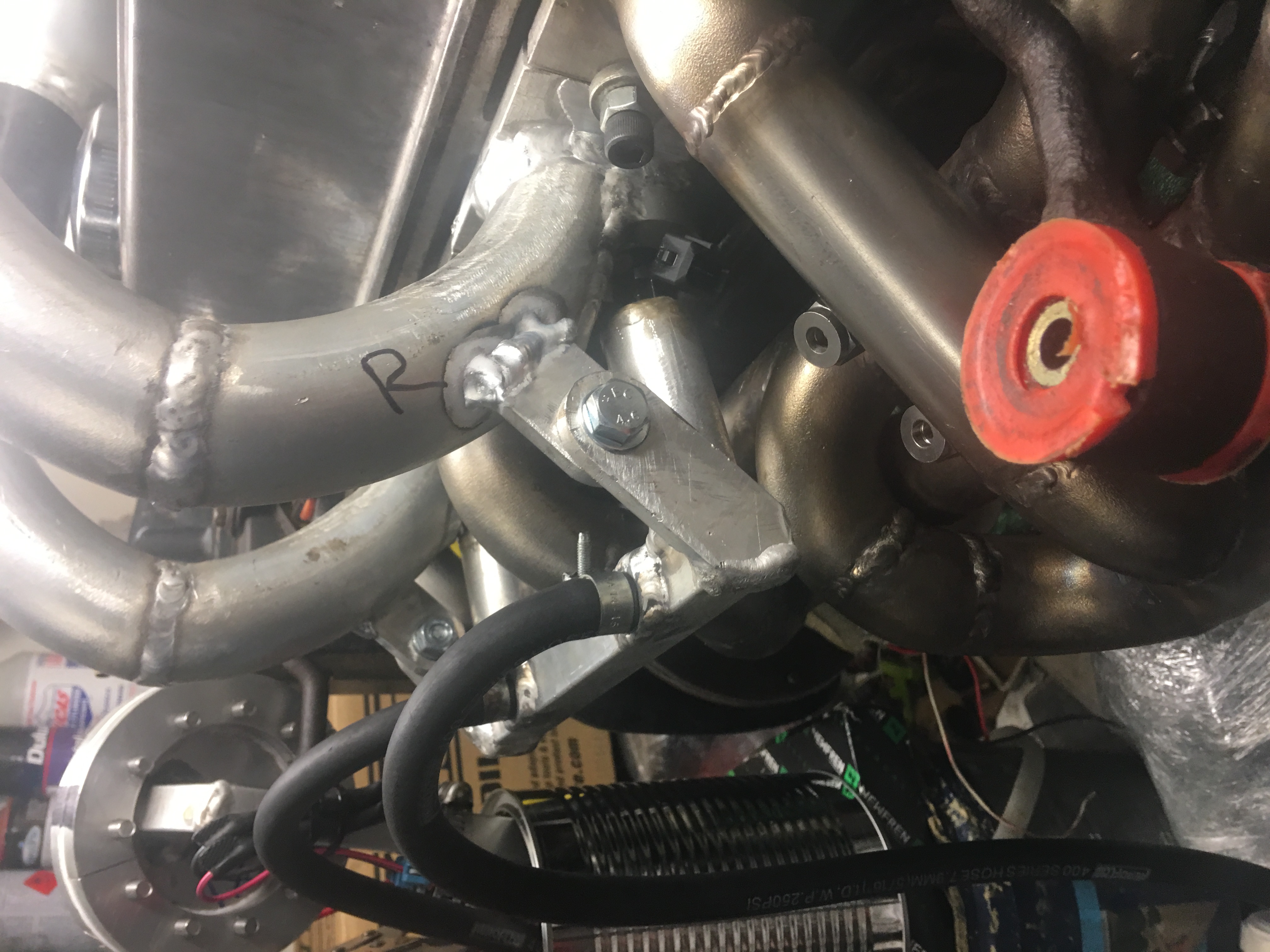

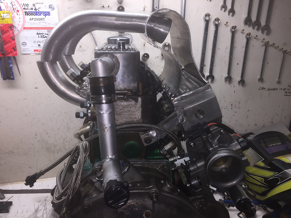

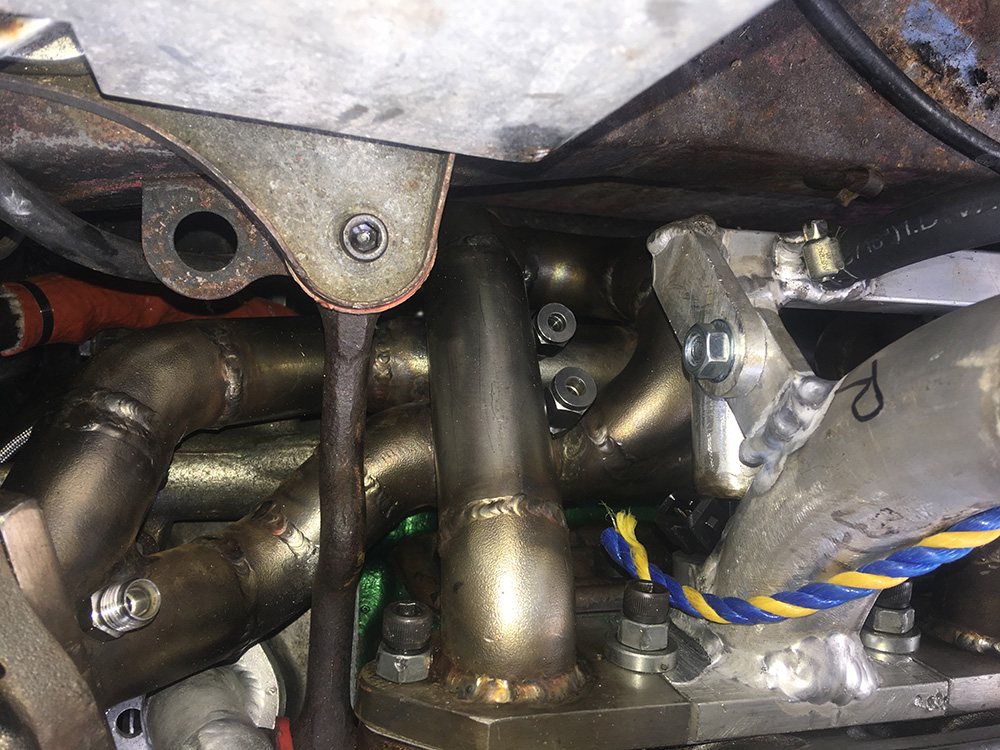

i guess next is to get the 2x 1"nom bore tubes into the 40mm flange in some kind of smooth ish transition
not sure if the turbo should have an extra support or if its ok to hang off the manifold ?
might be time to get the engine back into the car soon hopefully it still fits..

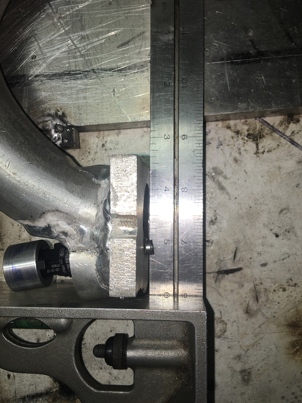

slow progress.....

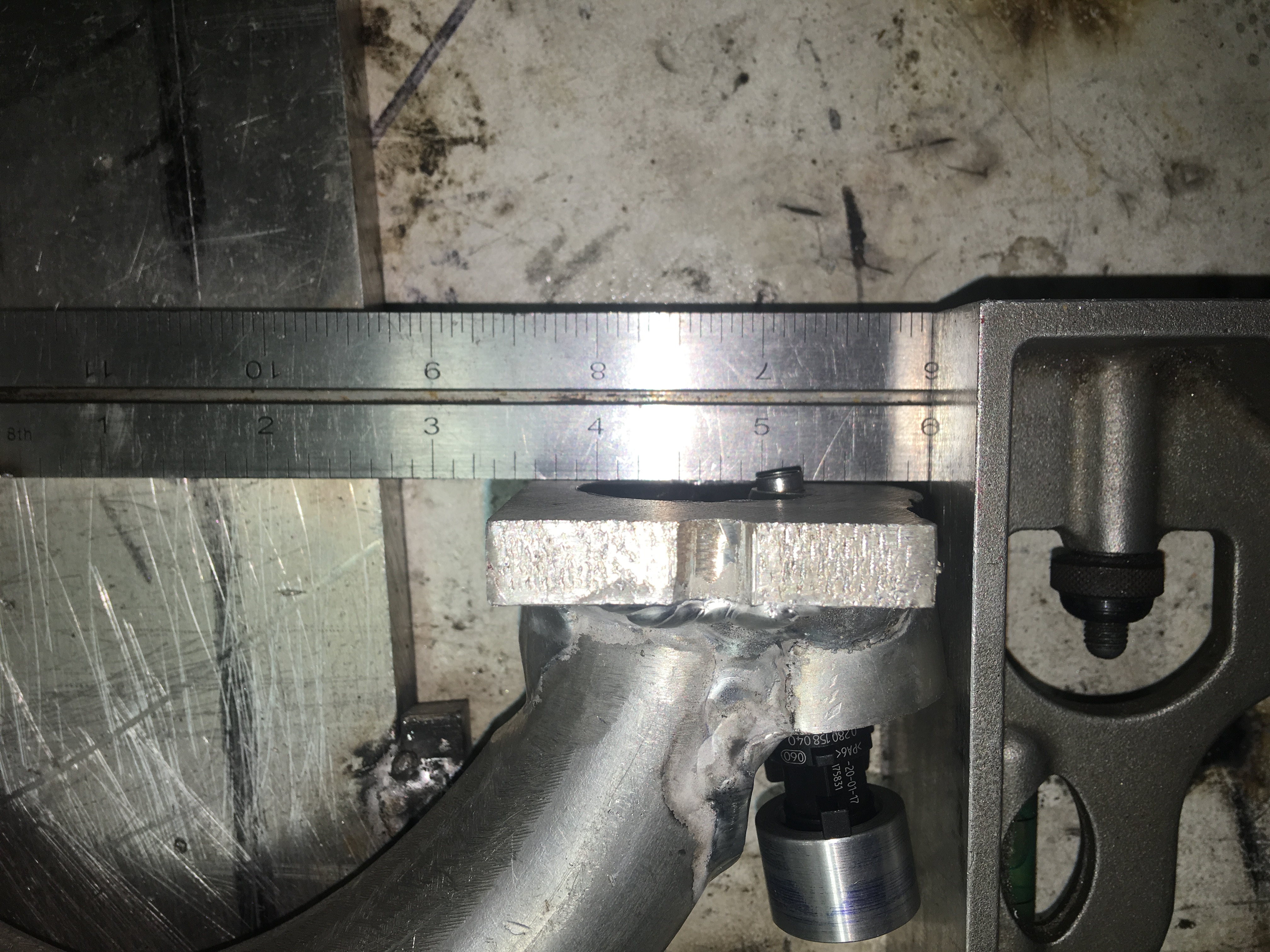

flange is on there for good now welded both sides and shaped nicely with the burr bit in the die grinder should be plenty good
although i do need to slow down and be more patient with the tig.. better prep and more cleanliness you can see when im getting in a rush and when its all going ok ish by the consistency or lack of in some places haha
i think the next things to chose from the to do list are
fuel lines at least check them perhaps replace the steel for copper
cut the inner gard open so the stock rad can vent as it normally would make up a shroud so the hot air goes out of the bay into the arch
make a small hedder tank for IC with pump directly below to insure no air and good prime each time the pump is turned on
mount new fuel reg and drill tap post turbo/pre throttle body alu tube for ref line will do once engine is in car
going to try a 1:3 rate on the reg (its adjustable from 1:1 to about 1:10) think ill try base pressure around 60psi then 12psi boost (think that's the the gate setting) makes fuel pressure rise 36psi so 96psi rail pressure when on boost now ill try different base pressures to see what the pulse with is and also need to look up the recommended min pressure for a good spray pattern
finish getting the cage in and lined up straight weld base boxes into car look for another set of doors that dont have pockets as my doors are in grate shape and dont want to hack them up rather find a different pair to hack or go for some FG ones or something

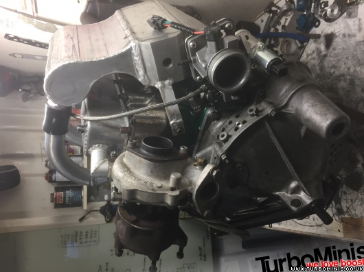

little progress
Turbo This..
1767 Posts
Member #: 9165
Previously josh4444
Australia, brisbane
pic malfunction

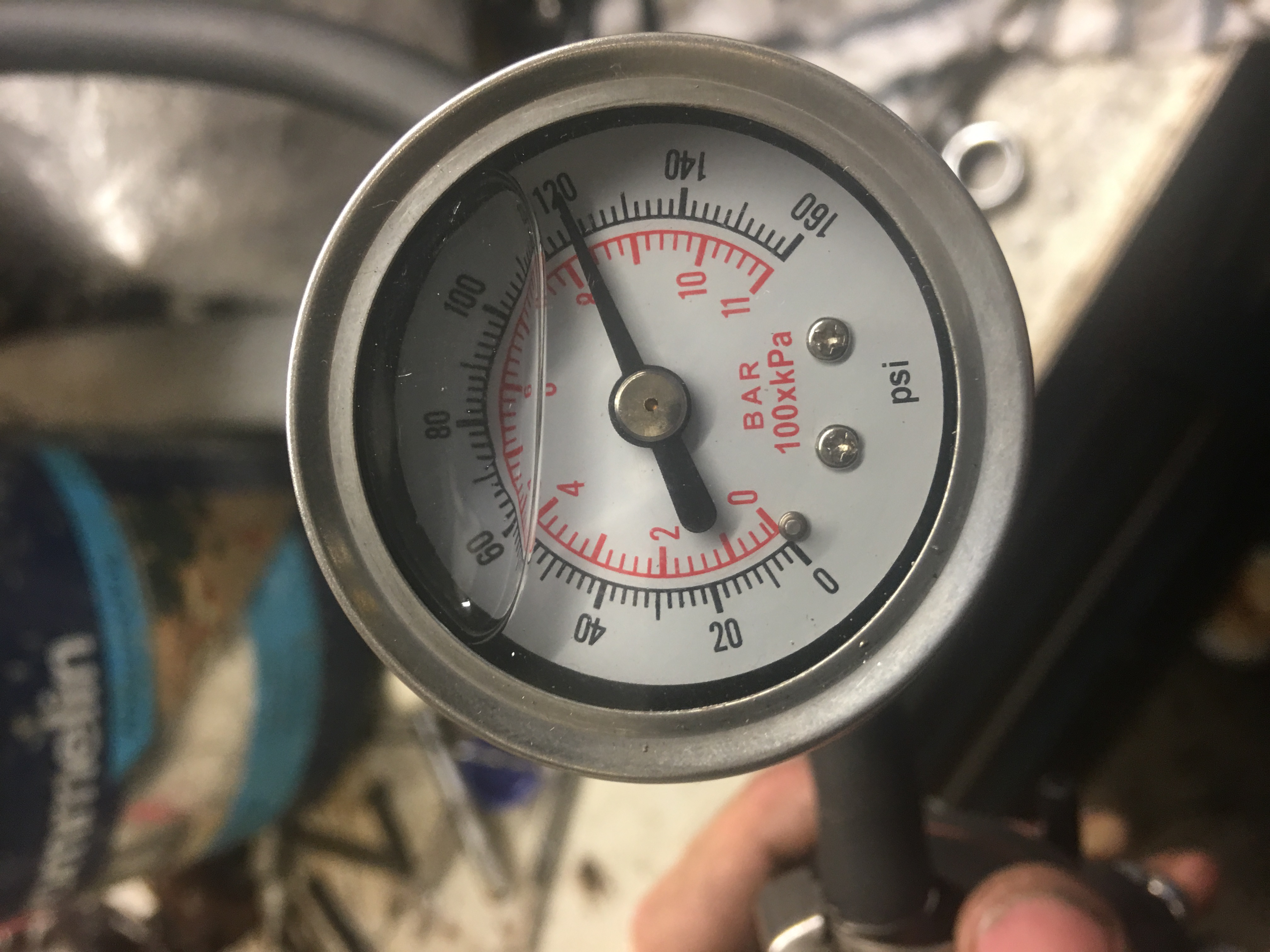

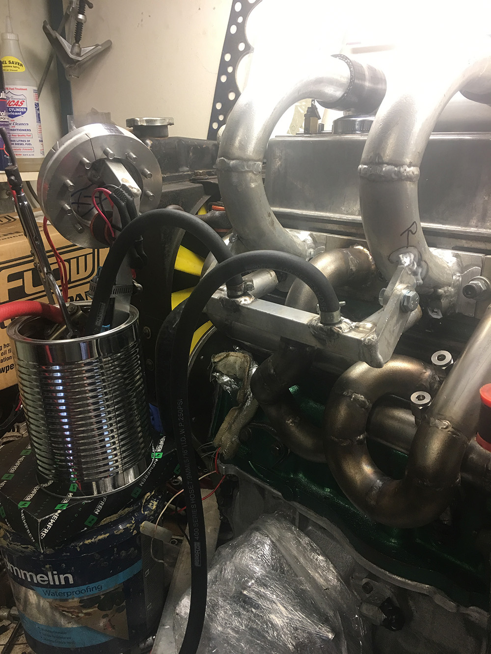

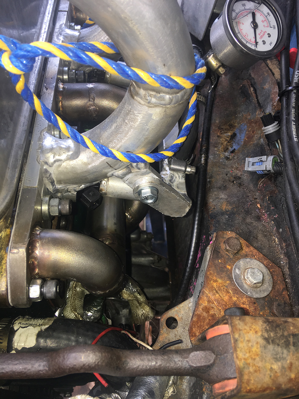

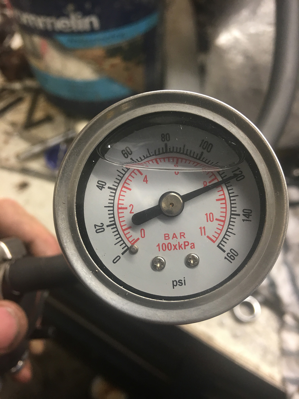

well it holds 120PSI and i didnt cop a shower

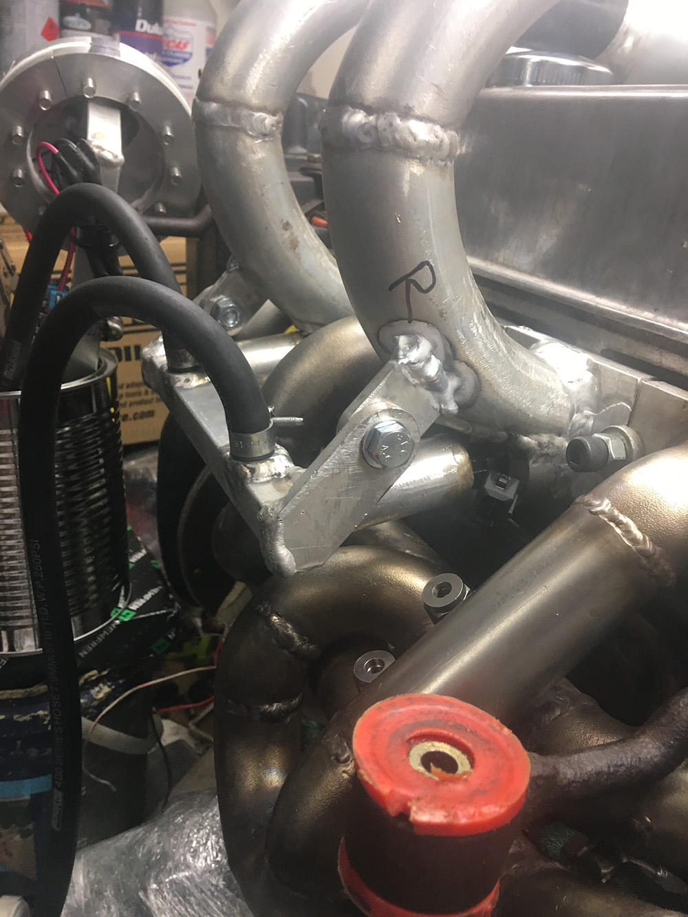

might drill a hole for a roll pin on each side so the rail cant twist
next thing on the list it the turbo drain

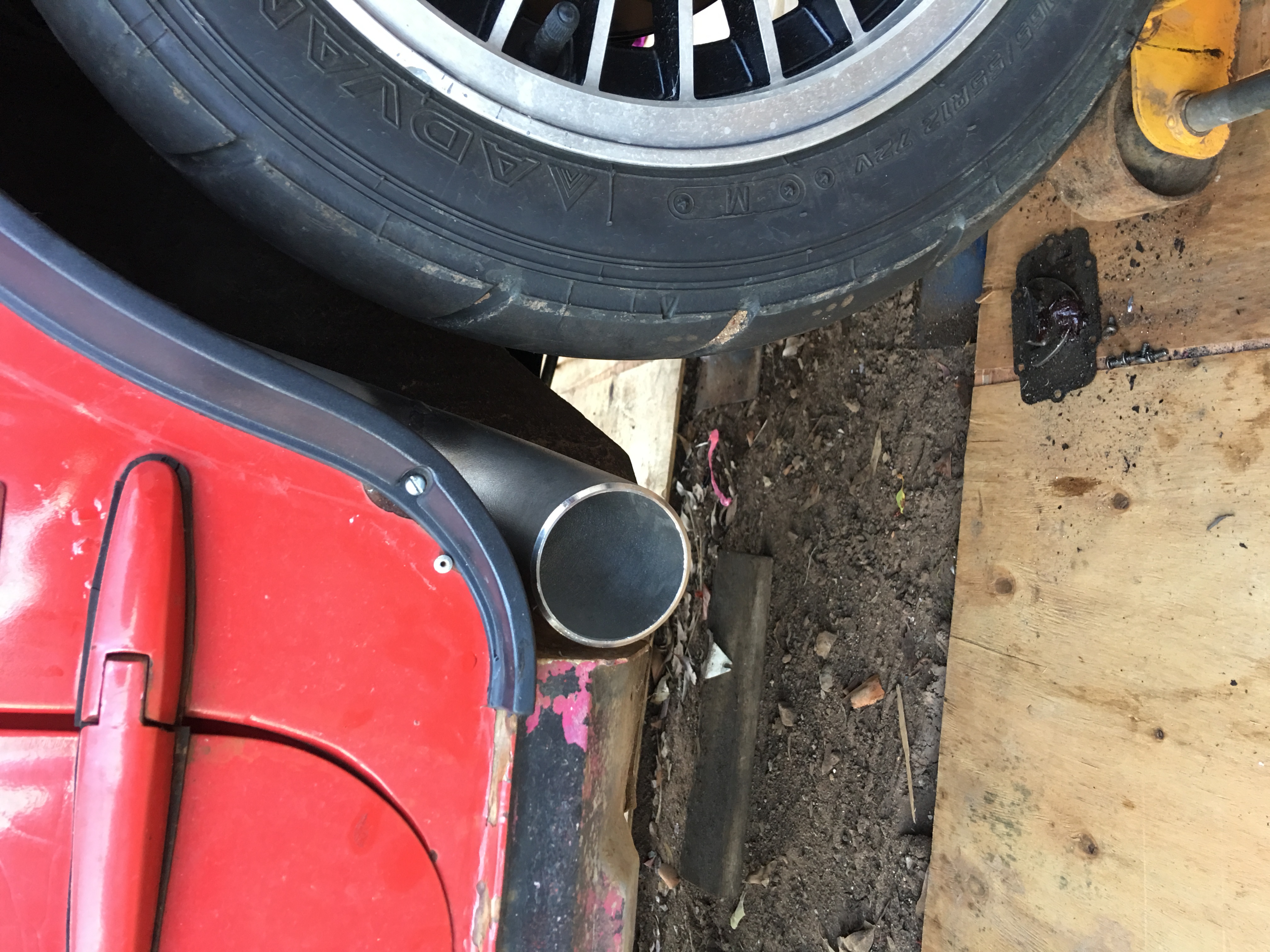

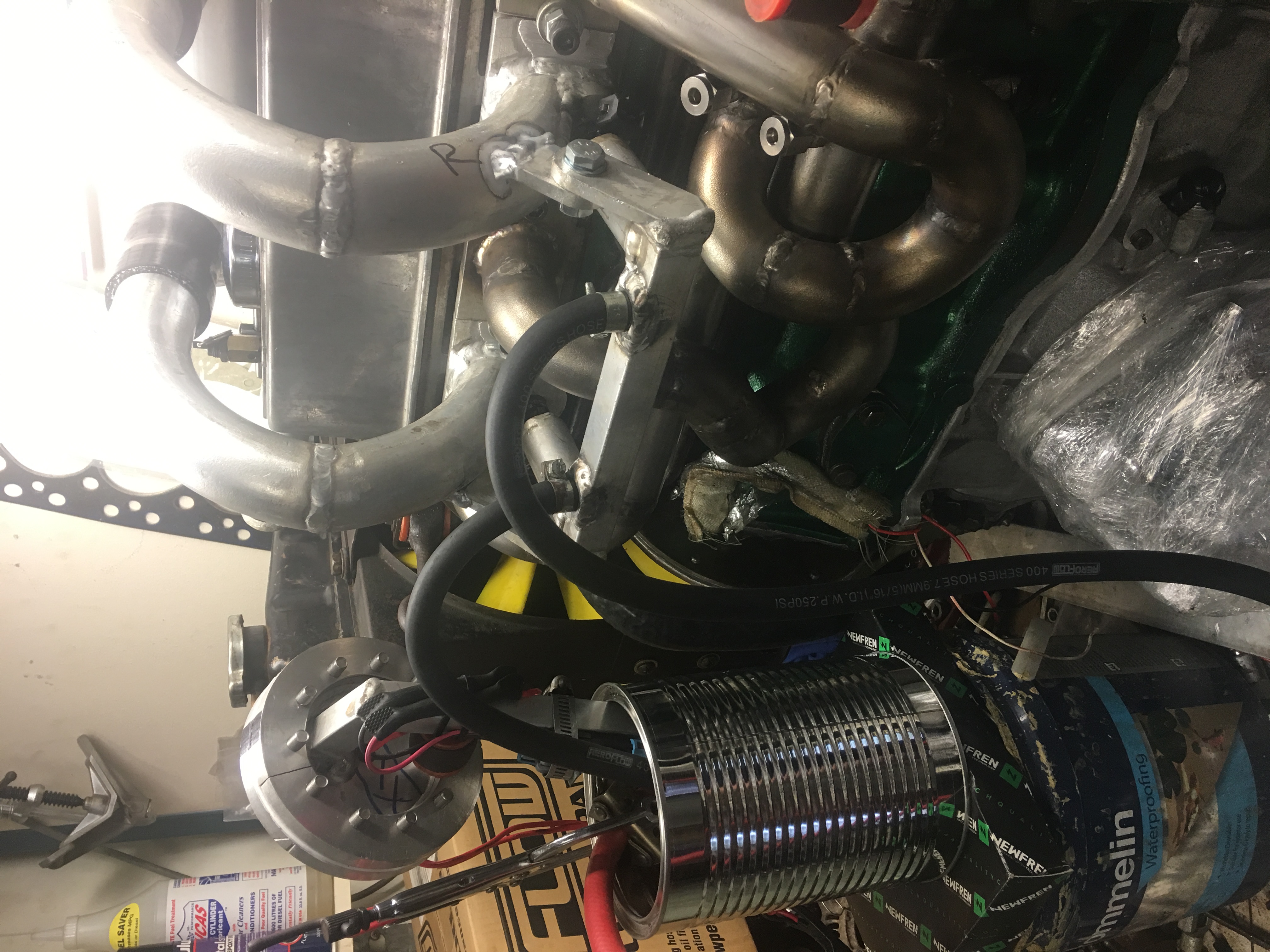

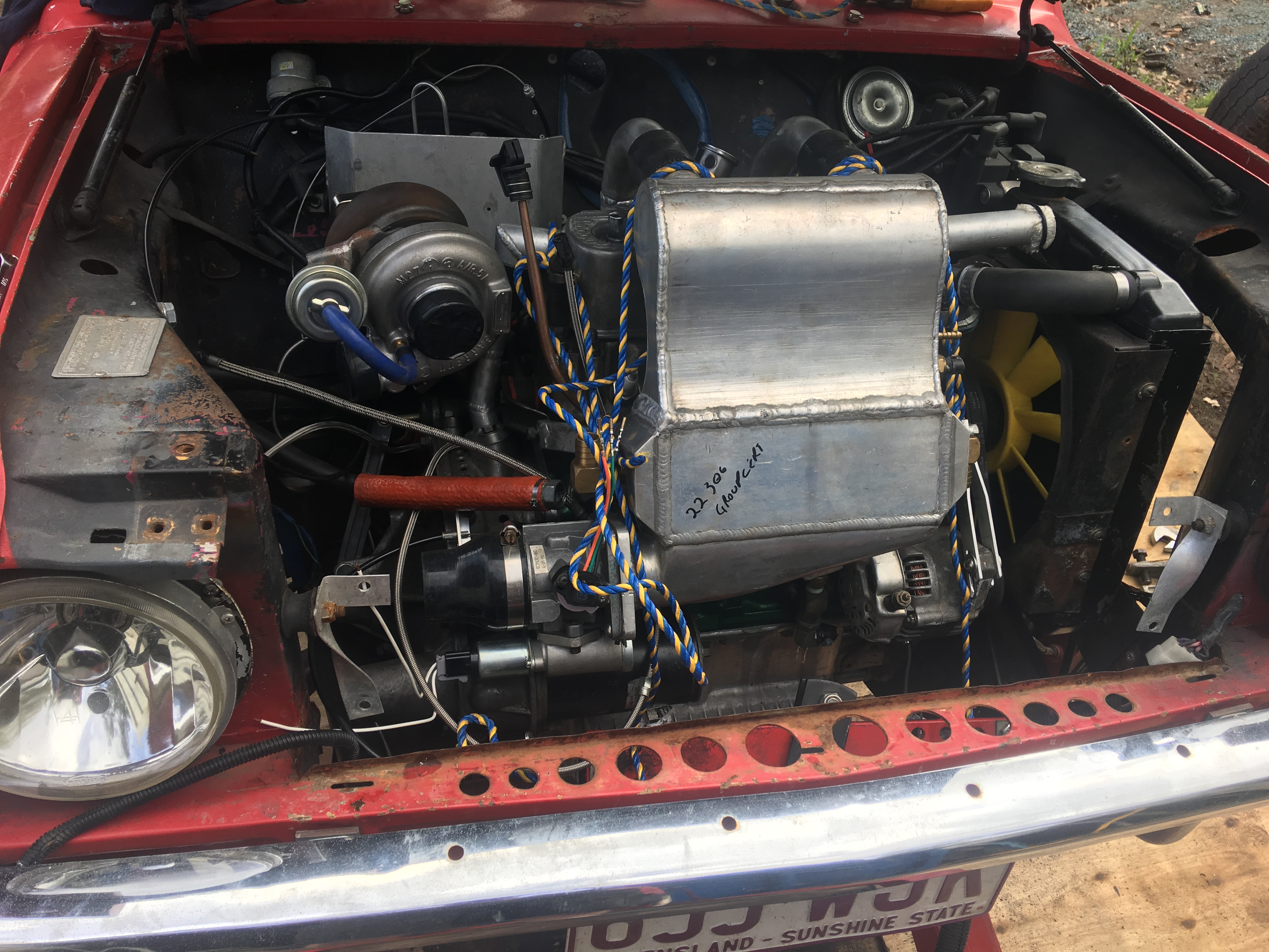

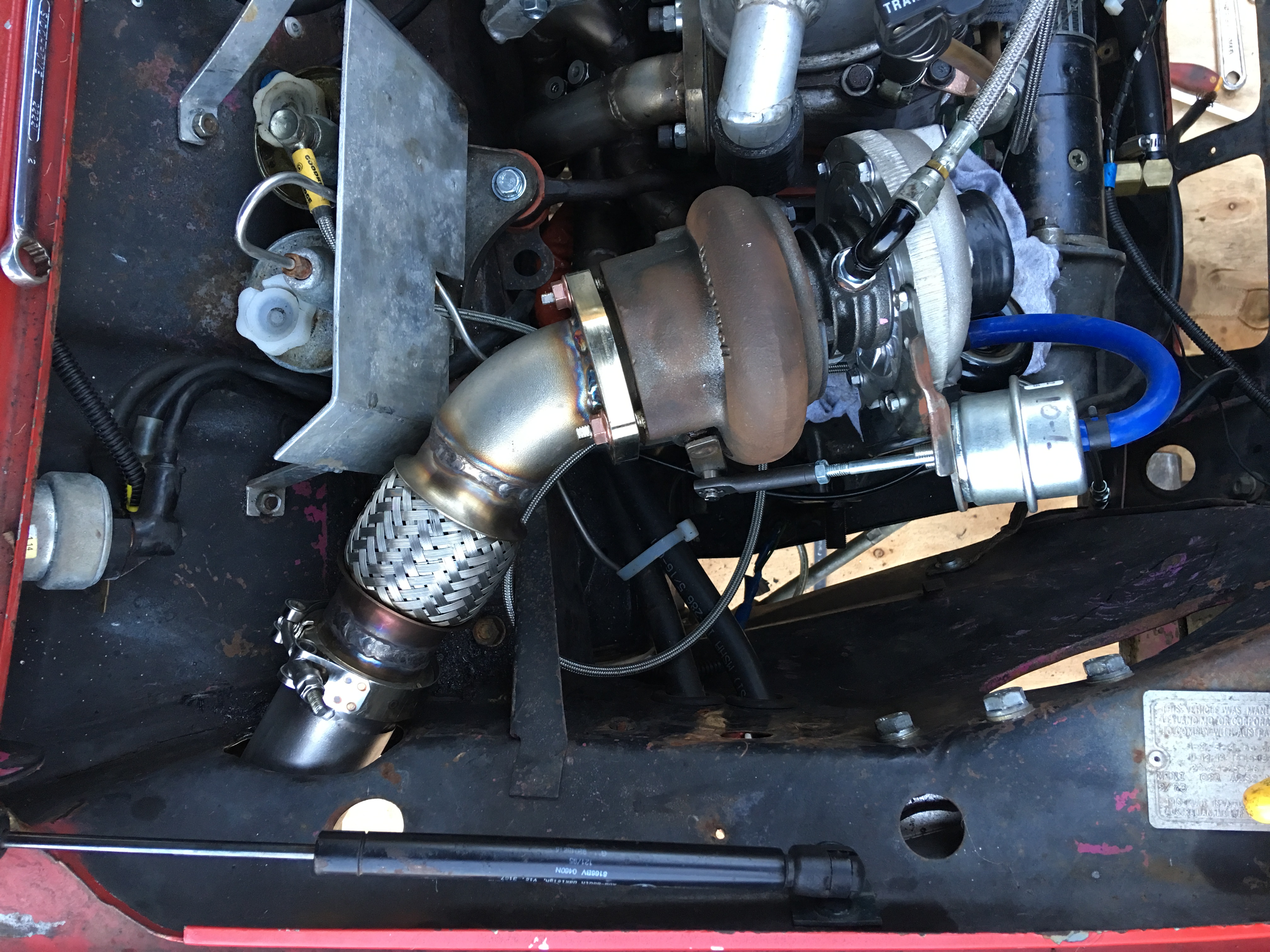

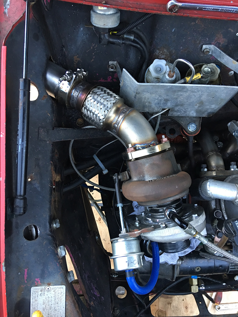

got the engine in this arvo
once it was sitting down on the mounts i looked at it and could see the intake was really high well above the wheel arch on each side
so promptly whacked the bonnet on and you would not believe it it bloody fit with 10-15mm air gap!!
haha i was convinced it was getting a scoop once i seen it in the bay
mind the stock look in not there as the bonnet is raised at the rea how ever i think it may be possible to lower it about half the current height
so few bits from the speed shop hose bits n fittings few bolts from the industrial suppler and time following wiring diagrams

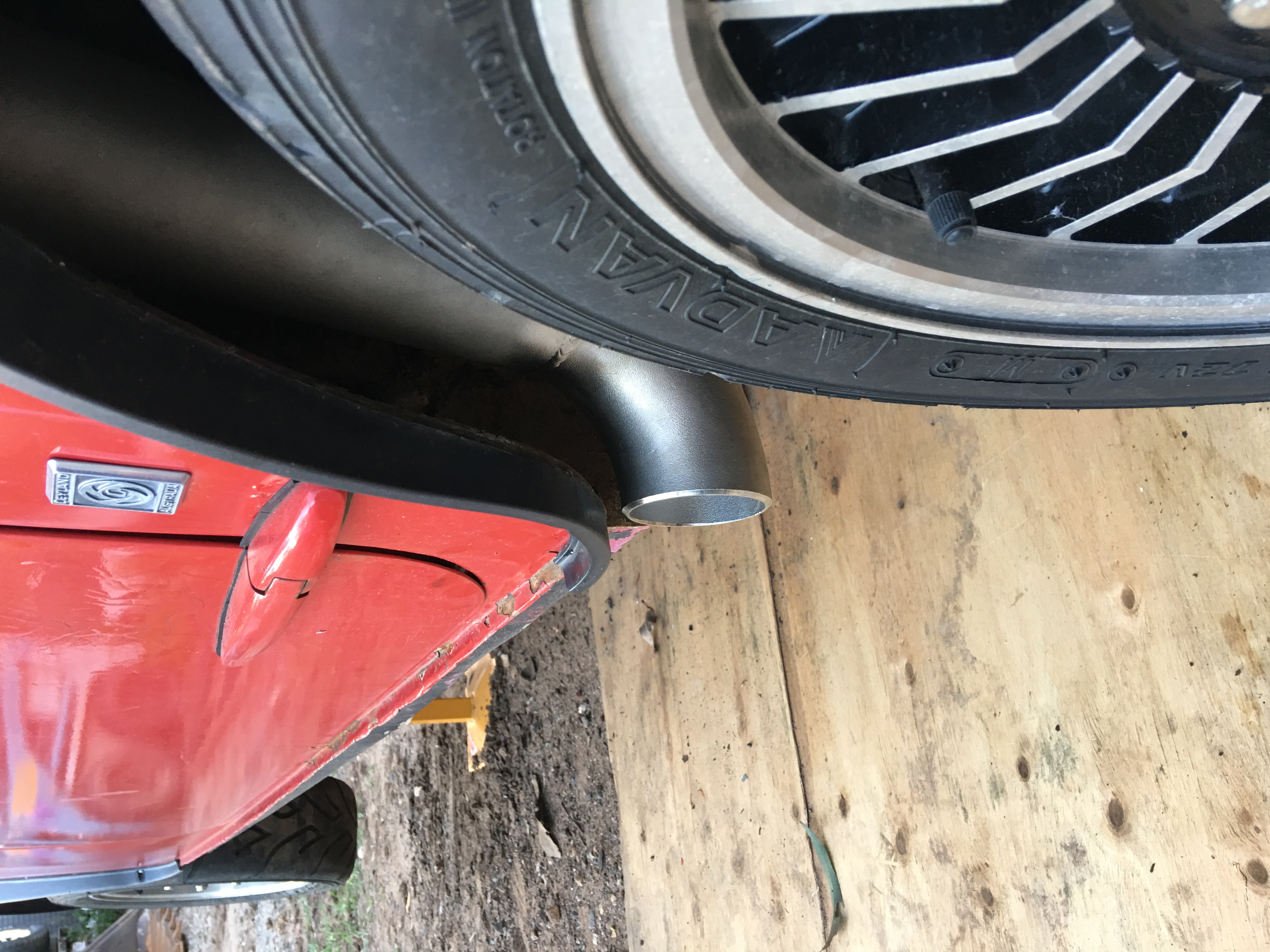

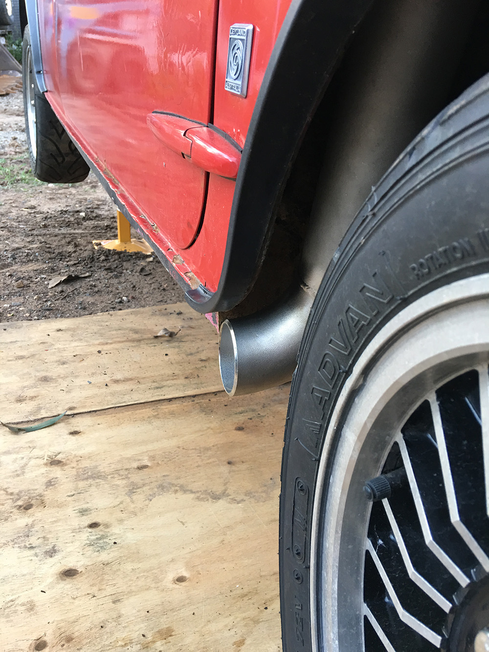

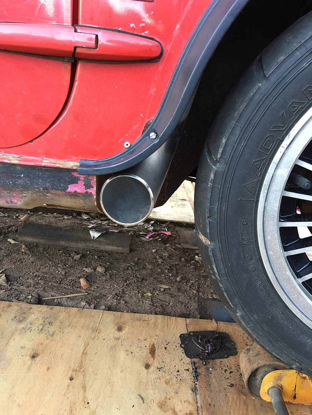

looks like the dump pipe will have to be ether out the bonnet or i take the long way out into the arch then down and out the side or continue under the car to run out the back i feel like its out the hood for now and then fuss with it later

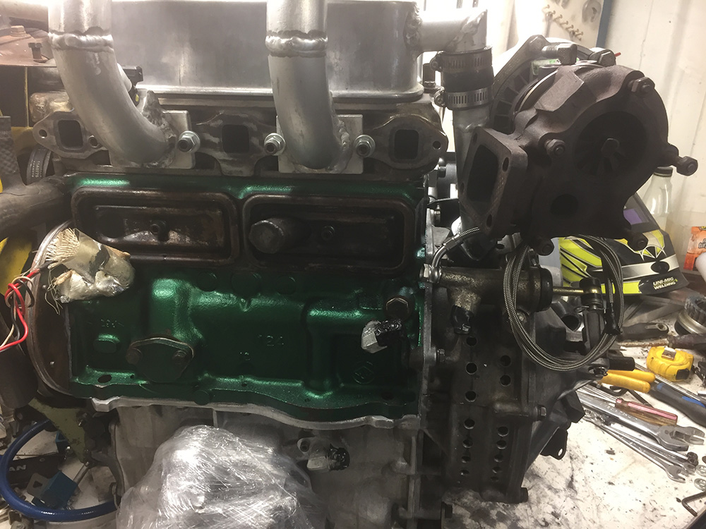

well im a goof think ive put the selectors arse over tit its stuck in neutral/reverse
not sure what else it could be ive disconnected the rod and the input will only go in and out not roll to the side so somethings missing or not stacket on the top hat correctly at a guess not sure what else could cause it

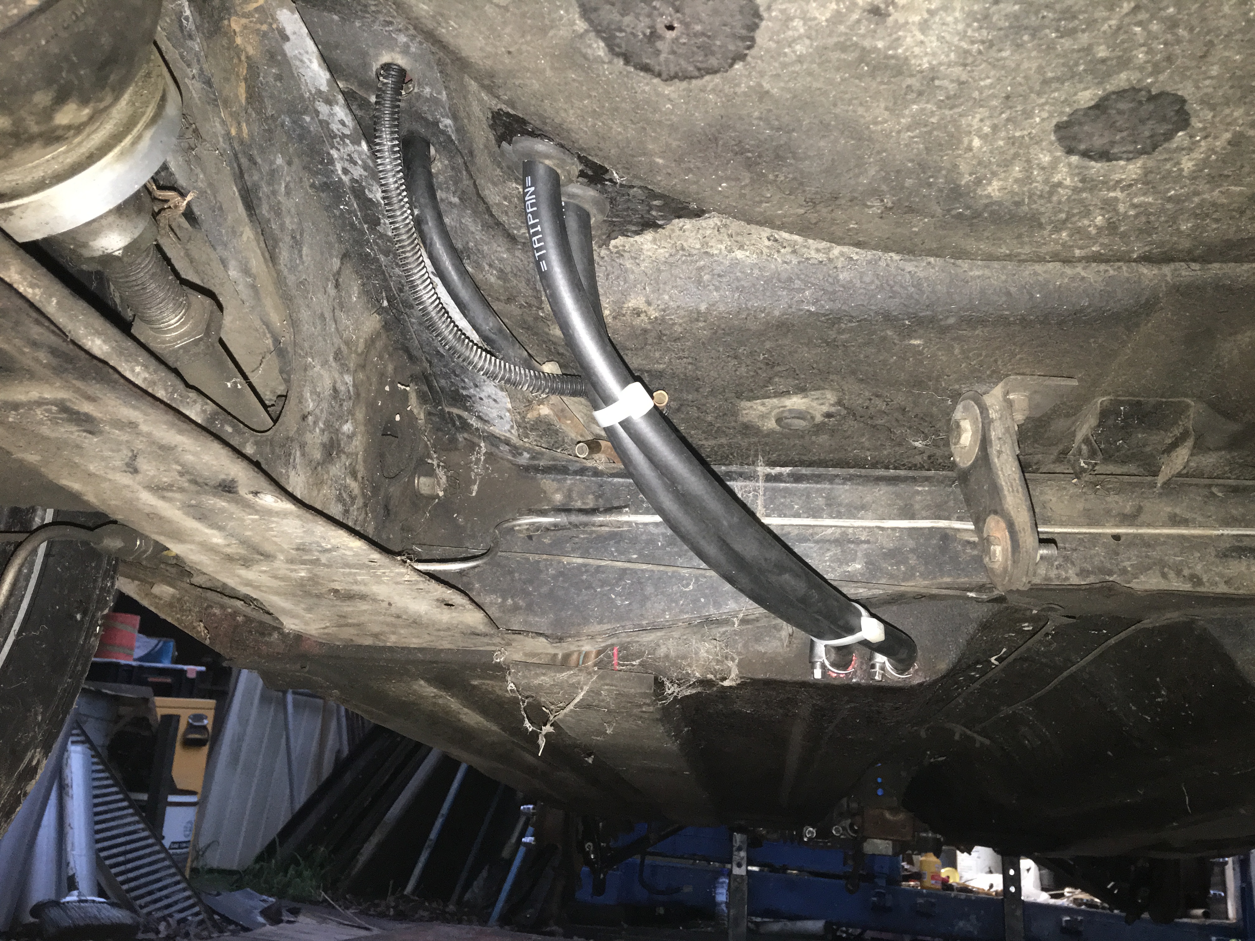

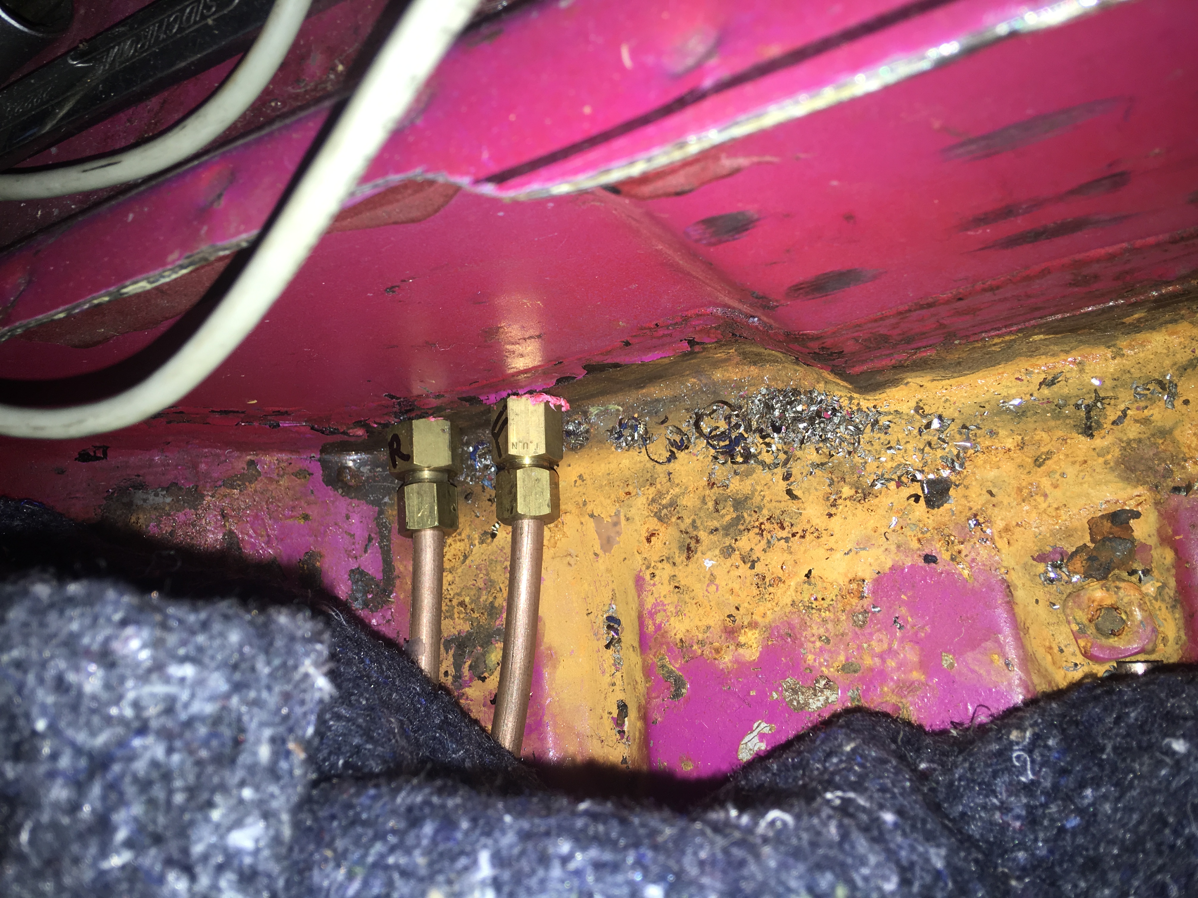

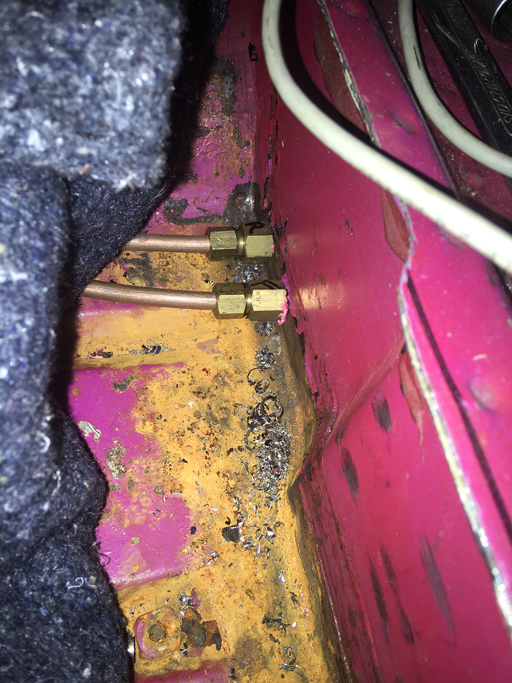

thinking ill get into the spaghetti tonight and over the w/e and hopefully give it start
run new hard lines inside the car old ones looked nasty
