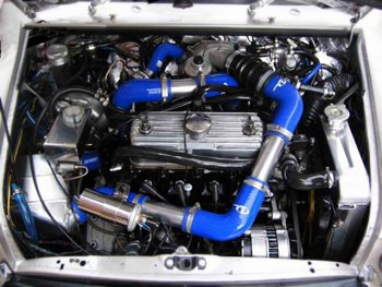

Just going to have one last attempt Re VE
Let's say we're talking about a 1380 then.
On another thread (can't find it just now)
someone queried my statement that when
the boost gauge shows "0" i.e. no vac, and no
boost, then 100% VE is reached
See pic below
So, whoever it was, with the gauge showing
as in the pic, what's the % VE then?
And what is it when, boost increases & the gauge needle
sits on 0 ?
So, with a blown 1380 and 100% VE
what output can you realistically expect?
Then, what output can you expect
by boosting to 15 psi gauge i.e. 1 bar?
If Alec Poole got 180 bhp in 1969
