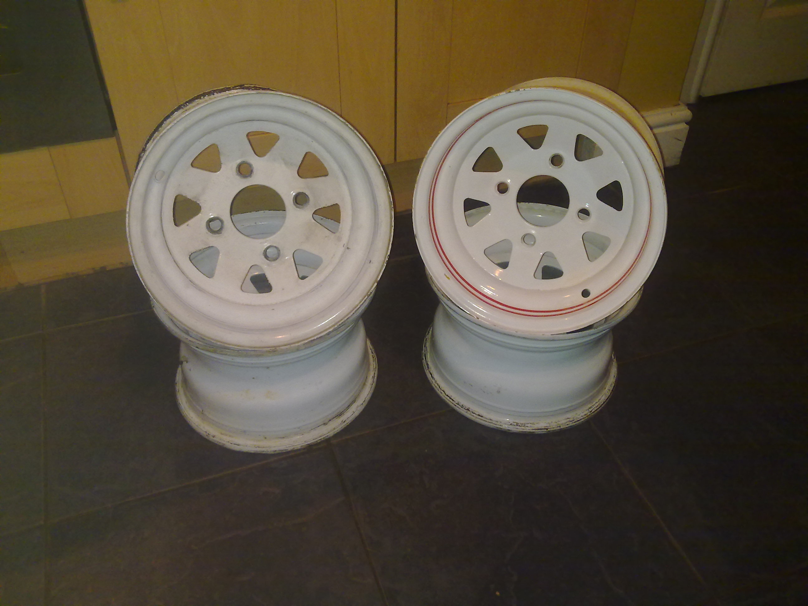

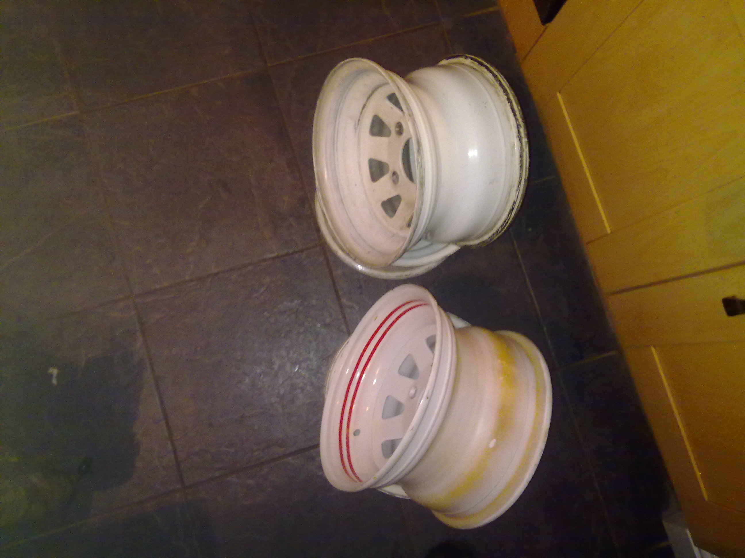

well here is the wheels, without going too much into detail with my colour scheme they are going to get painted*happy*

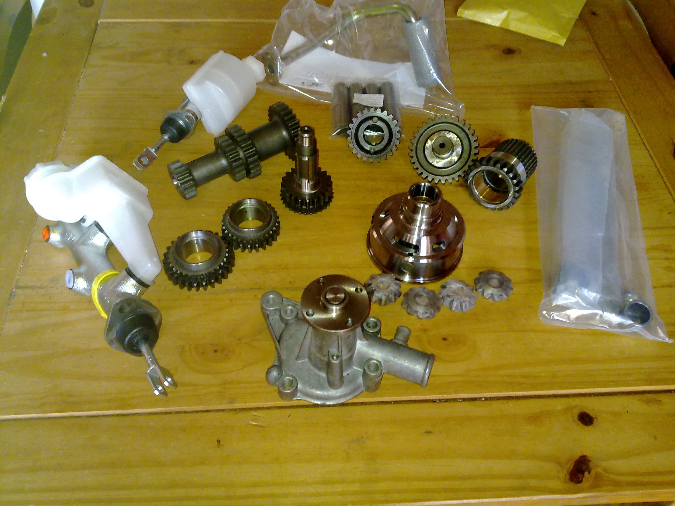

engine is out for machining atm gathering a parts list for a nice minispares order *wink*

got engine back, taken measurements and if off back for cam bearings, skim and a dip
just put a nice order in at minispares too *happy*

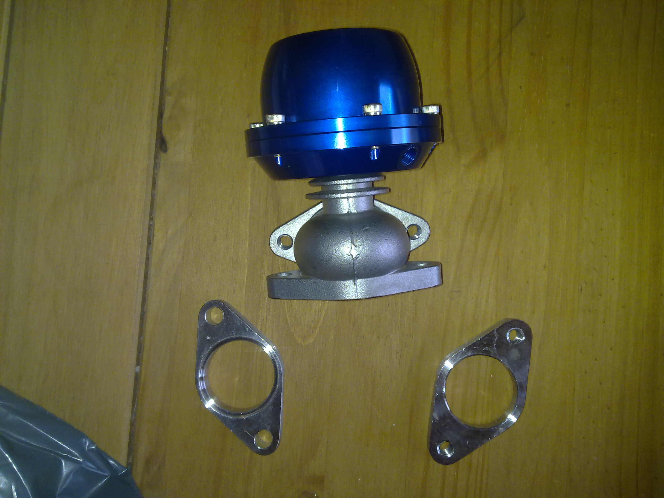

i bought an external wastegate too, no reason other than always wanting one, its fooking huge*oh well*

That wastegate sure looks like it will be difficult to fit. Are you still planning on using it? What manifold are you using?

it has mate, going to stick it in the bank later, i will be able to convert it over to tps at the weekend too, and ill post it as soon as cheque clears
it is alot bigger than i thought damn photos... its going in ay how im building a remote manifold as soon as my flanges arrive from Paul

what size wastegate did you buy?
its either 35mm or 38mm, but with the blue aluminium bit its almost as big as my t2 *blush*

i think they come in 38mm i was looking at them the other night as the tial ones are alot more expensive(however i think they are alittle smaller but not much)... i'l be watching to see how you get on as i like the idea of one too

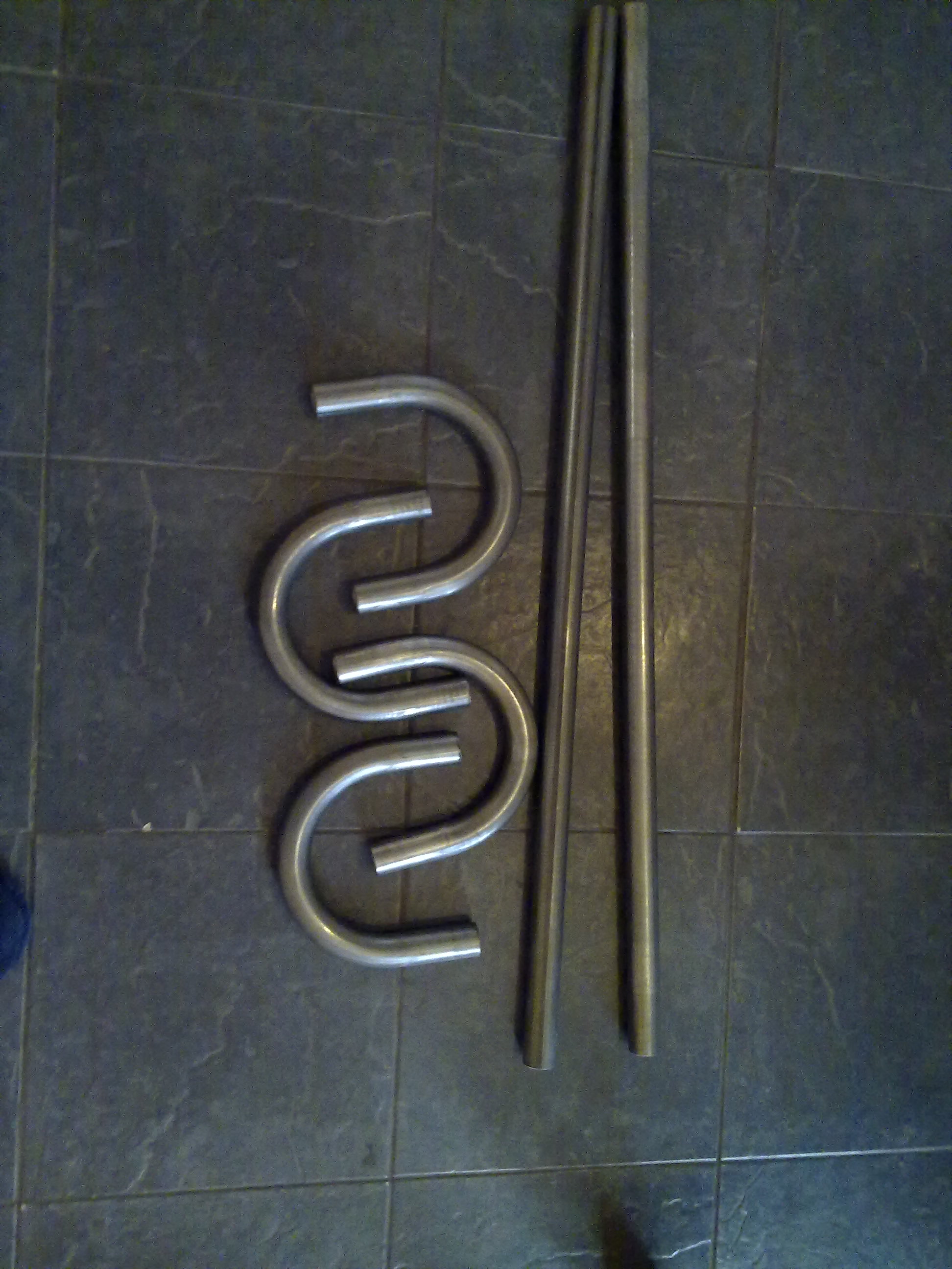

some tube and bends for the manifold 1.25 inch OD, 2mm wall

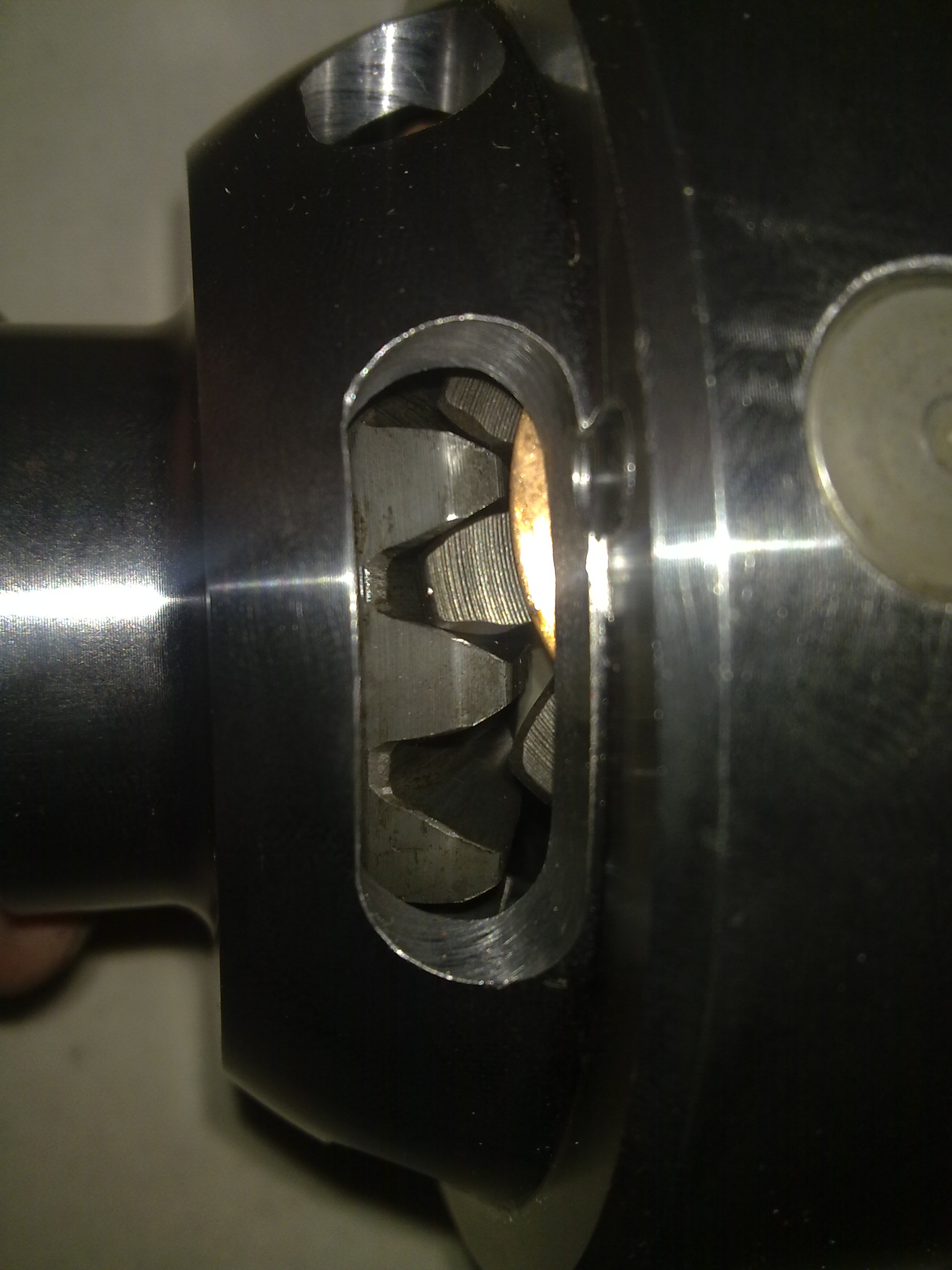

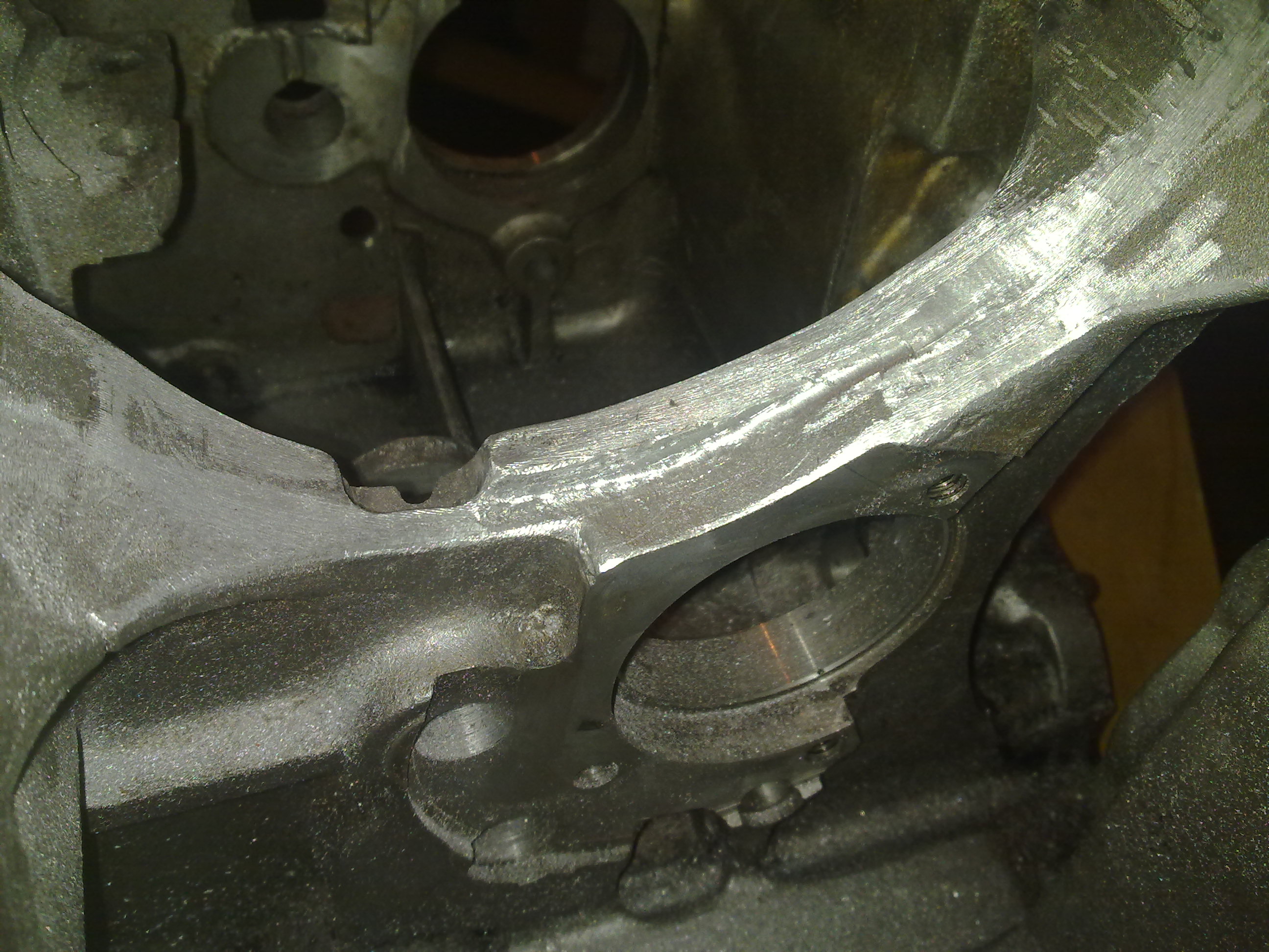

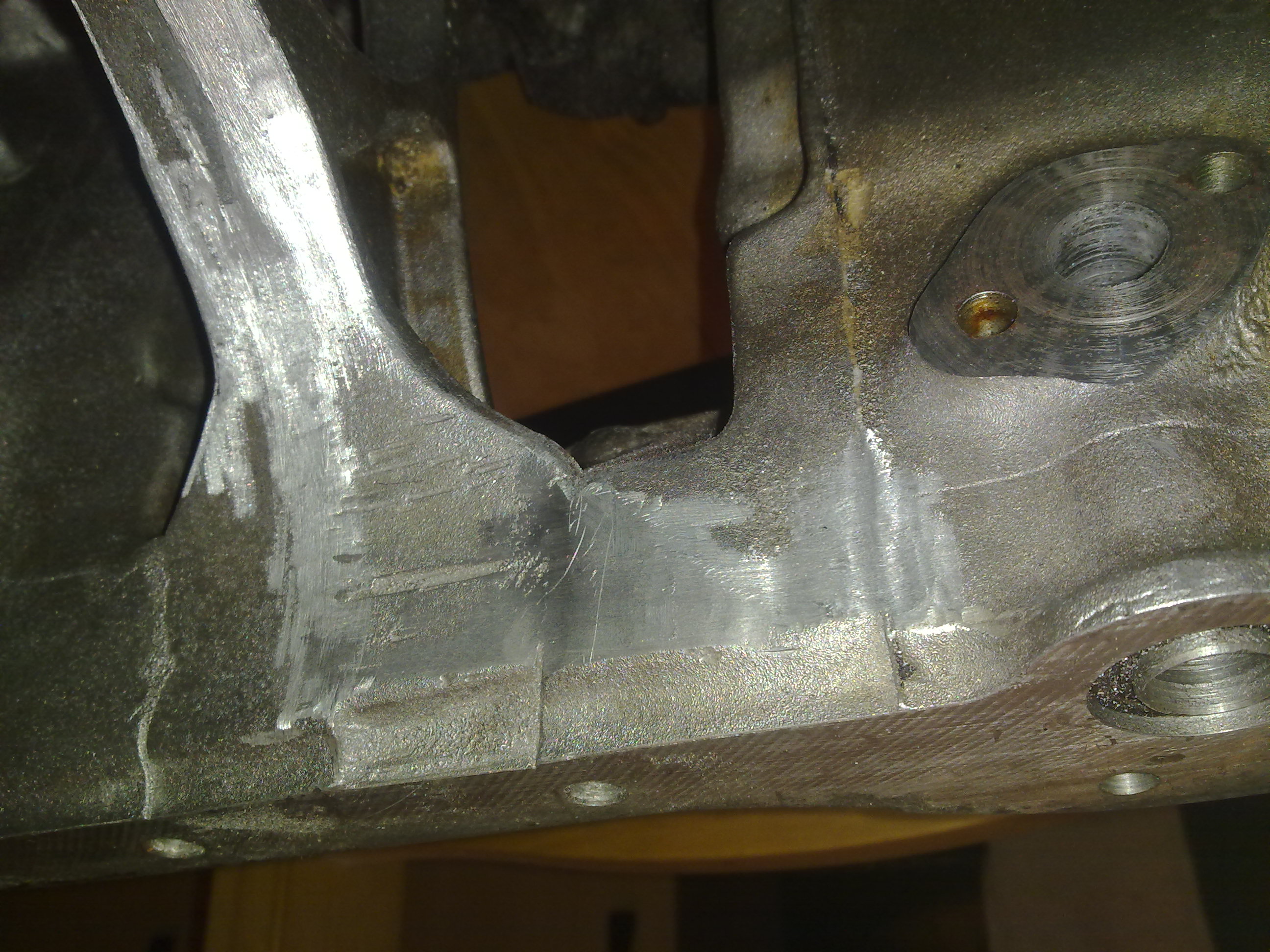

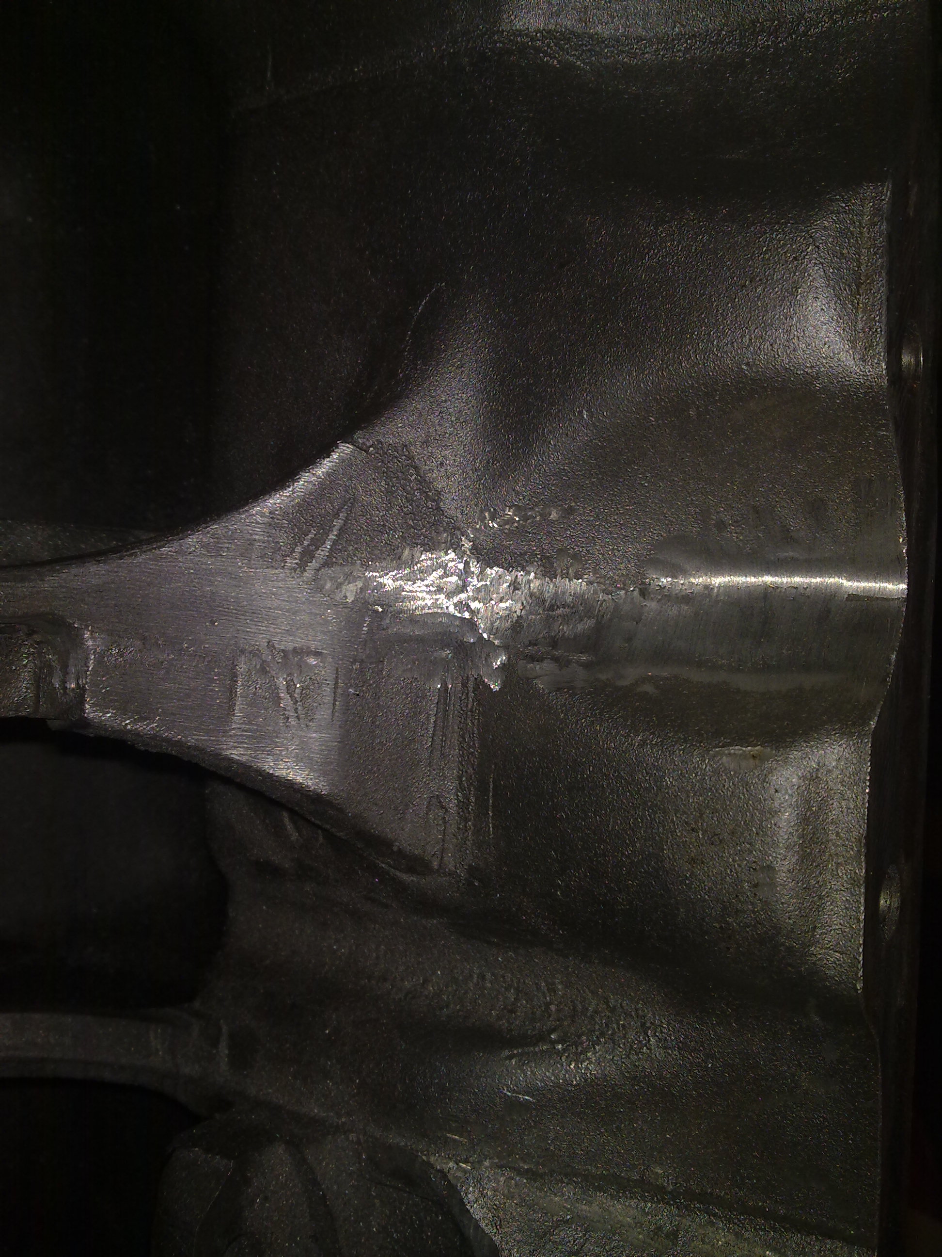

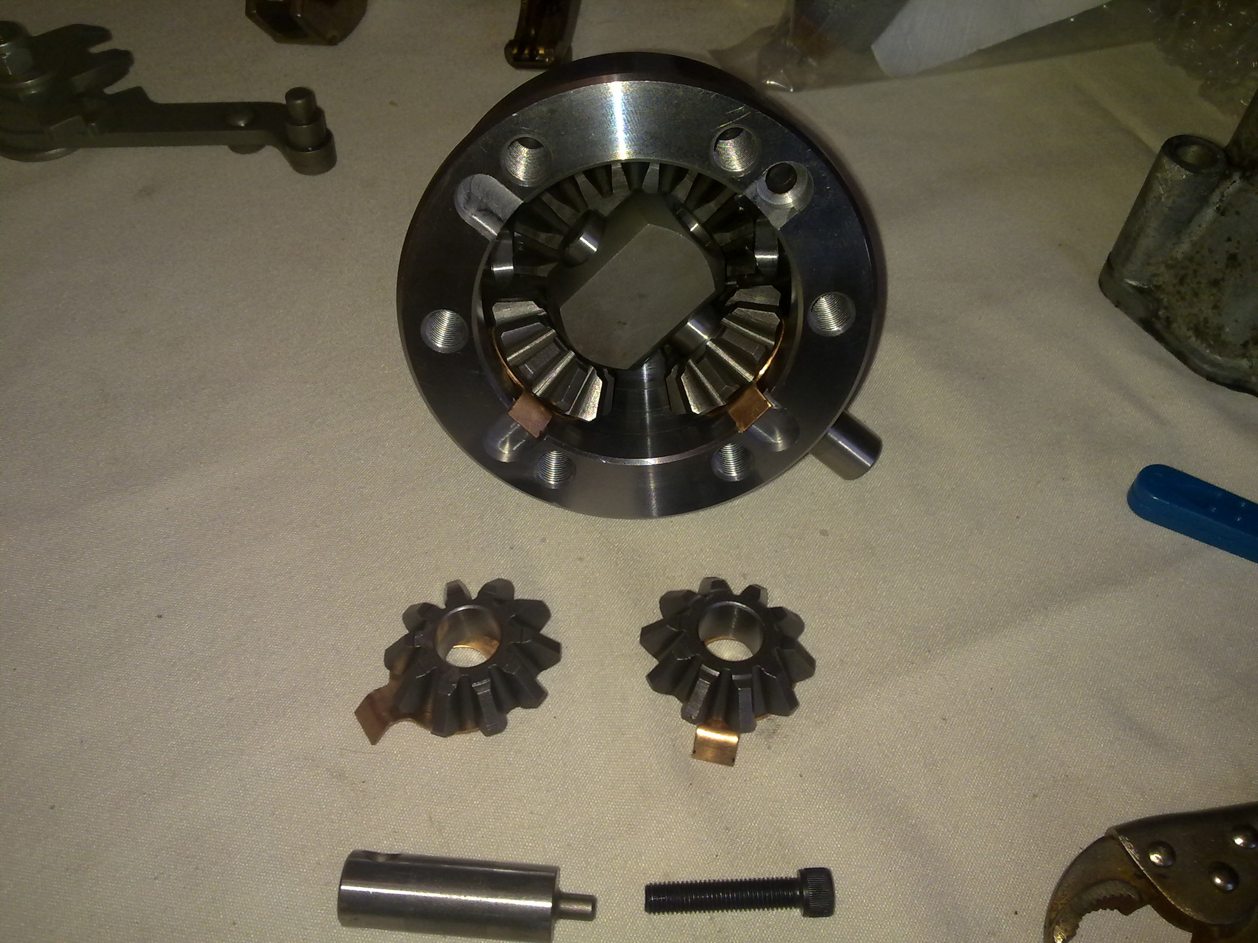

gearbox striped and had a good wash, just the main double roller needed replacing but i have most of them so they will all get done on rebuild, started grinding off the casting ridges and to polish the centre web, maybe not required at my power level, but as its apart might as well, my baffle tray from Paul wiginton is getting fitted too, whilst waiting for my box to dry, i built up the minispares 4pin diff, just need to get the cw in the vice up at my dads to torque the bolts up
