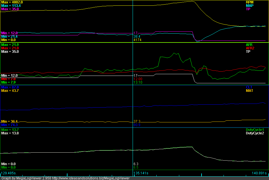

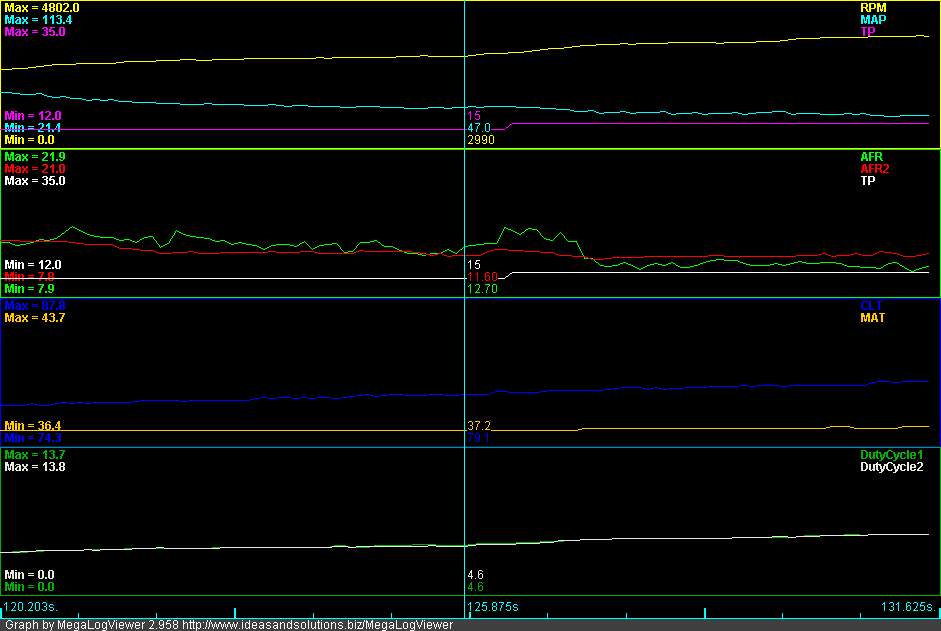

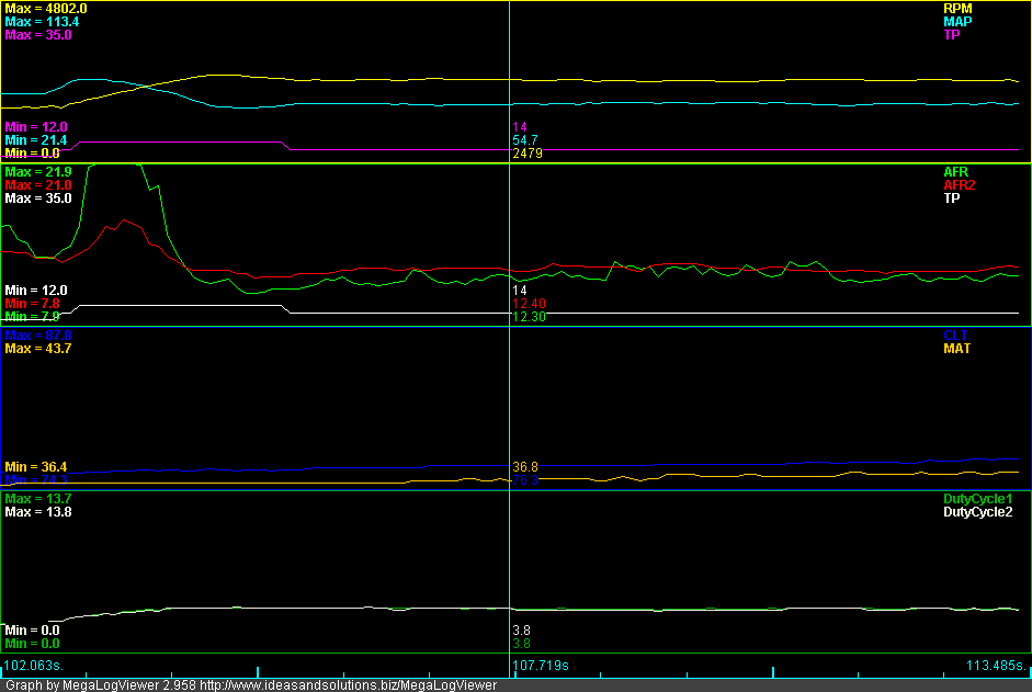

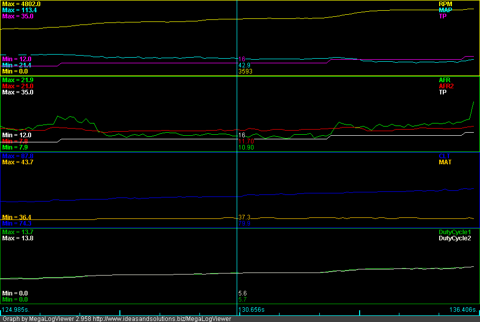

I have just finished building a new cam sensor using an optical switch inside the distr. I will still try the fuel pump lobe when I’ve got the right parts for it later on.
The afr signal of cyl 1_4 (green) is more unstable than the signal of cyl 2_3 (red) this is so throughout the entire RPM range. At low RPM i.e.<2000 cyl 1-4 goes lean now and then but I suppose that has to do with my crank. At this moment injection timing is set at 50 degrees fixed.
I have added a few plots at different RPM’s. Next I try and see what moving of the injction timing does before I start with the tables.
regards Will
Will,
You seem to have a good setting there for high MAP values.
I would expect a lower timing figure will improve the idle.
However, once you get under load and the fuel pulses double in length, you will need to set up the tables.
EDIT: Also, you do not want to take too much notice of readings below 85 Deg C coolant temperature as it has a dramatic affect on the mixture distribution.
Edited by Paul S on 31st Dec, 2009.
