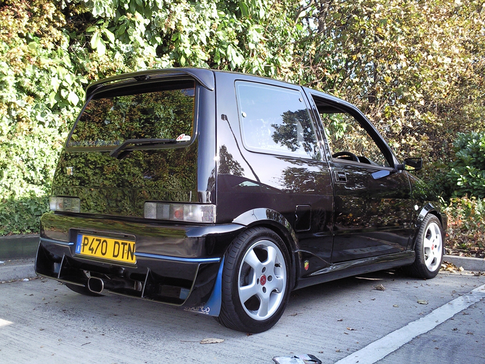

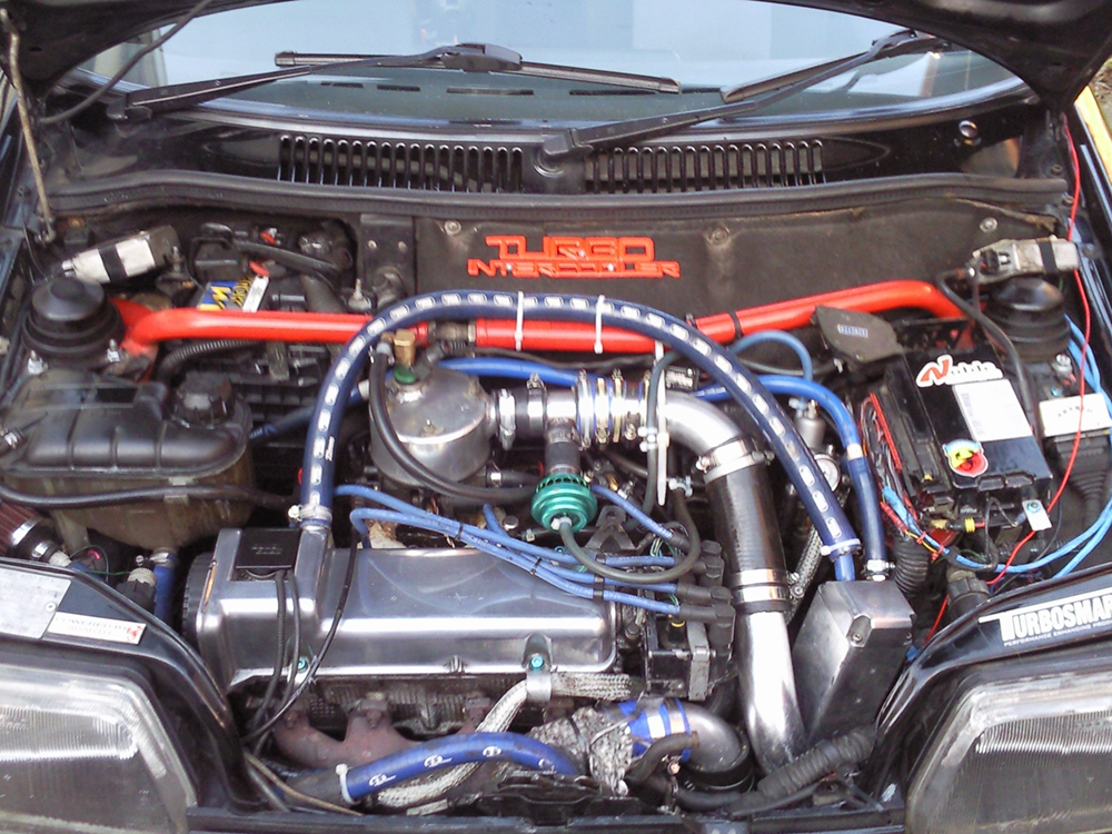

also ive been talking about this car a fair bit and you guys have been a great help so far! so thanks here are a few pics of the car we are talking about, its not a mini but i love it haha and its differnt -

Wow, that is a tight engine bay! I expected you would have a lot more room

mmm fiat did pack it in, changing the starters is a PITA lol

this is my problem, space,,,,,honestly its stupid how little there is, it took me months to get the intercooler fitted with the worlds worse route haha
Do you actually need the oil cooler?
a lot of us fund our oils not getting that hot, even with the turbo and the gearbox churning it up, and even if you do, its the easiest thing to find space for elsewhere.
