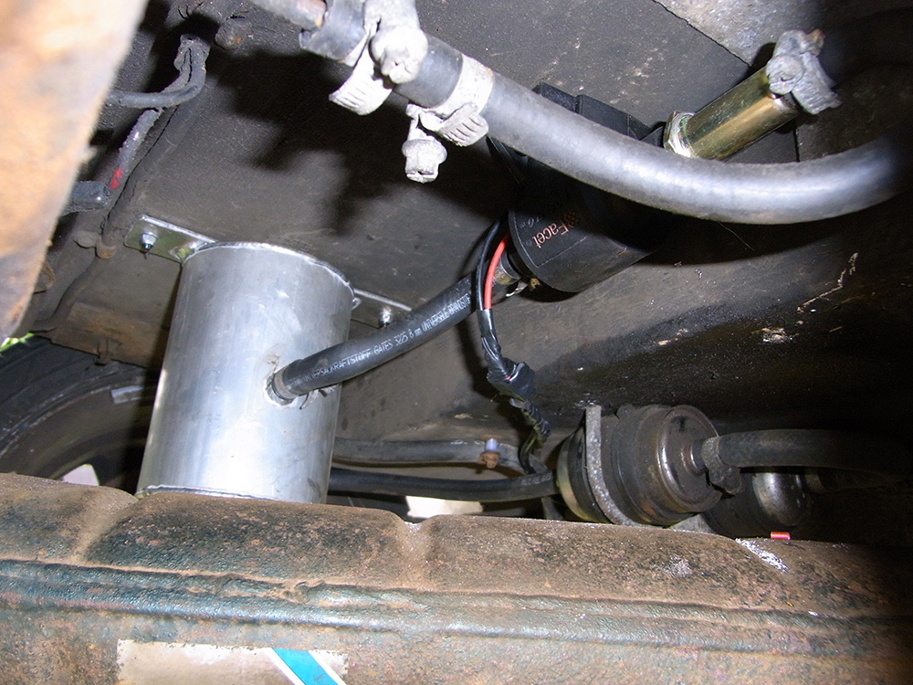

Nice blue pipes (a good use of an RC40 downpipe!)
Swirl pot added as it uses a van tank
