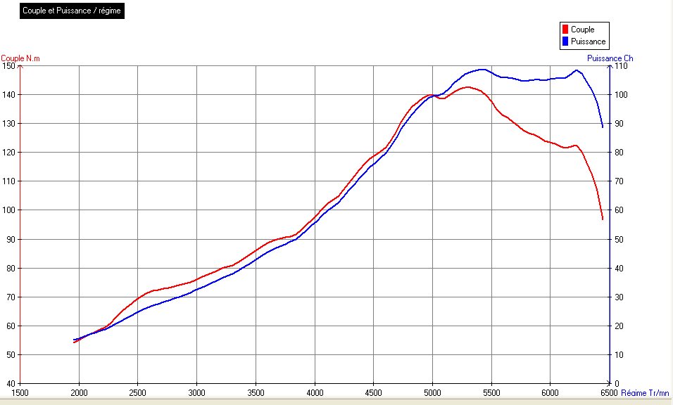

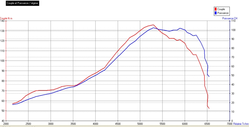

That was the dwell, too short. Now it makes 100hp @0.90bar and 5200 rpm. Assuming 15% transmission losses, which is low.

0.9 bar boost
blue is power
red is torque

Peak torque at 5200 !
Am I wrong thinking there is something odd when peak torque and peak power happen at the very same RPM ?
Do you regulate torque at lower rpm to save the gearbox life ?
If not, I tend to believe the cam is too big ...

The camshaft is timed properly, I did it on the bench and the chain (double) had 10000km.
The torque is reached at 4500 when measured in 3rd, but the peak is still at 5300. Also I'm using the MPi intake which is not really a MPi plenum to me even if runners are long and strait.
I think if I had a better designed exhaust I would get torque past 6000.
Unfortunately I can not find RR curves for turbo 998 or even 1300. Except the Paul's one, but he has some "secret" cam so who knows what's that.
Still the car is perfectly drivable in the traffic and you just don't imagine what you are driving until you go past 3500rpm.

For the camshaft I meant too big as in too much duration compromising low end torque when the turbo is not boosting
Maybe the throttle is not very hi flowing ?
What about a Metro intake drilled for the injectors ?
The lower the max torque, the better pulling engine so I don't understand why you are looking for high RPM, gearbox reliability ?
What about Vizard's book in the chapters about forced induction ?
As in pretty fast then scary fast or as in standard 998 then scary fast ?
If the last one, then it's definitely not the setup I am looking for ...
I will be running a GT15 off a 1.5 liter diesel and hope it to boost early and get the sort of torque you have à 5200 from 3000 on.
But I didn't crunch any numbers so I am probably day dreaming.
Last question, those 0.9 bar are on standart pistons ?
And what about your CR ? (could be dumb but I am in the quote window so can't check around if you already mentioned it)

I understand what you mean about cams. But 266 is definitely not a long duration cam, just a bit more than 256 which is a good street cam.
The intake flows enough because otherwise I'd have a boost drop. I just think the poor exhaust creates too much counter-pressure past 6000.
I'm looking for RPM because
Power = torque * RPM
So to save the transmission and have power it's better to go high. 7000rpm being the limit for standard bottom (that I have) I limited at 6500.
It's standard and then fast. With a smaller turbine it'd work better at bottom.
So pistons are standard and probably having 200,000 km.
CR : I don't know, it's a std g295 head with A+ flat pistons bottom. I know it's good for 1bar, I even did not try to get numbers.
I'm not really trying to push the stuff farther, it's my daily car even if I'll go at track days. I wanted 100hp, I got them. I'm sure with more time and less constraints of hiding things I could make better.
I did not check the yellow book, I'm not a fun. I'll see if I find something.
Edited by alpa on 23rd Jun, 2010.

I assume you have developed the power curve from a G measurement?
Was that power curve taken in 1st gear?
My 998T takes a while to spool up in 1st. It an inertia thing, I think. So it only gets full boost by around 5000rpm.
On the road, in second and third, full boost is around 4500 rpm.
But on the rolling road in top it made full boost at 4000rpm.
Your torque curve will depend very much on the rate at which the turbo can accelerate to give full boost.
alpa
520 Posts
Member #: 2093
Grenoble, France
Paul:
It's taken in 2nd, I never do that in first simply because it'd spin tyres. It's not an G acceleration, it's based on the recorded engine's RPM, weight and many other things, this software is very accurate (BTW it was developed on a Mini, it's quite known in France, PowerDyn).
In 3rd it reaches max boost at 4500 but in 3rd it's less precise as there is wind resistance, 6000 in 3rd is 140km/h.

PowerDyn is very easy to use. But you have to have a clean signal from the engine or ABS sensor. Low voltage ignition is the best source. I use an old version I bought years ago, I'm not aware about evolutions.
