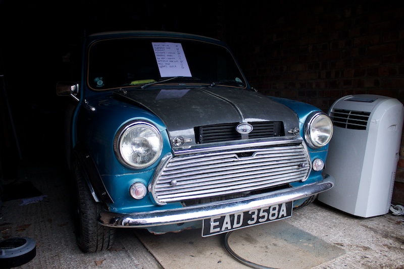

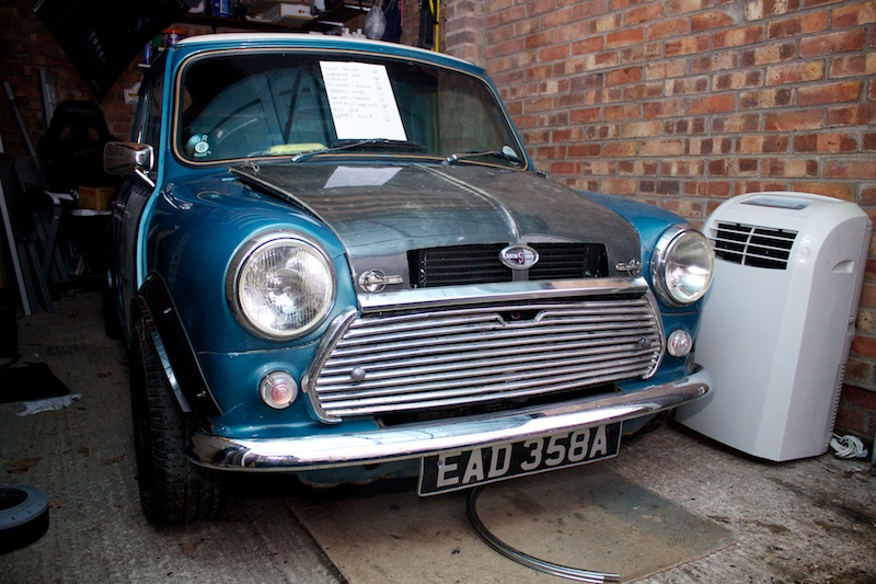

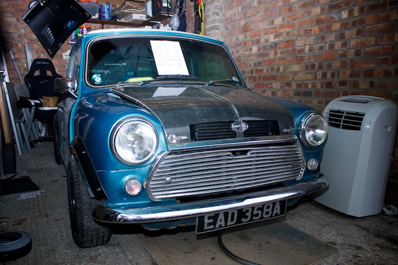

Finally got around to doing some work on the car again. We're moving house in just over a week, so I really need to get it roadworthy so I can drive it to the new place.
So, Today I have done:
Fit subframe / inner wing brace.
Fit headlight and re-do the lighting wiring.
Fit the front arch.
Fit a few missing clips to the boost hosing.
Painted the rusty bit on the grille.
It's raining, so I don't want to move the car outside the garage, but I still need to a few jobs outside, so hopefully I can do those later this week when it stops.
Here's a few pics

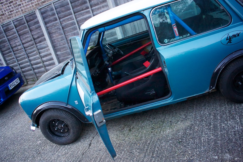

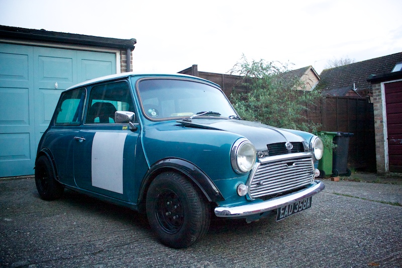

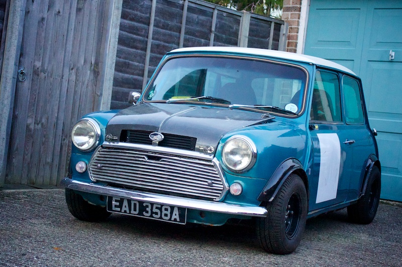

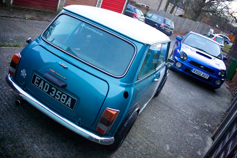

Bit more work today.
Fitted the cage (forgot how shit it is, so I've added buying a proper one on to my wishlist!). Fitted the 2nd seat. I fixed the exhaust (broken mount and missing clamp) and did a few other bits. I also realised that the door handles now foul on the cage, so I'm going to have to flip them 180.
Not much left before the MOT now.
Anyway, a few pics:
Interior (note the 'I have been sat around too long' rusty floors)
And a proper view of the wing I painted.
