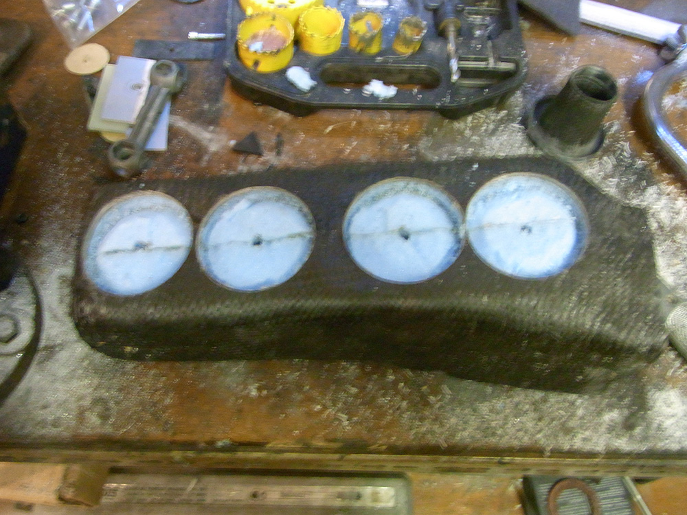

What did you use to make the mould for your plenum? Looks good
If only I knew. It's a high density foam. It was left over from a plenum my mate made that he gave me. It's lots of bits stuck together.

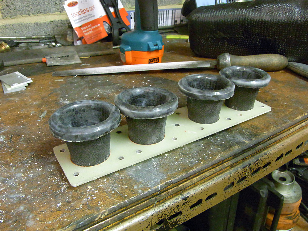

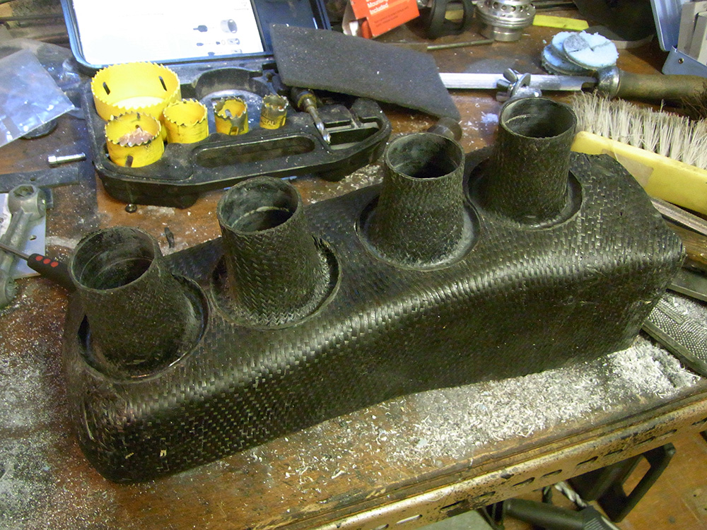

Well the plenum is neary finished
I have now stuck the trumpets on, just no photo. Just the flange to do now.

I keep meaning to have a go at making a few carbon bits,how difficult did you find it?
Well this is the first time I have had a go and I got better as I went along, I also had an expert mentor.
I'm generally happy with the result, but as always I could do better next time.
I think the basics techniques are easier than welding, but knowledge of materials was the tricky thing. Now I know what I know I could build a CF house! (maybe)

Is the air box 2 piece? If not, how did you get the foam mould out?
Always wanted to try my hand at CF moulding
you melt it with celulose thiners.
It is most likely the same high density foam art/design/model makers use - my son used lots of it when he did his HND in graphic design and I have a large box of offcuts left behind in his old bedroom. He got his from a specialist art/design outlet in Norwich. He only used it with GF, not CF but the principle is the same.
I kept the box of offcuts as I too was thinking about doing it this way after the time it took fabricating a plenum/inlet in aluminium by machining and welding.
You've certainly made it look easy Wil :)
Was your mentor they guy on here a while ago who made one for an injected Imp ??? (it was the pictures of his that first made me think about it).
Yes Eric with the Clan (Imp engined)
