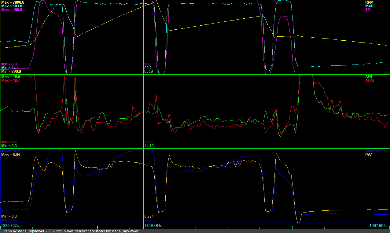

After having analysed the data of my first run I made a few changes and took the car for a second run ( it looks a little bit better than the first). I have attached my MSQ file and the datalog of this run. It is setup for speed density and single table injection timing, hybrid mode is disabled. Although the log shows a lot of room for improvement the engine runs ok it’s quit responsive on the throttle especially when low on the throttle. It is hard to get it to idle correctly I will first try to get the optimum with speed density before I switch to alpha-N which might be the better choice for my cam. I will try to analyse this run and see if I can get it better ( I am new to this compared to almost all of you so I can use all the help I can get).
Your log looks pretty good as it is. It's probably not worth getting too hung up on getting the AFRs exactly equal, but if you want to improve it then have a look at this:

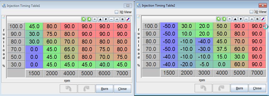

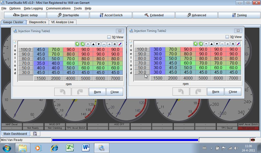

Your Excel spreadsheet is very useful It shows exactly where the problem area’s are from a injection timing point of view. It shows in my last log that timing is off between 3000 and 4000 rpm and a map between 85 and 55. also very interesting to see is the area at a map signal of 60 to 65 there it goes from rich on the inners to rich on the outers over arev range from 3000 to 5000 rpm. The run was made with the attached timing tables. Pdf of results also attached red is running rich on the inners and blue is rich on the outers. To be continued

What is your injection strategy then Will?
Two injector timing tables and a single VE table?
Graham T has used this method with success, detailed in this thread:
http://www.turbominis.co.uk/forums/index.p...tid=350549&fr=0
Personally I prefer the hybrid mode. We did some tuning of the MS3 yesterday. Just set the VE Analyse Live running and concentrate on a single timing table.

At this moment my injection strategy is single timing table and single ve table. I thought it was sensible to keep things "simple" to start and try to optimize with that as far as possible before going to dual timing and or ve trim tables. After having optimised this (as far as possible) I have planned to test hybrid mode to see if that gives better results.
I am slowly getting better results with the current settings at this moment the engine idles ok at 1500rpm but I'am experiencing the following. When I have idle to drop to about 800 rpm I get equal AFR's with a lumpy idle then when increasing to around 1500 the outers are going lean ( I can not fix this with single timing no matter what I try) then when going to fast idle (2000 rpm) I am getting equal AFR's again.
Next thing I am going to try is using the VE trim tables to see if that brings any improvement. On the other hand I think it might also just be the effect of reverse flow of the inners wich causes the outers to suffer 1500rpm is the point where the engine starts to get 'on cam' then at very low RPM (800 and lower) it is that much ‘of cam’ that both inners and outers are perhaps suffering equally. I will read thru the tread you mentioned.

I took a good look at the strategy that GrahamT used (timing the injection pulse of the inners in such a way that some of the pulse enters the outers to get equal afr’s).
I started with getting things right at idle and then moved to the full throttle area and it did not take long to get reasonable results see graph where I go thru the gears at full throttle. (you can see where the pulses merge and the all goes lean around 6000rpm.) After this I started to work on the tables in the part throttle region with my girlfriend driving the car. My experience is that the quickest way is to use Pauls tool to find the problem area’s and then make adjustments while driving the car in that area. I have the timing tables attached which gave the best results up to now. When examining the numbers and doing some math at 4000rpm I realised that the timing values I used with the single table were far from correct. 4000rpm and injection time of +25 and a pulse width of 3,7msec saw already some of the pulse of the inners going into the outers this means I will have to inject much earlier.
