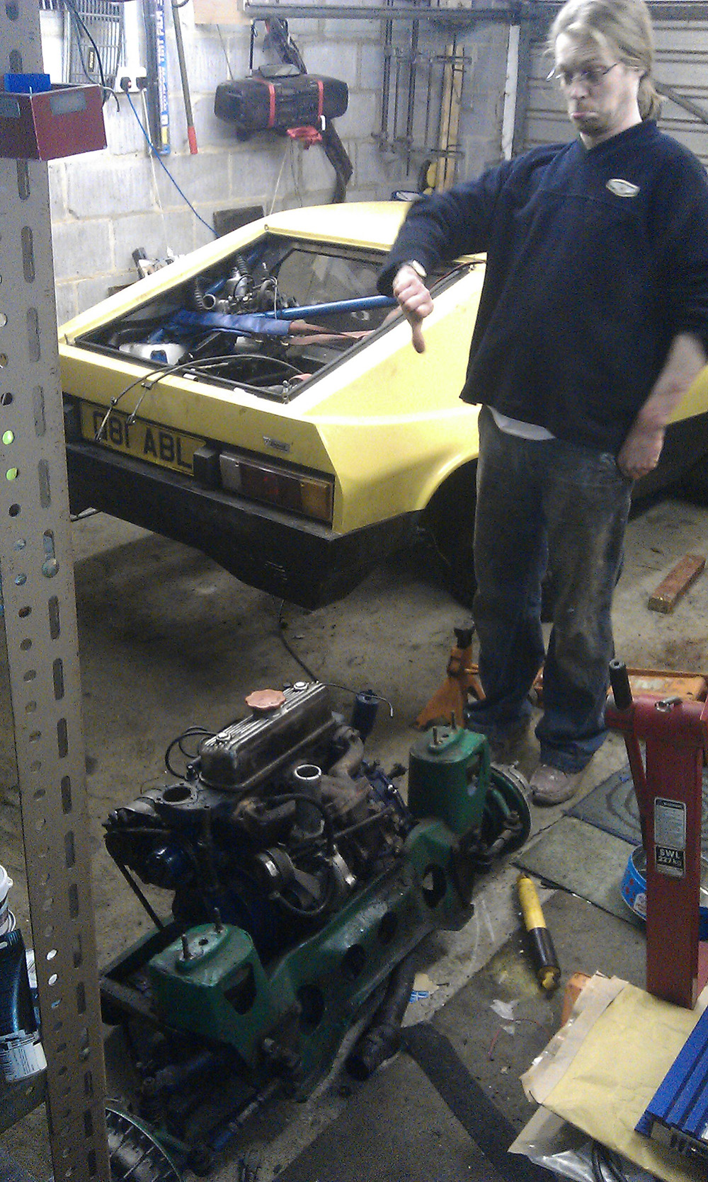

I was driving with spirit down a country road when I went over a bump. The gear selector wahcked on the floor and broke some part of the internal gearbox gubbins in the box. Engine out to get it fixed.
Problem is stopping it happening again. Plan is:
1) modify the selector to raise it
2) add bumpstops as none are fitted
3) ad sacrificial skids to protect the selector.
There is no chance of fitting a sump guard, it's too low already.

oops. I've got a spare frame thingy for the gearbox end if you want it to modify.

This is the bit that has bust
http://www.minispares.com/product/Classic/...k%20to%20search
Anyone got one knocking around they'd like to donate? MS price is a bit steep.

I've got a good few chucking round.
4310 Posts
Andy beat me to it with ok ones, forget that post then.
Edited by minimole23 on 13th Mar, 2013.
Fancy bobbing a doda in the post. I'm happy to pay for it, just not £40.

I'll dig one out after work tomorrow and send it up to you.
Bummer wil, ud think the handsome guy in the picture would have a few spare. lol
