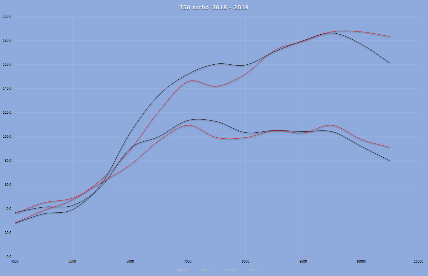

Finally getting somewhere with the OMS. It's now lighter, has new less draggy wings and a nice power graph.
This was running at 10psi according to the RR MAP sensor which we callibrated after as I thought it was wrong. Unfortunately, just as we were about to strat mapping the boost the turbo-return scavange pump shat the bed. The magic 200 bananas seems easily achievable with a couple more psi.
Next thing is a test day, if the terminal speeds are where I wnat them the boost will stay as it ism if not it'll get a tweak:)

With the boost now increased to 1.25bar it's making over 200 bananas ATW. The RR I use is frequented by lots of my competitors, so it's a comparable figure to the 1100cc bike engines making 190.
It also has over 110 toques, again comparable to the 85 the 1100s make.
Unfortunately, an accidental overboost bust the ringlands on No4. No other damage. Worth noting that the power run was taken with the bust ringlands and only to 10,000 rpm, 1000 below max rpm.

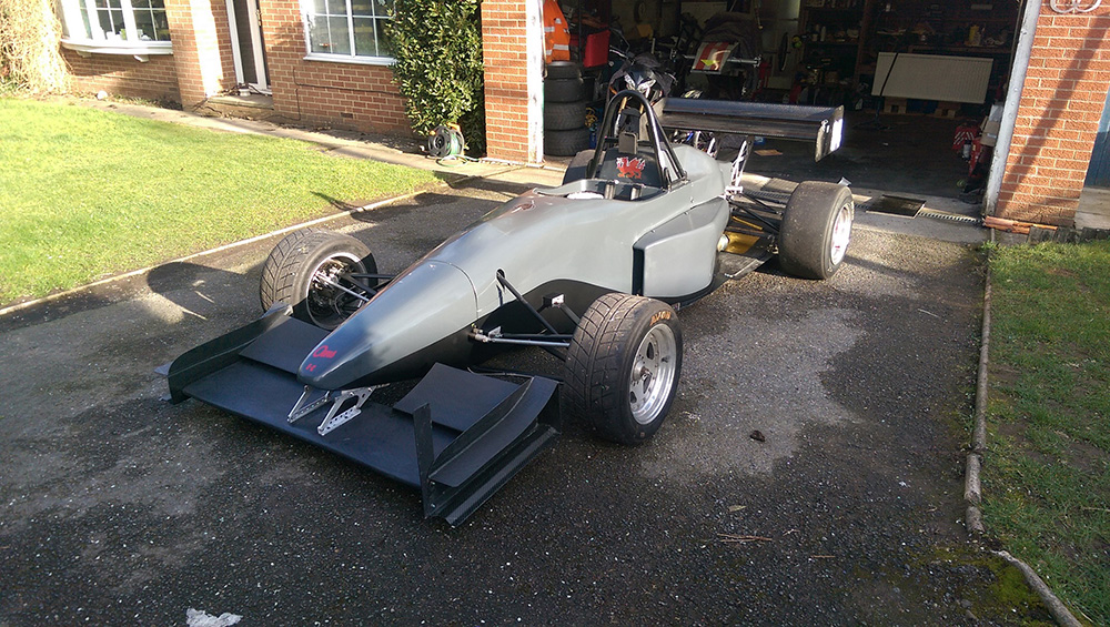

Work progresses on the OMS. Over the winter we have made it lighter, reduced the drag, lowered the engine 32mm and put a new manifold on; plus lots of other minor changes.
Hopefully this will all translate to better times, we were really making progress last year.
Now looks like this, just needs some decals adding.

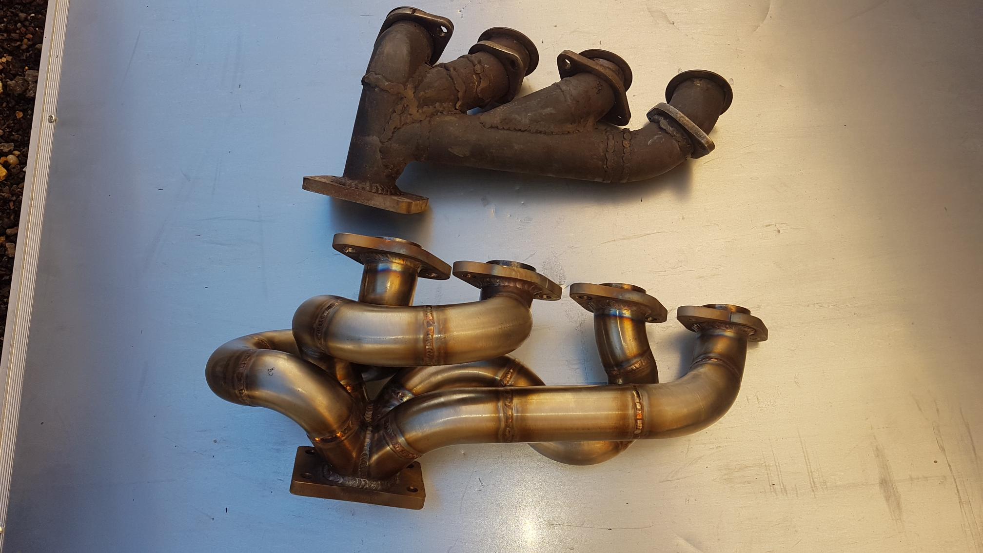

The problem we have is the power. We changed from a really bodged up 'log' type manifold to a nice equal length jobbie. Like below
and the power changed like this - Black is with the new manifold, Red with the old (note this is transposed from a print-out, so not no comments on some odd bits)
What I'm after is thoughts on why the power seems to suddenly drop off at 9500 rpm. It's clearly spooling the turbo up earlier and making more low down torque, but not sure why it suddenly falls away. Thinking about manifold header lengths having a similar effect to a cam change????
For information, following this session at a test day the engine lunched itsself. The failure was cased by a sticking exhaust valve. Could a sticky/leaky exhaust valve cause such a drop?
Feel free to think out loud........
