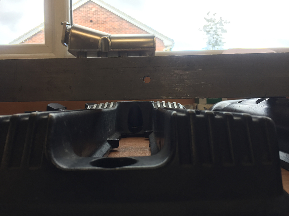

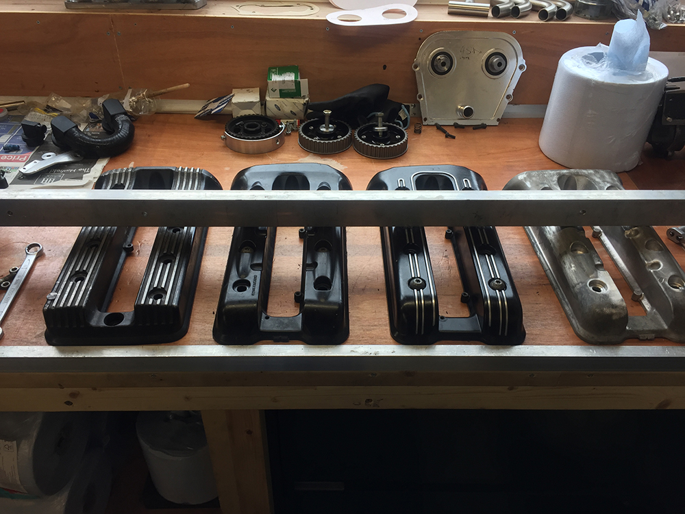

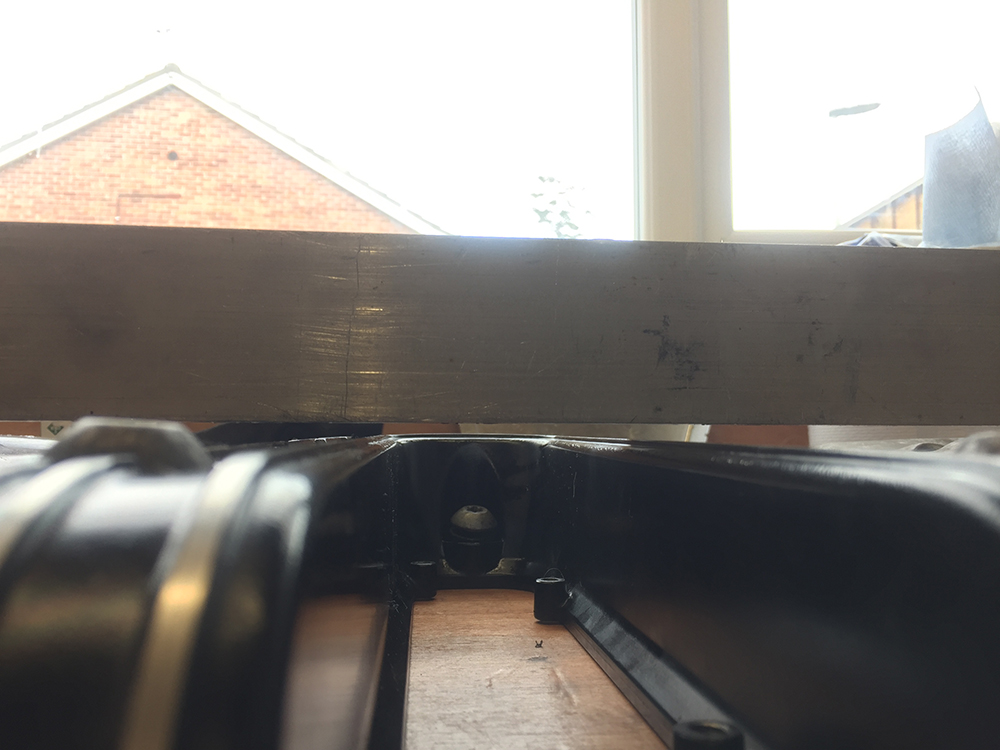

The rocker cover Jayme has used is also the lowest of the 16v ones I’ve had/seen.
The K100 I’ve got is lower still and gave no clearance issues.
Pic’s for reference
Shane
