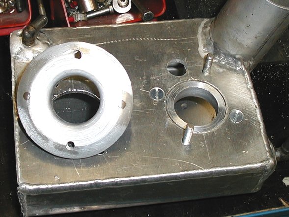

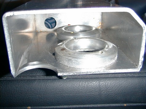

Anyway, back to topic: here are (hopefully) a couple of ppics showing the plenum I fabricated for the Dellorto. I machined stub stacks with about 45 mm ID to suit the carb. It plain did not work. I had to put about 30 mm ID inserts into the stub stacks (mimicking the MG plenum) to get the carb / regulator working.
