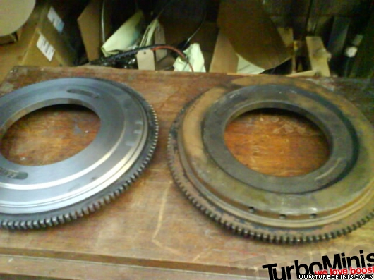

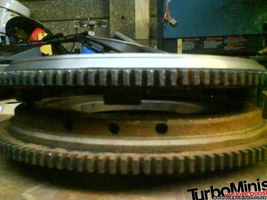

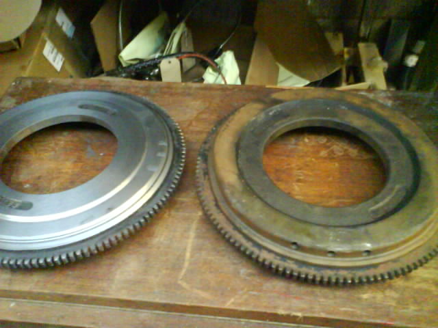

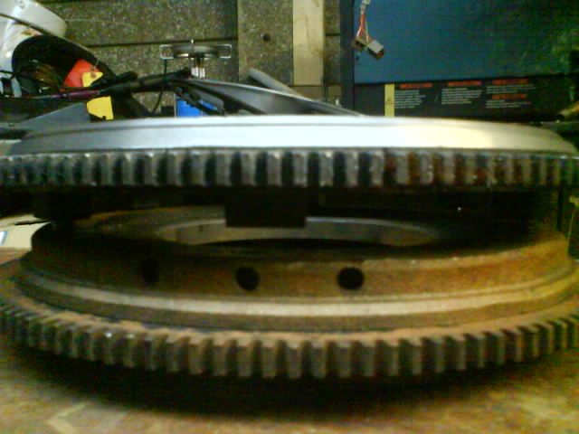

Well ive been reunited with the lathe again...and was then physically removed from the lathe before I got carried away. *hehe!*
After a dissapointing RR day due to a slipping clutch, im junking the pre-verto setup and jumping on the band wagon to try a Robert special verto setup.
I would go for a double grey with paddle plate, but I do far to many miles to warrant a heavy clutch and worn thrusts and money is tight! lol
nice,
youve taken a bit more material off than me.
somthing worth mentioning, the 190mm rally plate is cheaper than the 180mm one.

On 19th Feb, 2009 mini13 said:
nice,
I did spot that, I think im going to go for the 190mm, every little helps! *happy*
I managed to knock 4lbs off it, im hoping to get another 1lb off the centre section aswell.

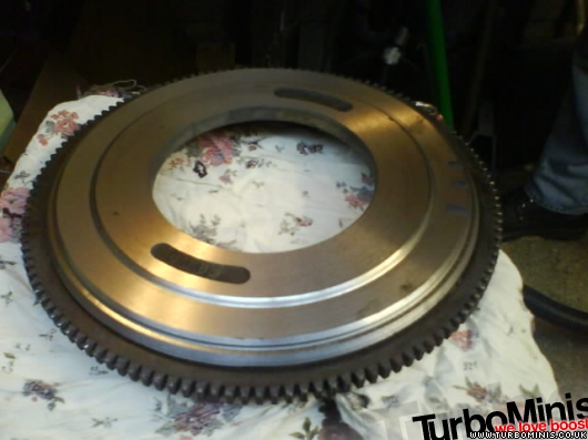

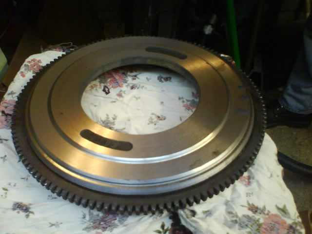

Its finished...well apart from balancing..
I went for 2 turbo spring plates, 190mm clutch plate, and 4 drives straps on each location. Lol that should do it!! I ended up making some 0.5mm collars to go round the bolts to keep the spring plates central. I also made up ome new rivets to keep the assembly as standard as possible. All seems really solid, just hope it works! *oh well*
