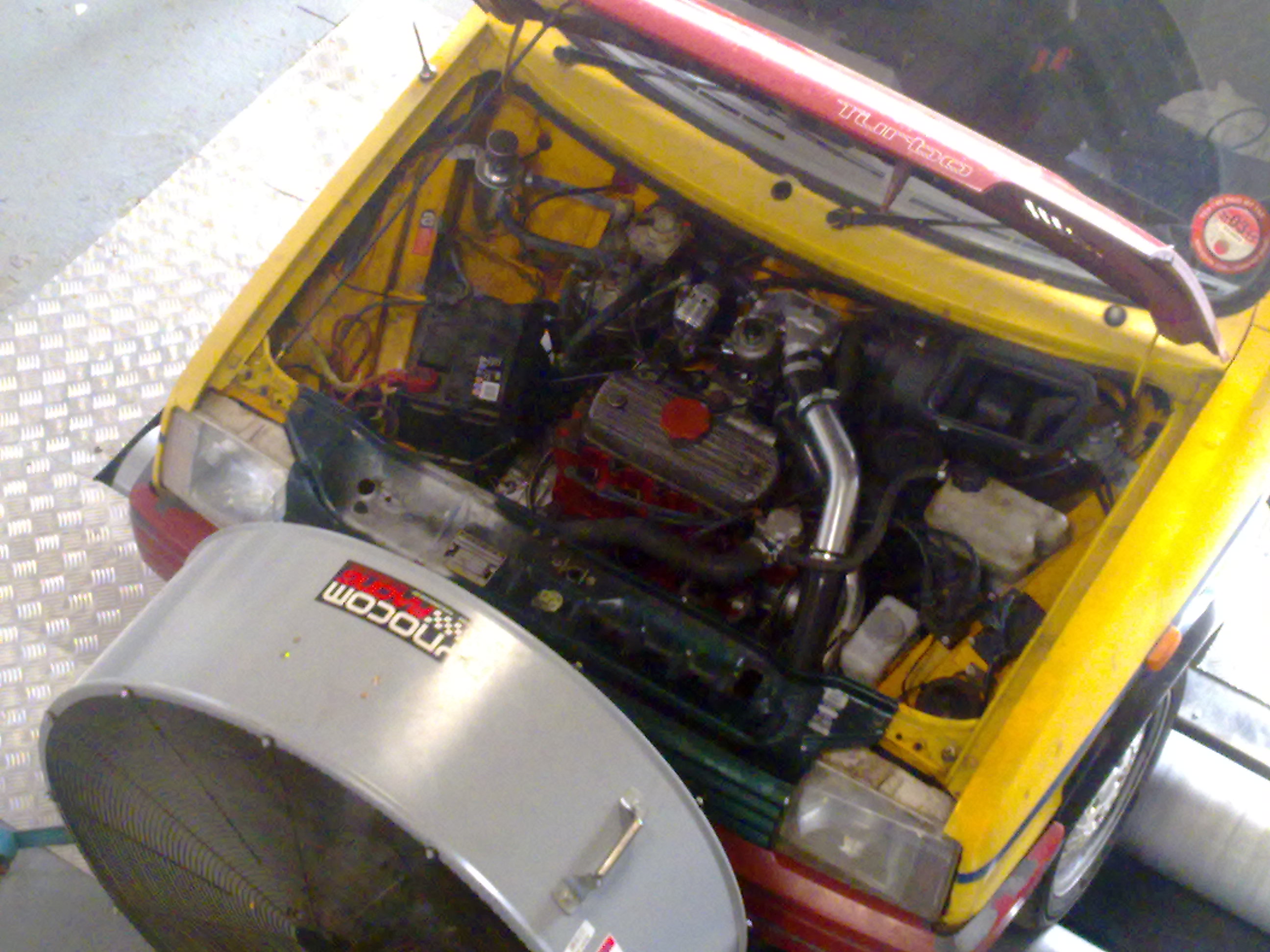

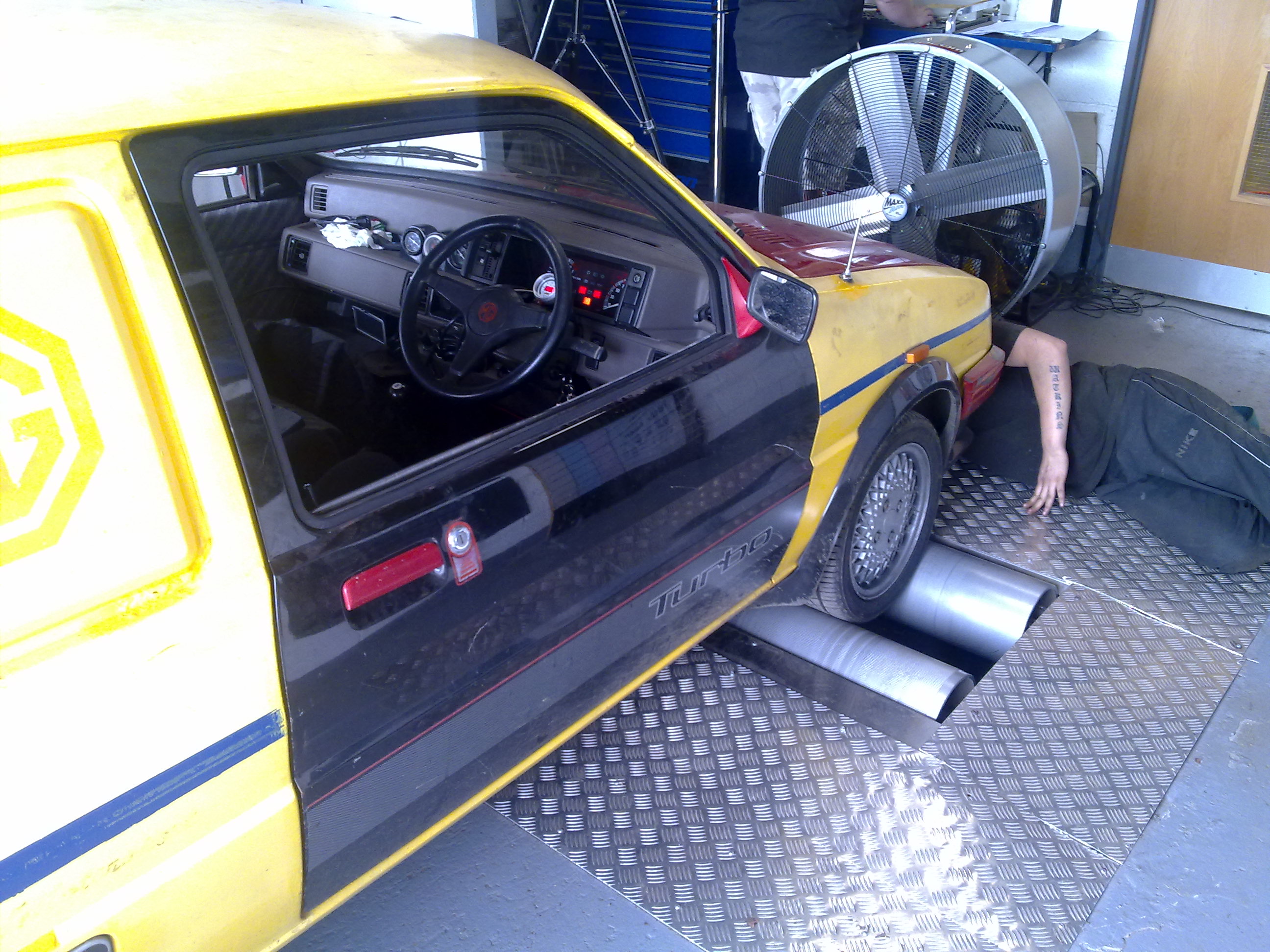

I think there are a few more bananas in there yet, but we have some new toys for it over the winter. We're going to be optimistic and aim for a 13 second 1/4

psst it was only on 12.5psi of boost with a 15psi spike at 4550rpm *wink*
i was going on andy post on my boost thread :) educated guess at the rest*happy*
