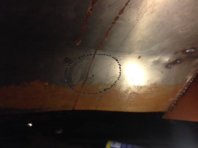

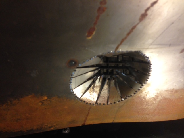

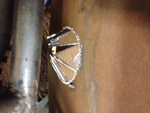

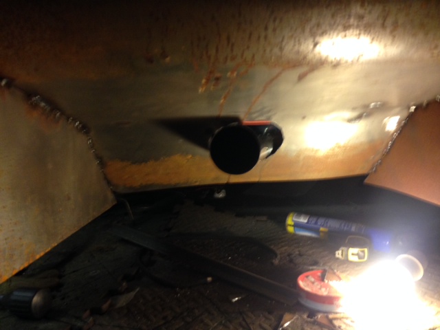

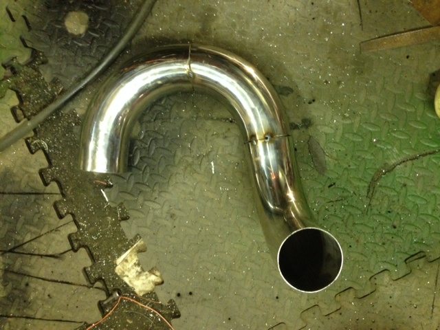

Started on my Exhaust last night, I bought some 3" Stainless Mandrel bends off he bay and 3 bolt flange which still waiting to come. Anyhoo, the exhaust it basically straight out the turbo, down, backing up on itself the going straight into the diffuser.
Had to stitch drill a hole out as I didnt have a hole cutter that large.
Wide arches needed. Hmm time to sit with a cup o tea and stare at it for a while

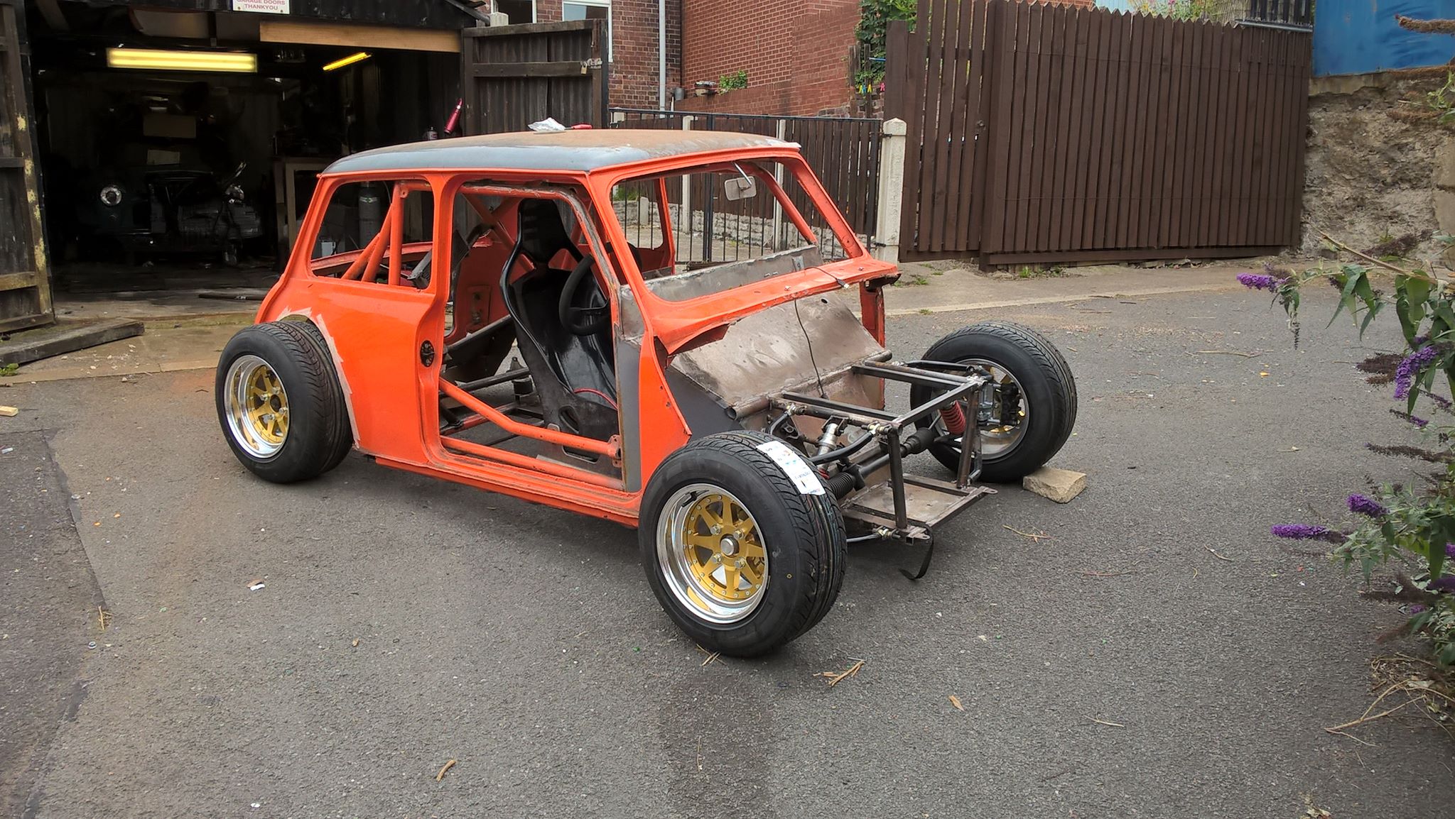

This is going to be nice and wide, what are you going todo for arches?
4 oil drums jb welded on t side *happy*
Those are some epicly noice wheels too
Are your moulds big enough Jim?
Ive ordered some from Arc Angels.
Yep Carlos has done one hell of a job and cant thank him enough, I now owe him a million Beers and free sexual favours.
Yea I think they would be. Ian Curley has them, I'm sure he would knock out a set of arches in carbon or grp
Wheels do look ace I have to say.
Fook me, it's wider than it is long! Awesome.

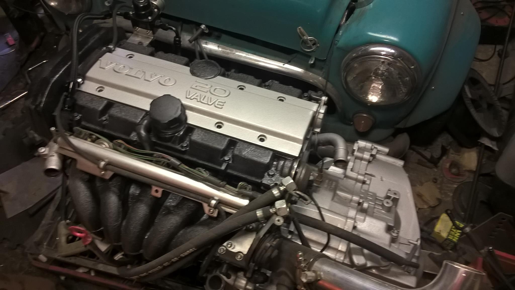

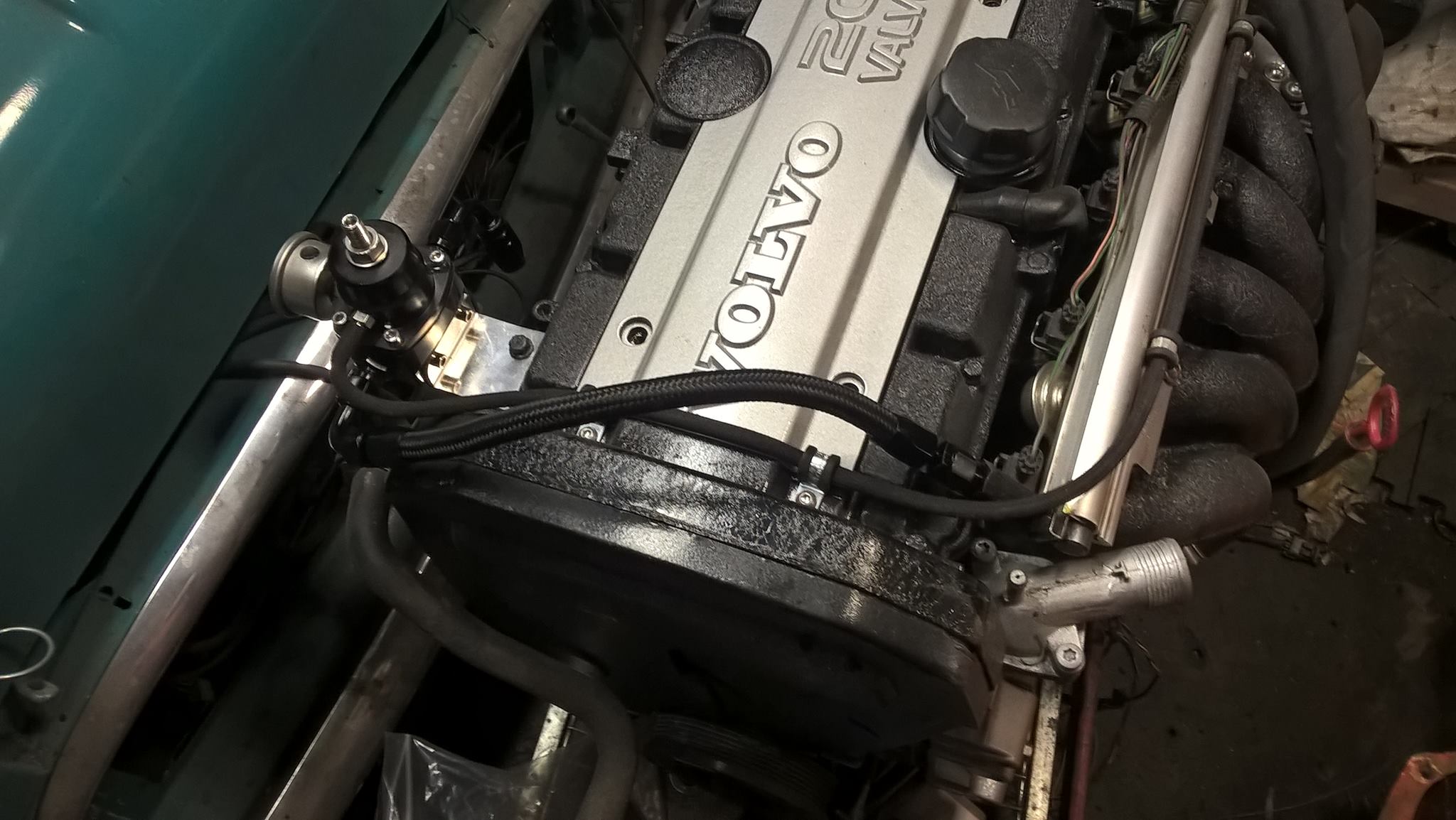

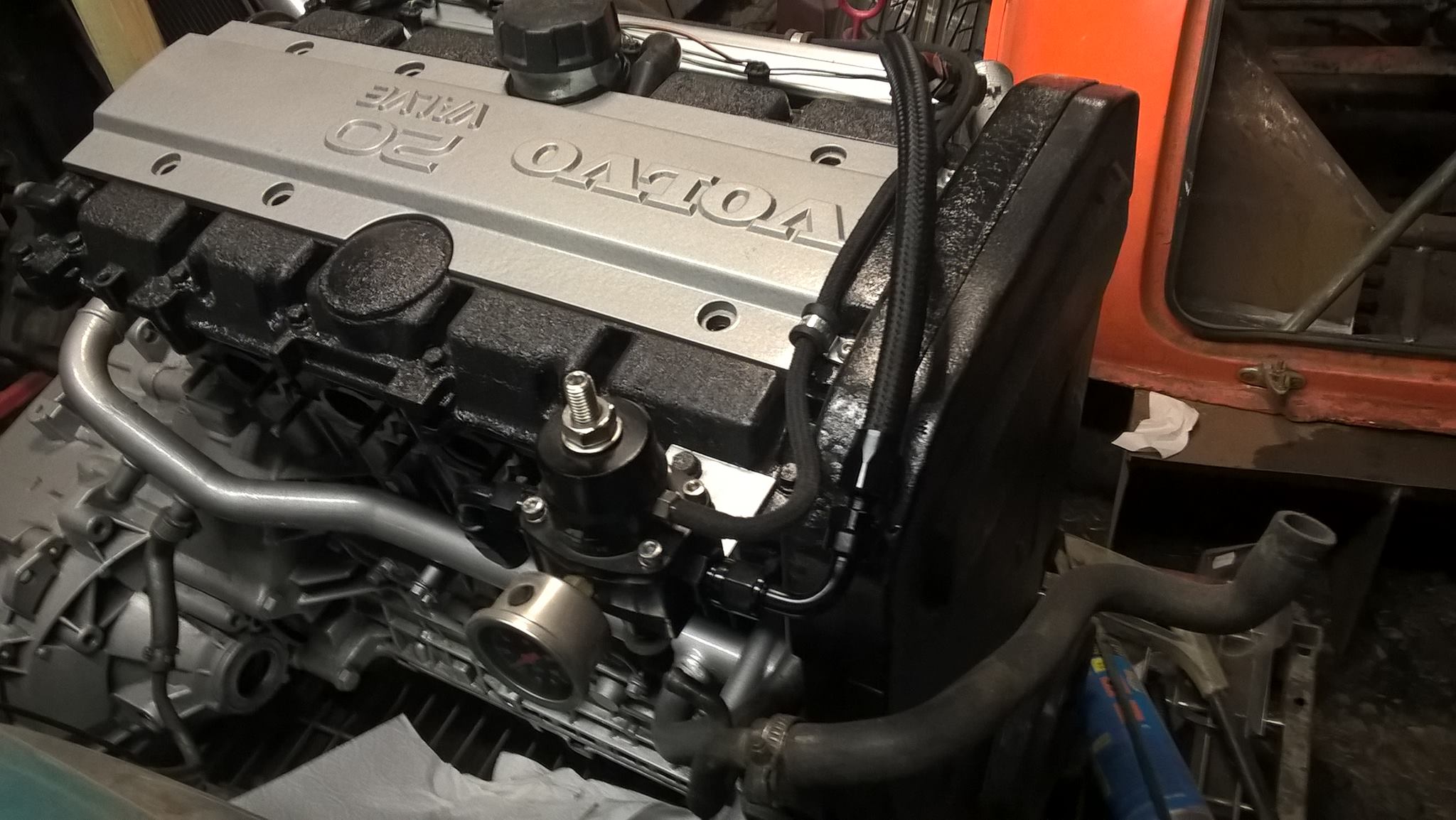

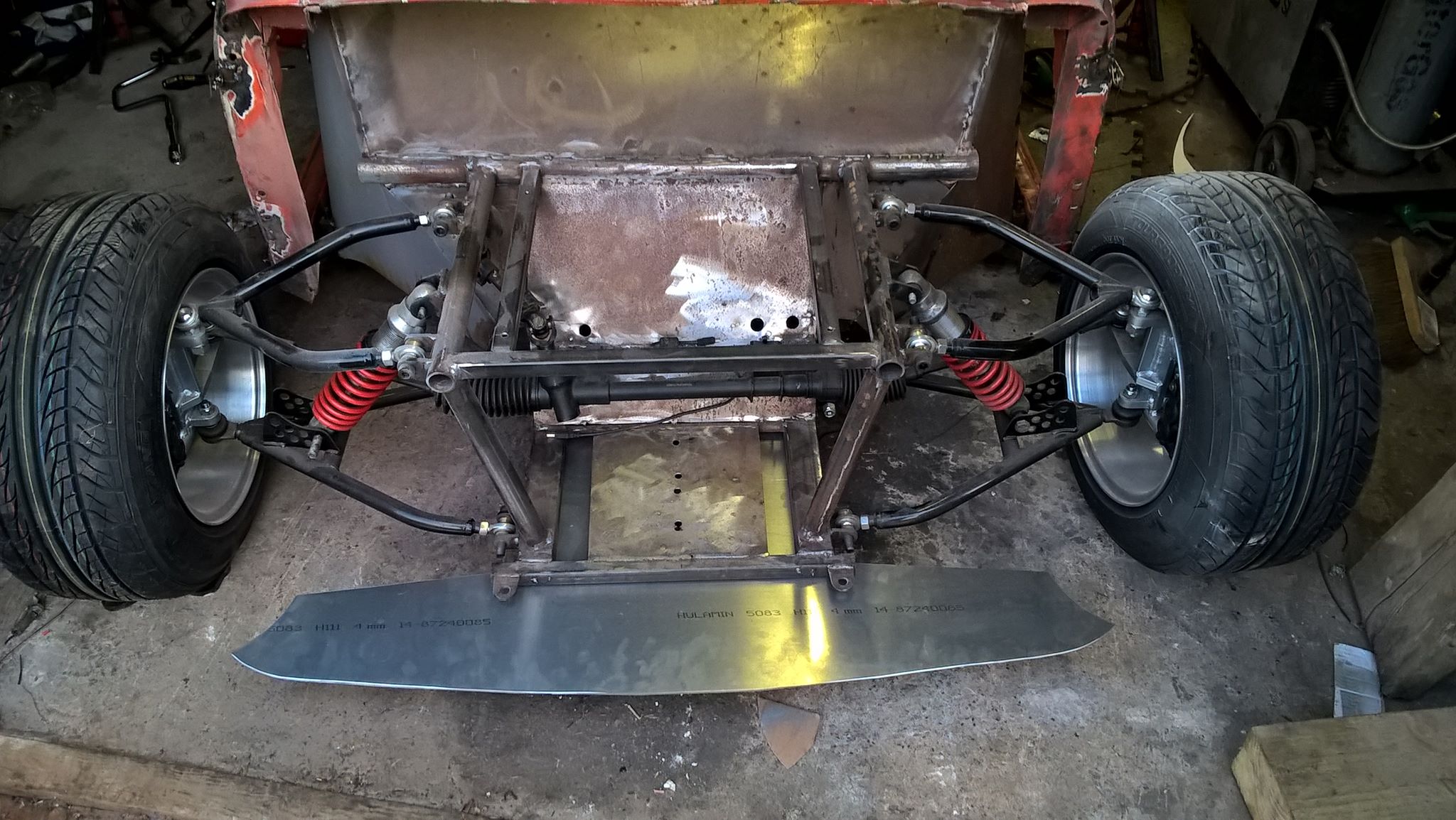

Ive just finished the Fuel Rail and Fuel Pressure Reg off tonight, also go the front end kind of fitted. Attached the A Panels to the FG front end and will attach to the inner arches with dzus pins.
Running immensely rich on a very basic map. But it runs all the same.

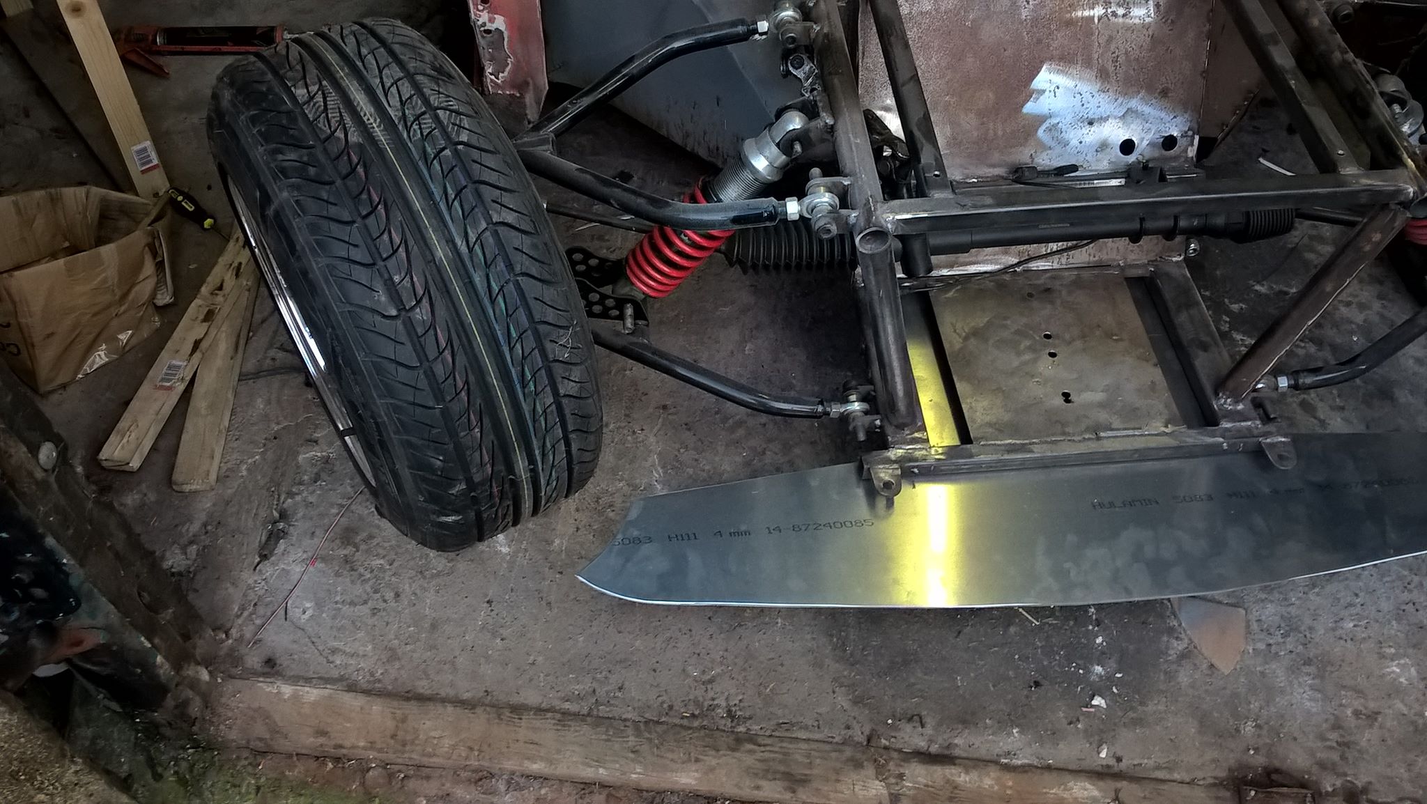

More Progress!

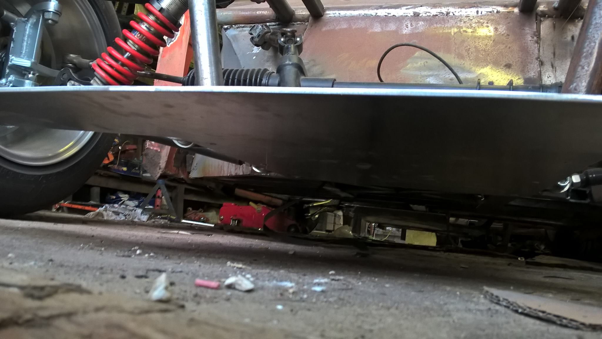

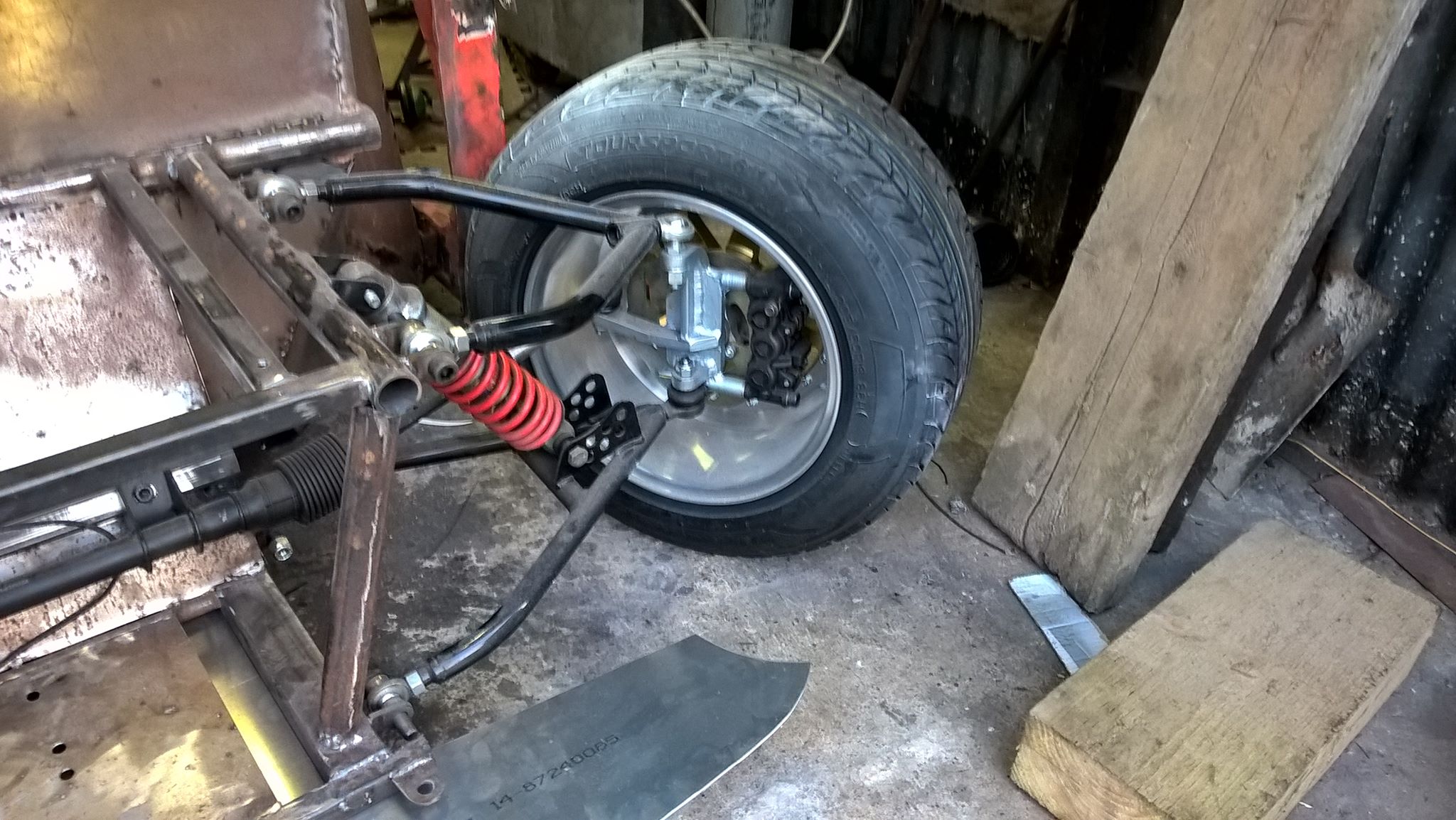

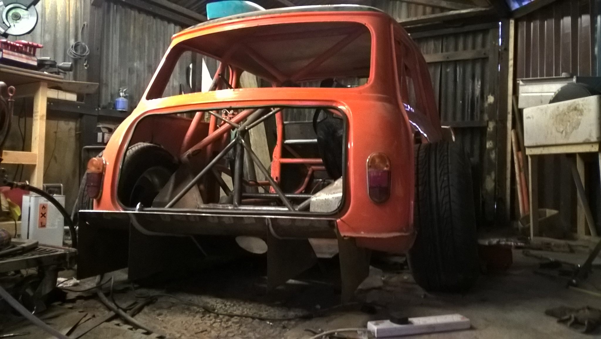

Made a front splitter and attached with counter sunk allen heads.

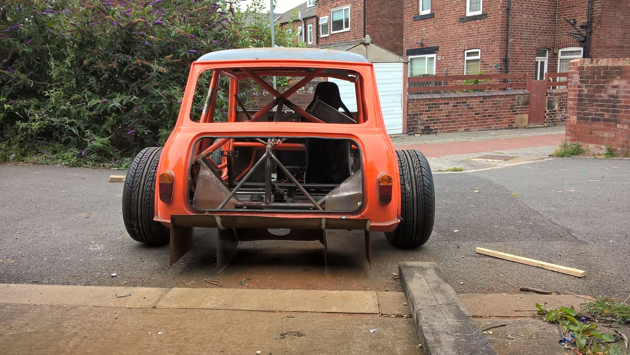

Also fettled the rear diffuser and set the body down where it should go, just need my arches now so I can finally get the body off and down the spray shop.
