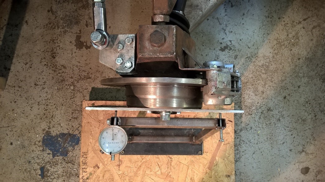

re bump steer , i quite like the idea of strapping a cheap laser pointer to the wheel , pointing it at a vertical line on the wall ,and just jack the car up ,and see how much the red dot moves from side to side ,you could even take the shock off and do the whole hub movement ?
^^^ this,
although, you'll probably want to measure at 2 distances, as you'll get some change in track through the suspension travel,
samforsey12345
18 Posts
Member #: 10987
Bromsgrove, DY9 0BB
takes a bit of time to make but useful tool from alan staniforths books
