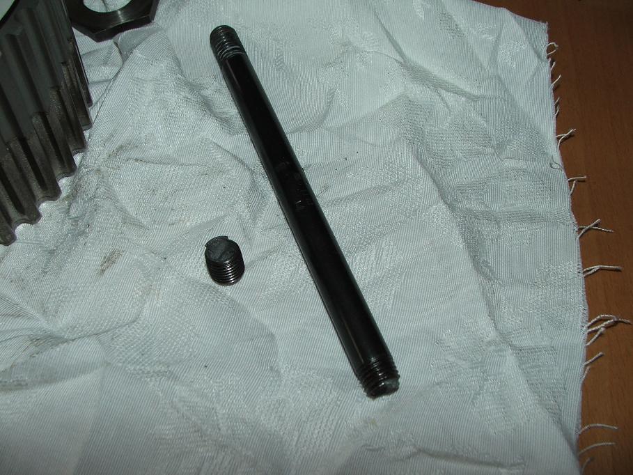

That done with, I continue. Bolt the head on, torquing down the head nuts progressively to 45lbft, and this happens
the threads are not stretched, you can wind a nut onto the stud, and the broken bit.
When I first built the engine, I could only find 9 genuine studs, 8 of those came from two 998s and the other from a box of bits, all genuine Austin Rover. I bought a full set of new studs on Ebay, but they were slightly different, more thread on the coarse end and less on the fine end, and, a little shorter. I was not overy happy with them, so I used the genuine ones and one of these new one to make up the ten. First time I bolted the head on, this stud took some more turn to get to the torque setting. Second time I bolted the head on, same stud, different location, again took more turn, but still torqued. This time again taking more turn, then pop, off came the top of the stud with the nut.
I'm getting pissd with this. But, im not going to rush it, if i miss Avon, so be it.

On 17th Feb, 2009 Rob H said:
There was a post on one of the "other" forums recently about head stud failures...
Sorry, can't remeber which one or the post, but pretty much the same.... current "new" ones are crap it would seem.
On 7th Jun, 2009 PaulH said:
All I have to Say is ARP Colin fit and forget
If they only did ones the right length and in a set of 10 *wink*
Standard genuine studs are more than up to the job. Jimster uses the same. That one was just shite.
