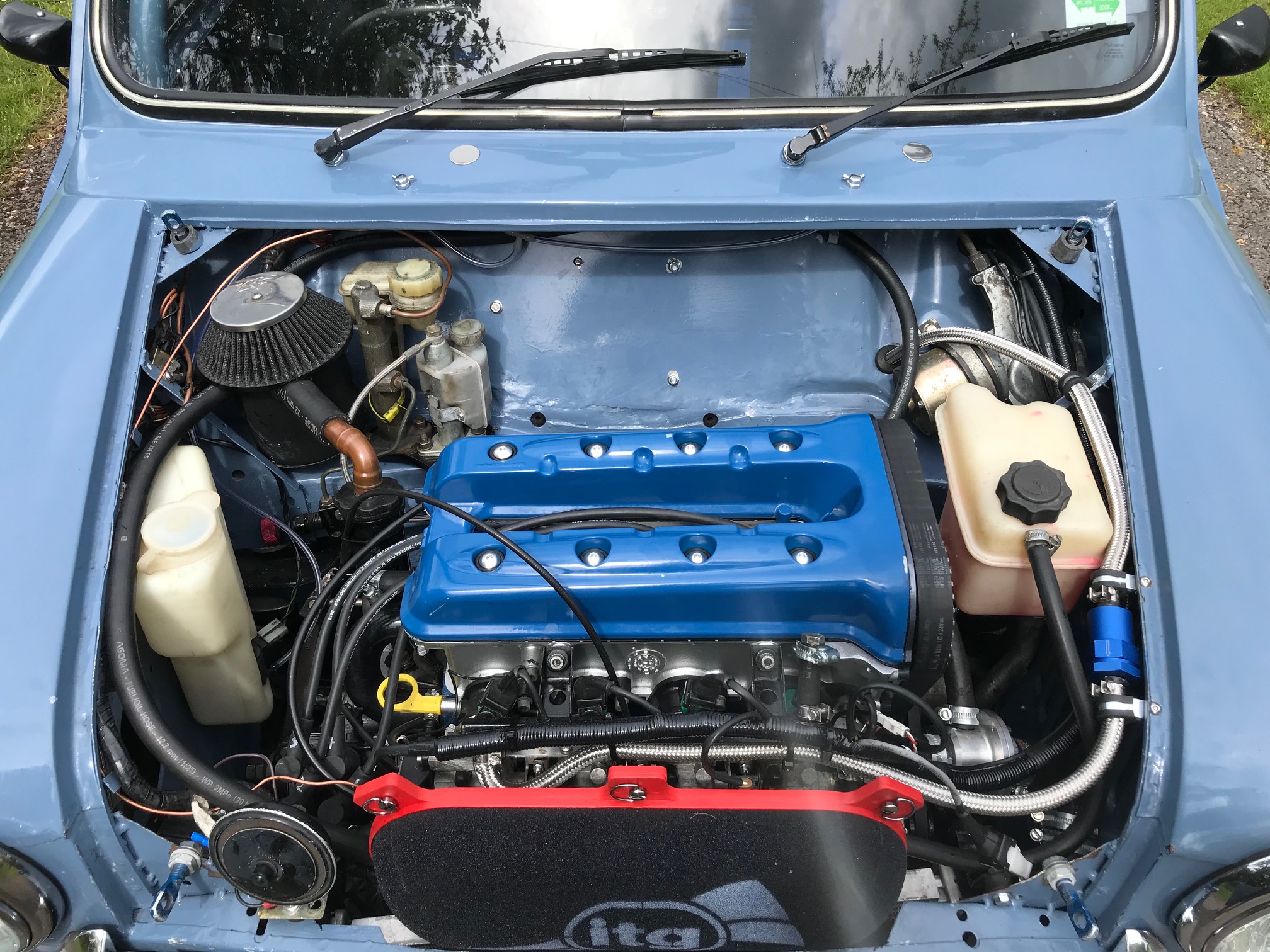

Its been a while since this was updated, mainly due to chipping away progressively at the to do list.
I have no idea how the turbo crew manage to package everything as I'm totally out of space at the front, to the point that various components, brackets etc. have been made, remade then altered several times after.
Lot of time spent trying to get the wiring right and a neat and tidy install, so most of the loom has been opened up, and all redundant wiring was either stripped out or repurposed.
Went with a large (by lithium standards) powerlite battery weighing in a whole 2kg but at least has plenty of capacity and is MSA approved.
Finally today I gave the cam timing a final check, looked for anything that could go wrong, calibrated a few sensors on the SC ecu and hit the start button, amazingly it fired up immediately.
I now need to go through the whole car and complete a lot of finishing off, but pleased that the attention to detail in terms of getting everything right payed off.

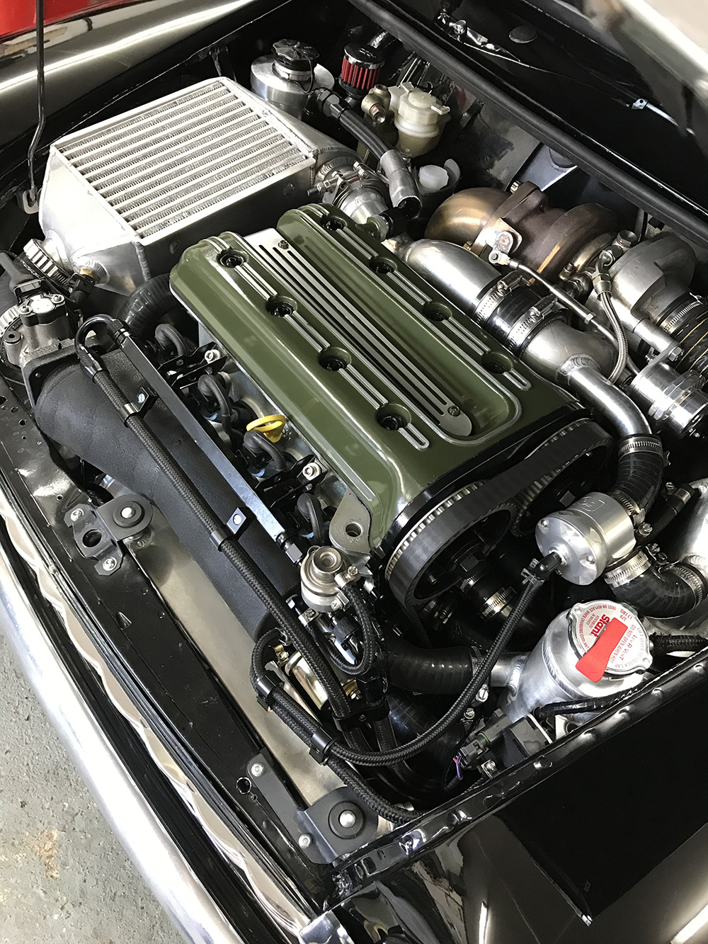

It really is quite simple, you waste ten years building it three times over trying to get everything in and in a position that your happy with.
You then realise that you've made the whole thing a total PITA to even do the simplest of tasks, you then contemplate undertaking attempt number four when you realise that you have friends with small kids that can be trained / rewarded with Haribo for their assistance.
You then think of ways to stunt their growth so they remain small and an ever useful tool in your arsenal.......
Im sure there is an easier way tho..........

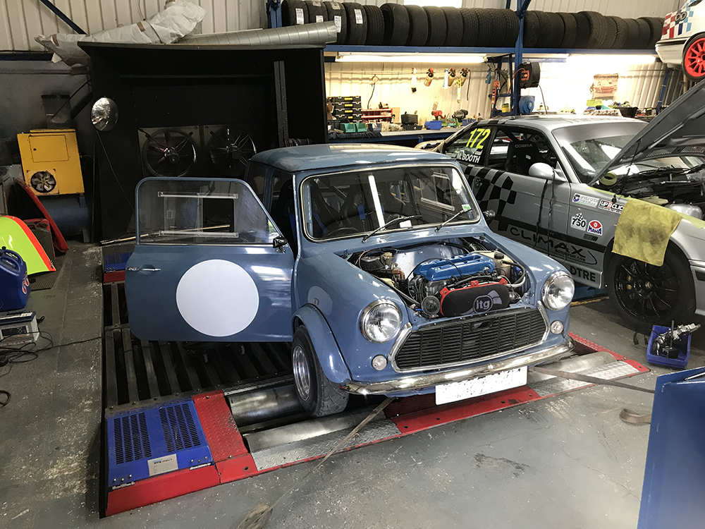

Finally got an mot and enough running in miles to take it to the rolling road to be set up. Went to West Tuning at thruxton as he has quite a bit of experience with the SC ecu. However that where things started to wrong. Rollers were quite polished so ended up strapping the car down to pull it into the rollers, however wheelspin was then repalced with clutch slip.
Having validated the fuelling and ignition were safe I packed up and with Goodwood 3 days later there was not much that could be done.

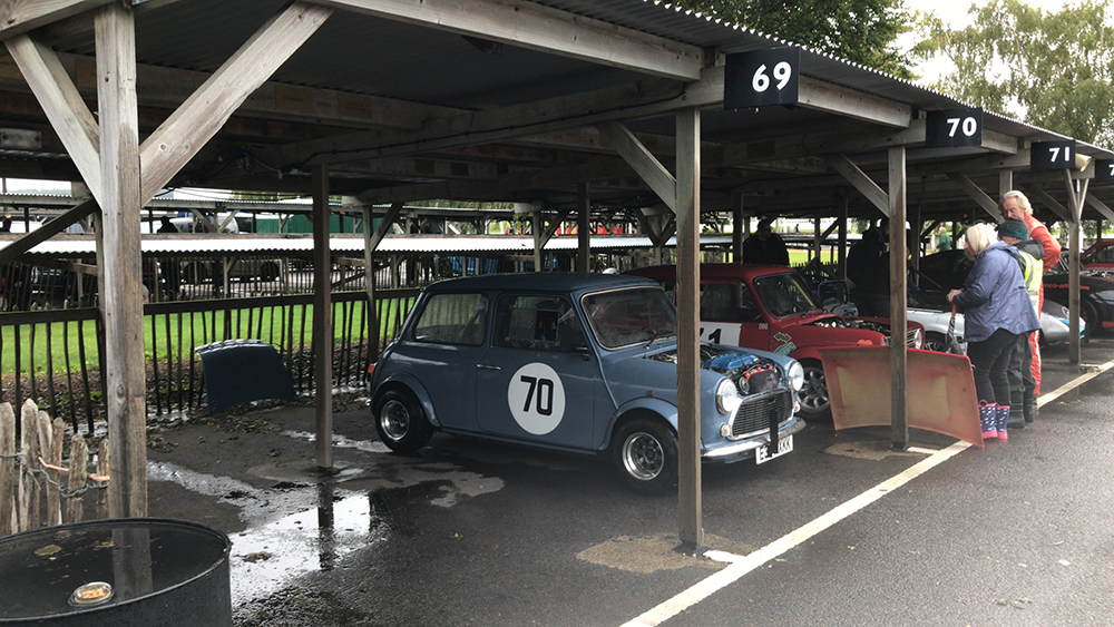

Stu has done a good write up on Goodwood but safe to say it was an experiance.
I have not been up there since 2013 and totally forgotton the circuit, and the weather meant that having not driven the car in anger for 4 years now I was no where near as committed as I could have been.
I also seem to have miscalculated the gear ratios and ended up with a top speed of around 110 ish at 8200rpm I think having yoko A032'S on a 10" rim from where they are stretched reduces the diameter a bit throwing things out. Whilst the clutch is off will change the primary gear, as running mini spares ones to allow that flexibility.

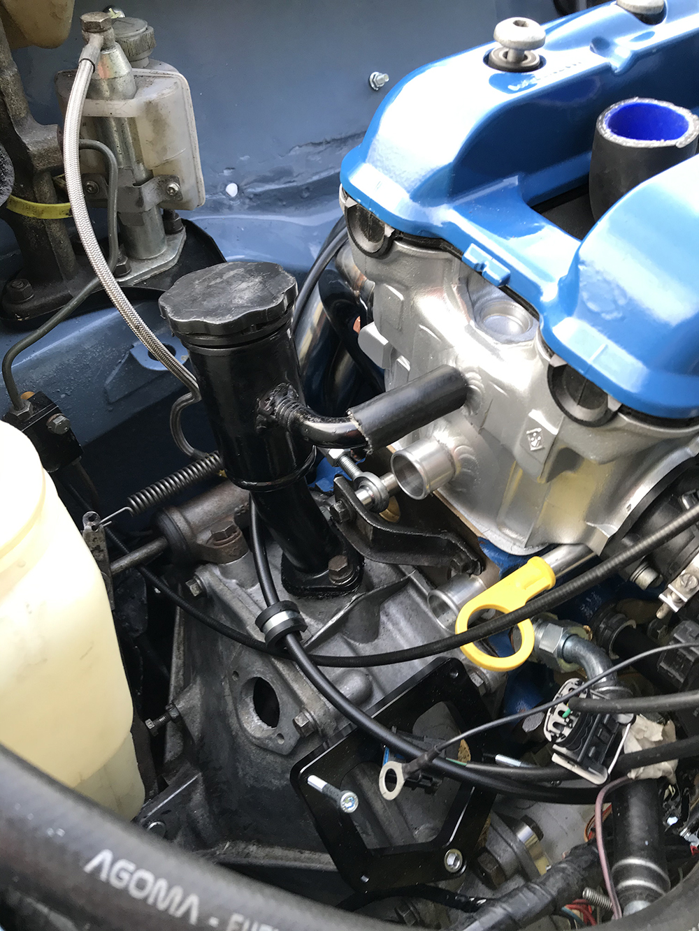

How did you find your breather set up in the end? manage to keep crancase pressures down?
Shane
4310 Posts
Breather set up is working well. There is a 22mm out the transfer breather, 10mm from the oil drain and a 13mm out the old dipstick hole which will now be the filling point. That said when I did the first fire up the 22mm wasn’t connected so may have pushed some oil out then past the primary gear oil seal then.
It’s not even pushed a drop out into the catch can.

All vented from the canister on the bulkhead?
Is there any reason you didn’t opt for any on the rocker cover that most do?
Only asking as I’ve pushed a litte oil on occasions.
Shane
4310 Posts
If you look closely there is one into the transfer case breather.
I did add a 2.5mm oil restrictor to the head as it was getting too much oil.
All good now.

I didn't spot that as it was obscured by the leads.
How did you come to the conclusion that you where getting too m much oil? Also what did you use in terms of a restrictor?
Thanks
Shane
4310 Posts
The head seemed to be filling up as I was getting too much out the top breather. Added some larger 10mm Id drains to the back, 10mm on the conversion plate and then added a bit of a restrictor. Restrictor is achieved by drilling out a 1/8 npt oil pressure gauge t piece to 2.5mm at the base of the feed. Seems happy now, as I pulled one of the cam retaining caps. Some people have gone to 1.5mm but would rather have a little to much oil than too little.

Having finally resolved this I visited Ray at West Tuning at Thruxton, who has experiance of the SC ecu and a few 16v minis. The results were 151hp and 110 lb/ft torque. Its great to finally be able to use the power and the car feels so alive now.
