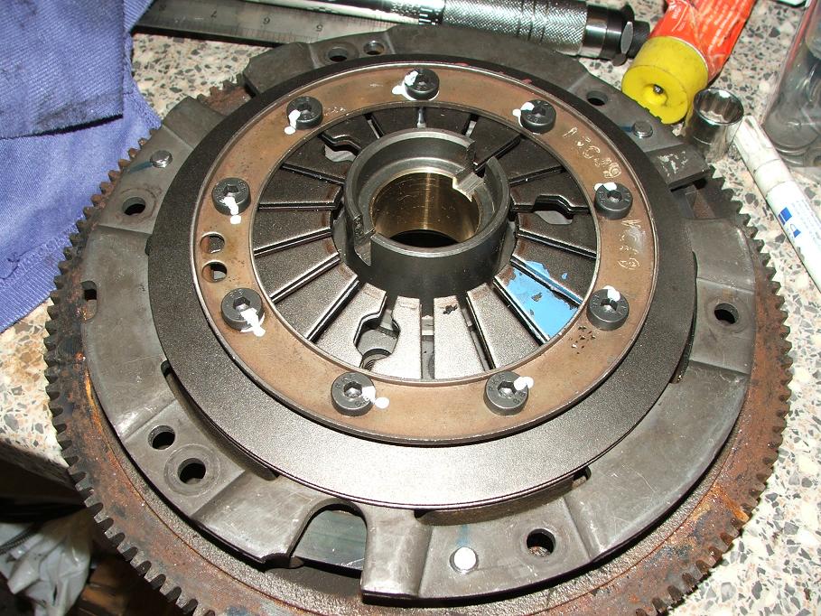

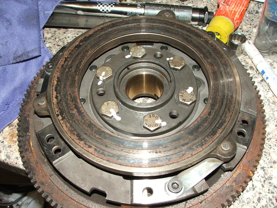

Piccies of an AP set up. No idea if its going to be too much *oh well*
The pressure plate does need refacing. Going check run out all round and to see if it will balance without the flywheel.
I might also try and see about measuring the throw out force when its built up and compare it with the orange pre verto, which will require a little math too.
