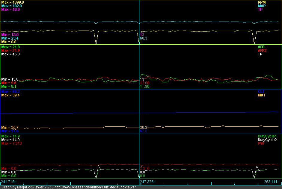

I am not sure if it’s an ignition problem what I see in megalog viewer is that the RPM drops to zero together with dutycycle the longest time that RPM stays zero that I have seen so far is 0.2 sec. Most of the time the problem occurs RPM drops to zero for just one sample. I will try to attach a plot.
Paul, do you mean after start enrichment with AE? I already tried reducing after start enrichment to zero to reduce the side effect of the problem because after the drop in RPM after start enrichment kicks in and disturbs the afr this did reduce the effect of the loss of sync but the problem stayed.

That looks as though the VR sensor is losing the signal at odd times.
I would turn on the noise filtering if you haven't allready.
I also have to take a walk in the frost this afternoon.
EDIT: Odd that the MAP signal also drops.
Re the MAP signal dropping slightly at the same time, try plotting TPS, CTS and IAT and see if similar glitches occur at the same time.
The timeframe is too short to see on the guages in TS (like I suggested earlier) but if the logs also show similar glitches on the other sensors at the same time, just a wild thought.... , they are all off the 5V supply ???
I'm thinking that there could an issue with the board power supply or earthing.
Is everything earthed at the same point?
EDIT: Have you calibrated the TPS? only it is not showing on the above plot although it is selected twice.
