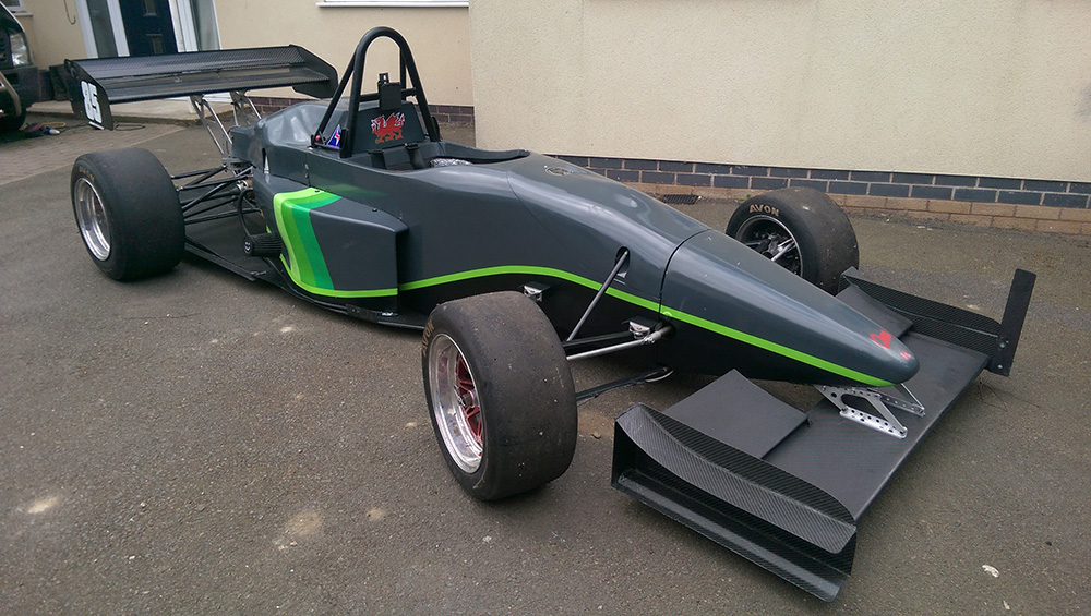

Finally got the new vinyl on. Quite pleased with it.
www.twin-turbo.co.uk
Looks mint!
