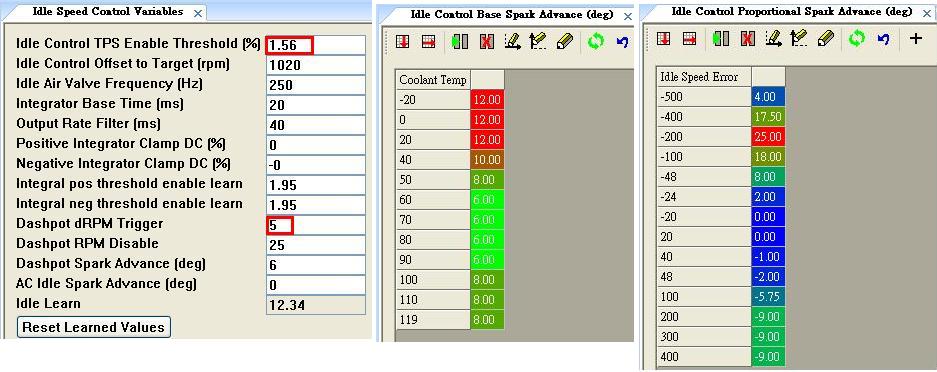

I've problem of "engine died at a stop sign" too.
I think that the idle speed control is the key.
I've modified some idle control setting on my MPI Typhoon ECU.
First, in the "Idle speed control variables", enlarge "idle control TPS Enable Threshold[%]" from 0.78 to 1.56.
Second, reduce "Dashpot dRPM Trigger" from 1000 to 5.
All of these setting will make the Typhoon ECU enter Idle control a bit earlier to prevent engine from stall. Also, you can try to disable "Over-run fuel cut-off".
I think that the "Main spark advance" of base mapping did not take control of spark advance when idling.
The Idle control spark advance is controlled by 2 setting:
"Idle control Base spark advance" and "Idle control proportional spark advance".
The first one is "BASE" referenced spark advance when idling.
The second setting provide spark advance correction in accordance with the RPM error when idling.
You can try these setting and, hope it can resolve the issue of "engine died at a stop sign".
PS: MY ECU is Typhoon 2 (not Delta 400) and, the version of SXtune is 2.2
