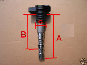

Cheers mate, might be easier if you could grab some measurements for me?
measurement C is how far the plug goes inside to make contact if you get me?

on them vag coils (what i run) the very bottom of the coil *just* grips over the hex part of the sparkplug. the working guts of the coil extend down a little into the perforated bit IIRC. incase your thinking of modifying them :)
Denis O'Brien.
ohh right, that makes them very short then doesnt it? might have to bin that idea
still researching what the high power s2000 / k series engines use coil wise, it seems alot move the the b series ht leads and use big coilpacks :(
