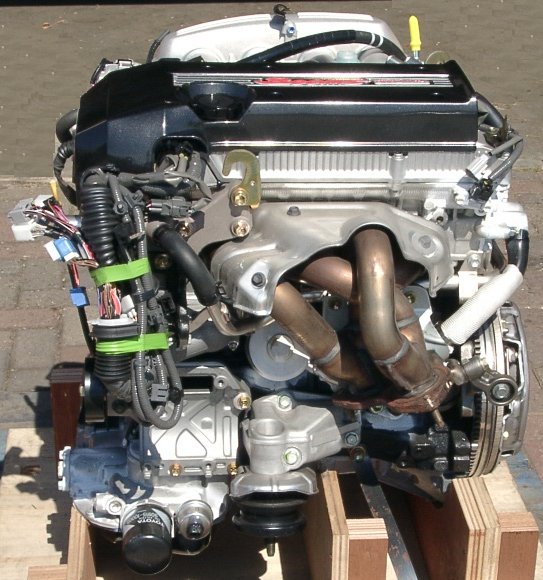

I'm leaning more towards a normally aspirated engine for more confidence cornering (RWD) and more linear power delivery.
The 3SGE Beams motor looks nice albeit controlling the vvti would be next to impossible unless I stuck with the appropriate OEM ecu.
Thanks for the replies so far, still thinking........

Anyone know why that pic got attached to everyone's post rather than just my last one?
6301 Posts
Just a bug in the forum *wink*
fixed!
