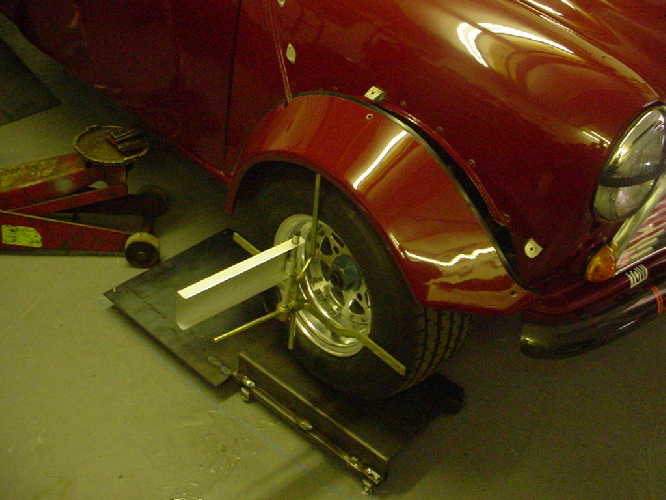

This is not quite the right photo but shows you how i fitted my modified Curley type arches (mine are moulded from a modified set of curley ones)

cheers for the pic scruffy, looks good. I know i will have to trim the front to get them to fit i just didnt want to cut them where the hockey stick is for the flip front, want to keep them in one piece somehow if i can.
will have to do some thinking as i dont want any fixings showing on the outside of the car at all be it wheel arches, flip front or anything *wink*

I attached mine like scruffys.
I used Rivnuts to attach arch to bracket, and a combination of rivits and nuts to attach bracket to car.
