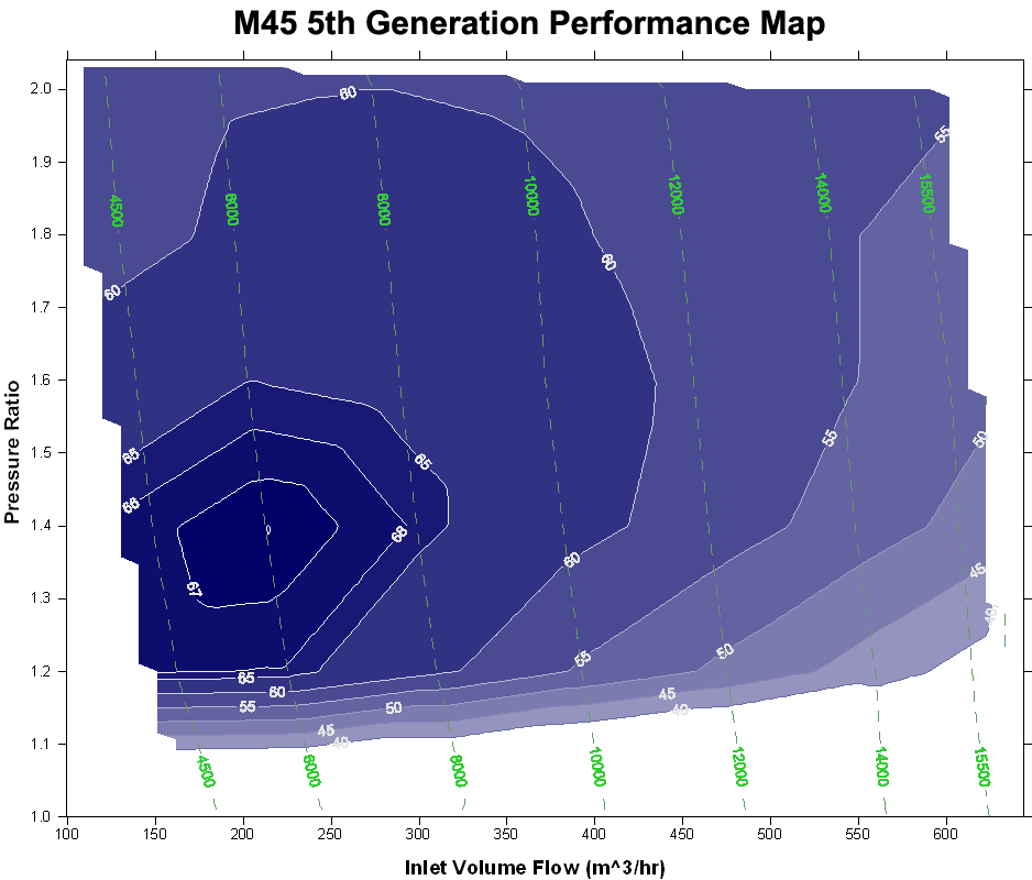

Problem with the M45, is that is is not very efficient above a 1.5 pressure ratio which works out at about 8psi boost.

The efficicency of the M45 isnt too bad, They can be ported and the noise reduction ports sealed to increase the efficiency.

Here are the maps for a fifth generation eaton M45 (not many people know you can get thses!) -

There are obviously many maps!

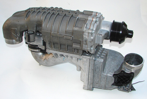

whoops , iv just realizeed , the bini cooper s has the throttle after the blower , so does my sisters db7 ,doh , so sound like im talking drivel , !!!!
I think they use some sort of actuated recirculation device.
On the attached picture, the bit underneath houses a valve, I think.
Edited by Paul S on 17th Dec, 2006.
