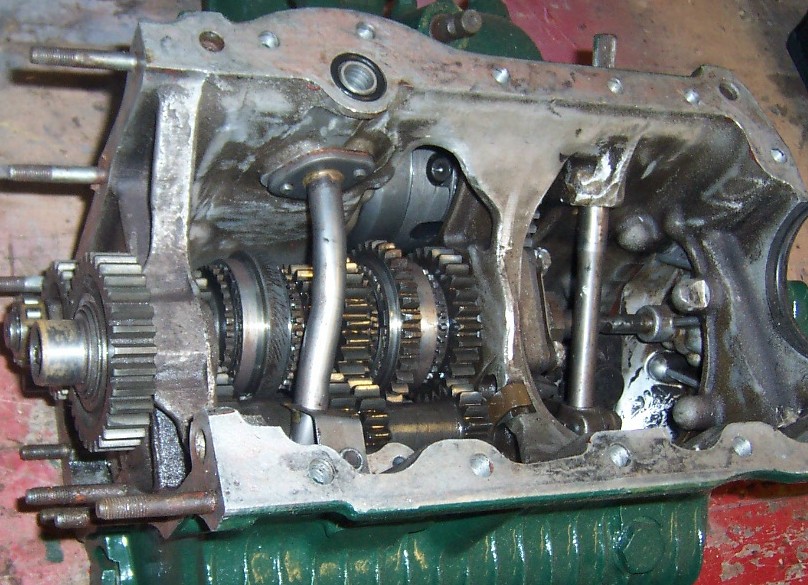

Will, I hope this should help with the potential drop gear problems.
(see picture).

AH!! green paint ,a good choice and always contrubutes to gearbox integrity, and if combuned with a green engine should see you have years of trouble free racing,
danboy
715 Posts
Member #: 1381
Spot on Carl, It's British Racing green So it should last even longer
Yes?
