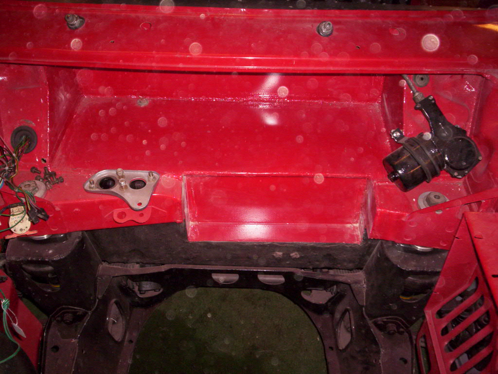

Maybe so Iain
Yes i fitted a bulkhead box when I did the shell (just in case) as I was doing a 1380N/A at that time.
I am doing the 998 as a project just for the technical challenge of it. Which is why I don't want to buy all the bolt on bits.
I want to try something different to see if I can.
It may all end in tears who knows
Sorry about the quality of the picture it was taken some time ago and was for reference only not to use on the net.
Regards
Dave
