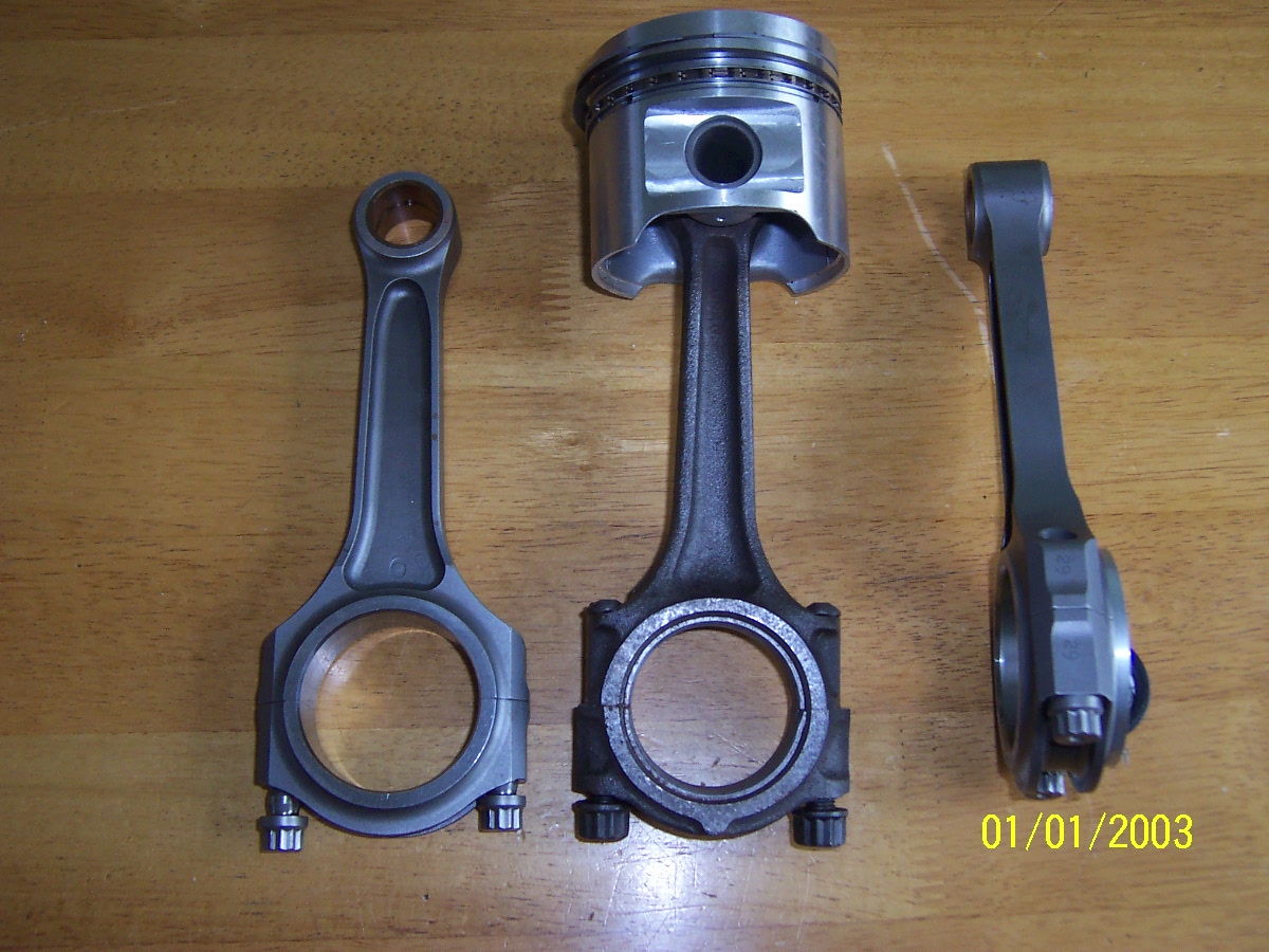

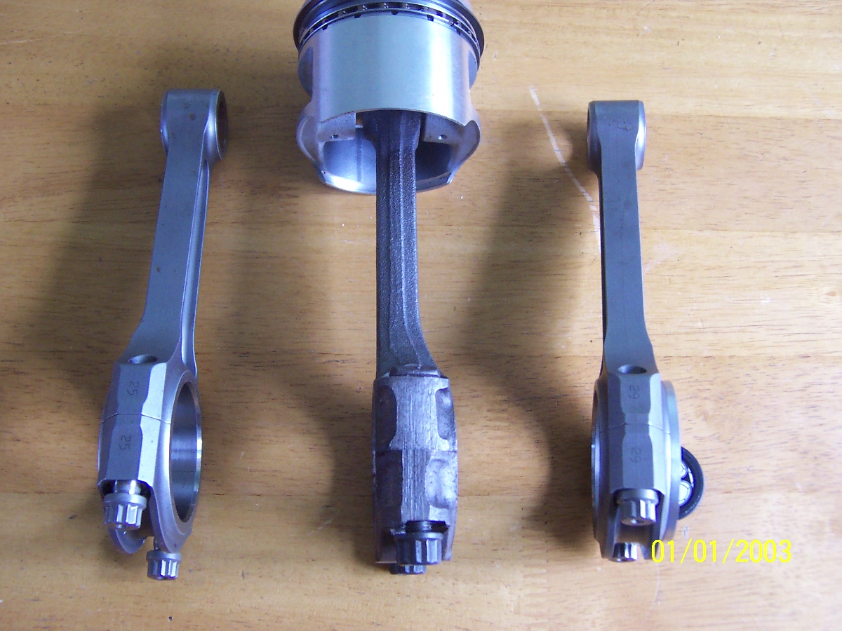

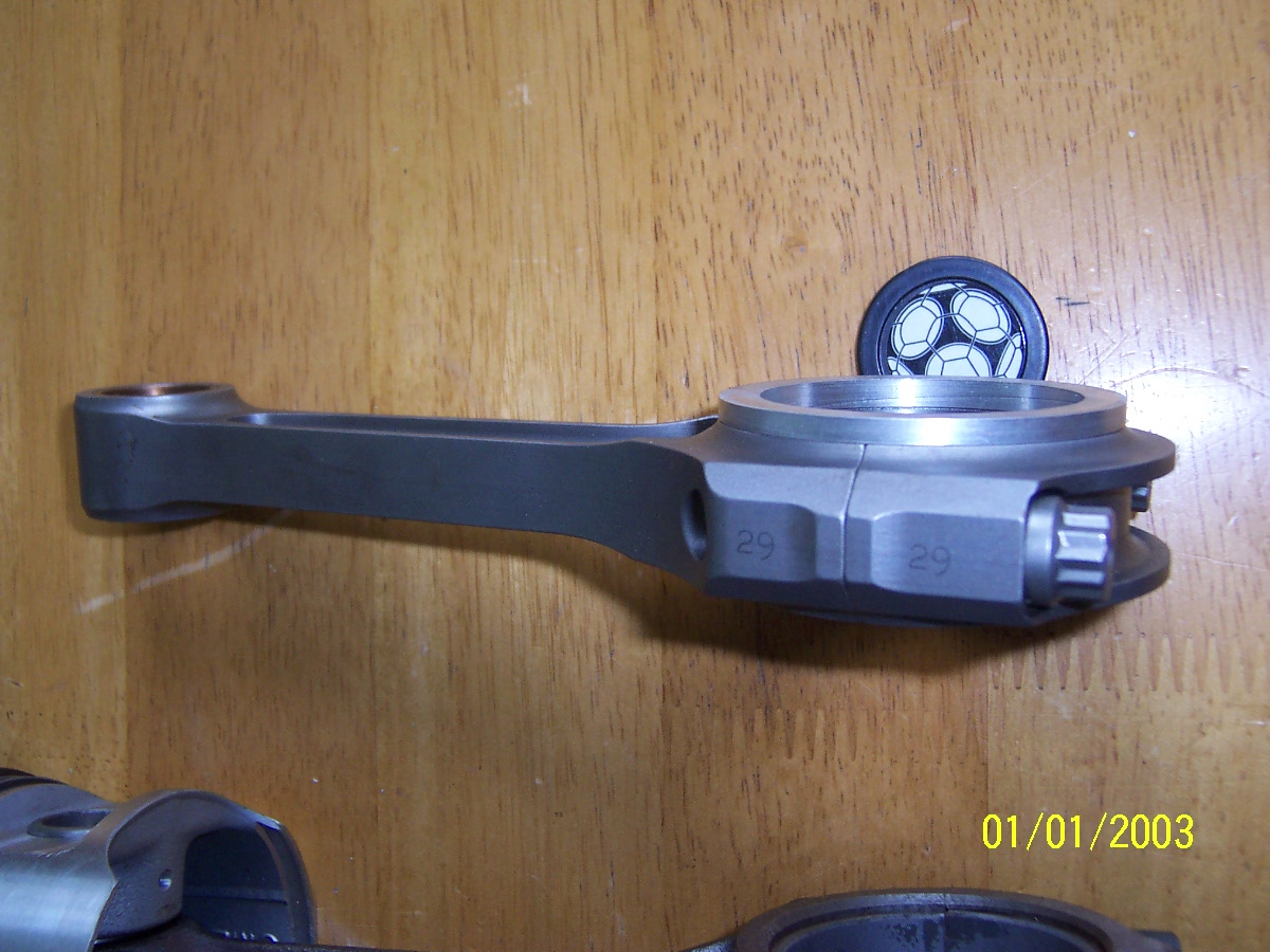

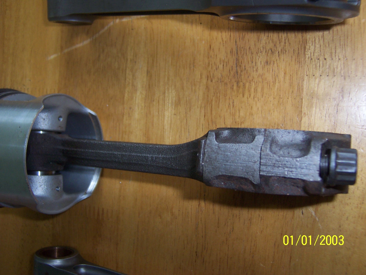

Here are a few pics of my Ebay rods.
As you can see from the pics they are symmetrical and at first glance they appear to be a non starter.
What I plan to do is to use an ally spacer on one side of the big end to give the required offset at the crank end. These will be fixed to the rod and cap with 3 off 2mm Csk set screws.
The little end should be OK with just one side machined down by 1mm.
It will mean that the rod shank is running offset to the piston centre line by 1.5 - 2.0mm (Do you think this may be a problem)
The rods are bushed and the pistons I am using are Omegas which have large flats on either side. will PTFE buttons be OK to locate the pins or should I put circlip grooves in the piston?
Would a press fit pin be OK if the bush is left in place as an alternative?
How much side clearance between rod little end and piston boss is advisable to allow for crank flex?
I think any input on these questions could prove very useful if alternative rods are to be found and used.
These rods are german made and were bought from ebay for £30 +p&p. No sizes were given and as i work on a few different motors I took a flyer and bought them.
They turned out to be spot on for length, 004" under on big end dia & 012" under on little end dia. Lucky or what!
I contacted the manufacturer to find out there original application but unfortunatly they turned out to be arrogant and totally un cooperative.
I did a little research at the time and the closest match came from a BMW car engine.(cant remember which).
Regards
Dave
Regards
Dave
Would aluminium be a suitable material for the spacer ?
What about Tig-ing a suitable piece of steel to the side of the rod cap ?
Although I guess that might muck up the balance more...

danboy
715 Posts
Member #: 1381
Stevie,
I cant see that there is any significant side load on the spacer and it will be swilling in oil which should help.
Time will tell
Regards
Dave
