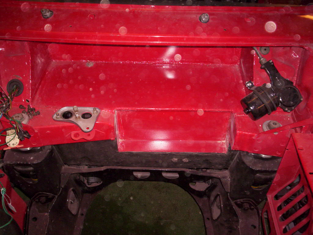

OK Shane here we go.
In the attached picture the following are the dimensions in mm.
Master cyl silver plate to top Left hand corner of turbo bulkhad box is 40mm
Widest point of subframe tower ( it's curved) to bottom Left Hand corner of turbo bulkhead box is 210 mm.
From bottom of Turbo bulkhead box to centre section of sub frame (parallel to turbo box) is 70 mm.
I have done all dimensions from the brake/clutch master cyl side as there may be differences on the other side due to different actuator installations.
Sorry there is a carb air box compartment as well as the turbo box,
I think I may be Bi- sexual
Hope this helps, If not get back to me.
Regards
Dave
Sorry about the picture quality!
Edited by danboy on 3rd May, 2007.

Right then how does this look? Managed to get out in the garage for an hour this aternoon for a little tinker, have marked out where the box locates (thanks for the measurements Dave) does it look about right.
Also Dave could you do me the favour of next time your with your car, could you measure from either side of the box to the centres of the subframe tower bolts please!
Many thanks
Shane.

OK Shane here are the dimensions you want.
Drivers side bolt c/l to box is 290mm.
Passenger side bolt c/l to box is 110mm.
Should be accurate to within a couple of mm.
I think the box I used was an Avonbar one although I can't be sure as it came in a job lot.
It does look different to yours but you should be able to figure where it needs to be from the info you now have.
Regards
Dave

Those measurements are as near to f**k is swearing!!!! Im pretty much spot on! Cheers for doing that dave really appreciate it fella!
