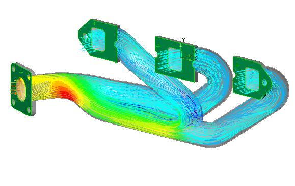

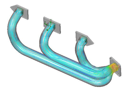

B178PEX
8 Posts
Member #: 1377
sheffield uk
hi again if anyone is interested these are a couple of my current designs, would appreciate any feedback
cheers luke
Edited by B178PEX on 2nd May, 2007.
Alex1340
902 Posts
Member #: 111
Loughborough
dout the turbo will fit like that will it? most people have the shaft of the turbo at 90deg to the block.
As Alex says, having the turbo mounted at that angle isn't good. It makes the exhaust point the wrong way and the air inlet point towards the block.
What about cars with servos? Are you planning it to fit these?
Wil
www.twin-turbo.co.uk
Alex1340
902 Posts
Member #: 111
Loughborough
Surely there isn't away of fitting the turbo above the flywheel housing and a break servo, well not the late type servo maybe a remote servo.... would be tricky. put the turbo on top of the bonnet, loads of space there!
It is a bit tight. It may be possible though.
But this is wht the Mirage manifold is such a great design!
