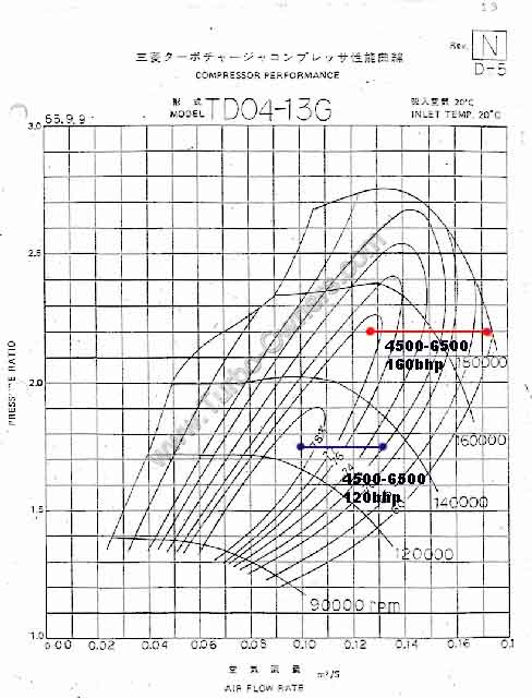

Anyway had a look calculating what turbo would suit my 1330. I will say that you were right RogerM, there’s a bit more to it than I originally thought.
I'm planning at first to run it at +-8.5psi boost to produce around 120bhp at the flywheel, well that’s what the maths said, and it does seem about right for a intercooled system.
Some time in the future thou with many gearbox upgrades, I'd like to get some 160 bananas (which came out at being +- 15psi boost) out of the system for short periods of fun *happy*, so will need a turbo to be able to cope with that as well.

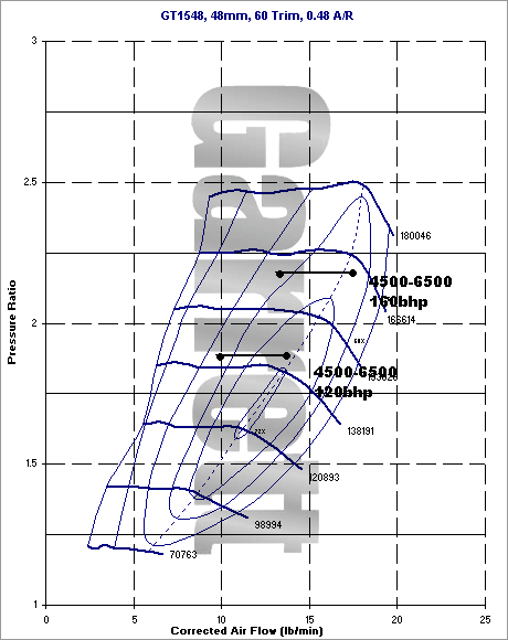

I know that I can get the TD04 13g and GT1548 turbo locally, but it seems the TD04 would be a little close to "choking" trying to produce the 160bhp. Would this be fine? Or would I need something bigger? The GT1548 would produce its power more near the top of the engines rev range.

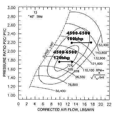

Just for interest sake I also plotted my engine on the T3 40-trim(Correct me if I’m wrong, but I think that was the std metro turbo unit). I was quite surprised how similar it performs to the other "much smaller turbo's", and its A/R doesn’t seem much different either.
Did add the three compressor maps to show where the engine lies. I guestamated a few areas thou, one being where the engine produces max power and peak torque.
Would like your guys opinions on what you think, and maybe if I went wrong anywhere.
/Greg

I would recommend the TD04 based on your requirements.
OK, so it's close to the choke line at 6500rpm, but how often are you going to get there? It's great at 4500rpm where you will want peak torque.
The other thing to consider is the compressor efficiency. The TD04 is at 78% peak and the others are only 72%. That means that you will get more into your engine at a given boost, assuming the same intercooler efficiency for all.

td04 is best one , though your points are on the high side, so you are comfortable with it at 160bhp .

well an aseries is around 0.42 bsfc at peak torque and grow to around 0.50 at peak bhp.that's give around 16,5 lb/m
you've plotted them at 17.5
replot your 13g map, you'll see that your ok at 160bhp,
cheers
