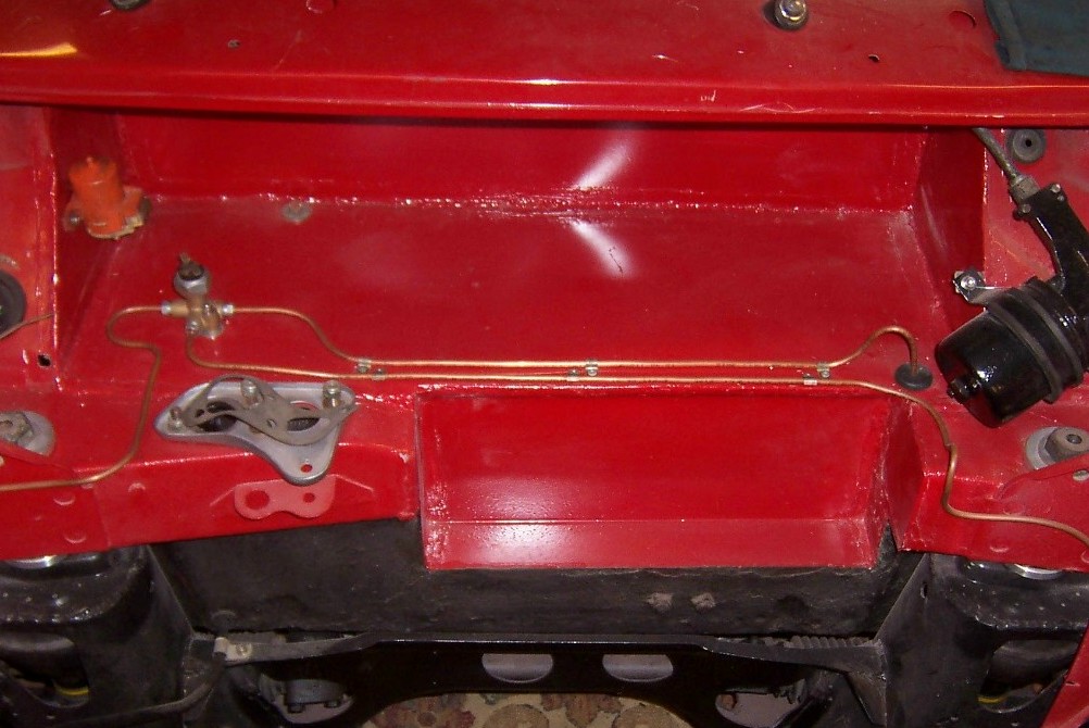

heres mine, made it myself 1.5mm thick sheet seem welded.
Edited by Monster22 on 31st Jul, 2007.
I'm worrying about that corner on the right sticking out buddy. I've a fair suspiscion that the air intake pipe won't get past that.
Heres Mine Also made it myself
Monster22
428 Posts
Member #: 39
Thanks Tom, will bolt the subframe in tonight and hang the engine in place :( thought I'd got it right, never mind. Have to get the electric glue gun out Thanks for the spot.

on this subject & slightly off it, would you guys think it a problem to have a turbo box & a weber box (or should i say upsidedown battery box) structually speaking, my welding is pretty good on the mig & i nkow jimters & 1573wx's minis have the whole thing cut out in the top firewall area, anyway you lads of experiance know what i mean, cheers chaps, good to see some bulkhead box pis so i know where to pop it in, got a better idea now! ths enquiey is cause i'm welding my dads van bk 2gether!!!!
danboy
715 Posts
Member #: 1381
Like this?
regards
Dave
stefaz
1252 Posts
Member #: 1656
stoke-on-trent
i have both in mine mate - meant i could change the heat shield without undoing manifold nuts

fooookin heck! everyone on here has very big weber box's lol!
thats ok then if its stuctually ok to do!
my dads minivan will e running a weber & i gotta weld the weber box/upsidedown battery box in it & i think he may go the turbo route eventually so gonna put the two box's in, saves greaf & its space thats needed anyhow! not sure where to place the weber box yet but looking at these pics i may get him to purchase another batterybox & weld two 2gether for a double, like danboys for instance! looks cracking, if anyone has a pic of a lill weber box (battery-box size) that would be ace!

715 Posts
Member #: 1381
CMF, The reson i did a large airbox was to be able to fit a cold airbox system when running NatAsp, it's also very useful to fit other ancilliaries out of the way. ie fuel filter, washer bottle etc. etc.
Worth doing in my opinion.
