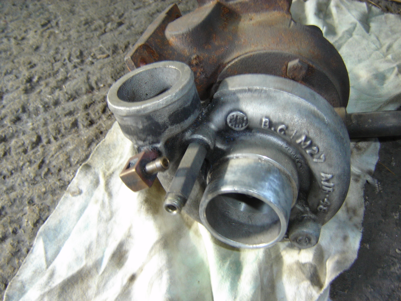

Could anybody tell me what these two pipe connections are for? Do they need to be blanked? Cheers
Which?
One is the main turbo inlet, the other is the compressor outlet. The small ones are used for take offs for the wastegate actuator etc.

The two smaller pipes, have been told i can blank them off? is this correct? Thanks
4642 Posts
Blank off the hexagonal connection, and connect the brass fitting to you actuator.
