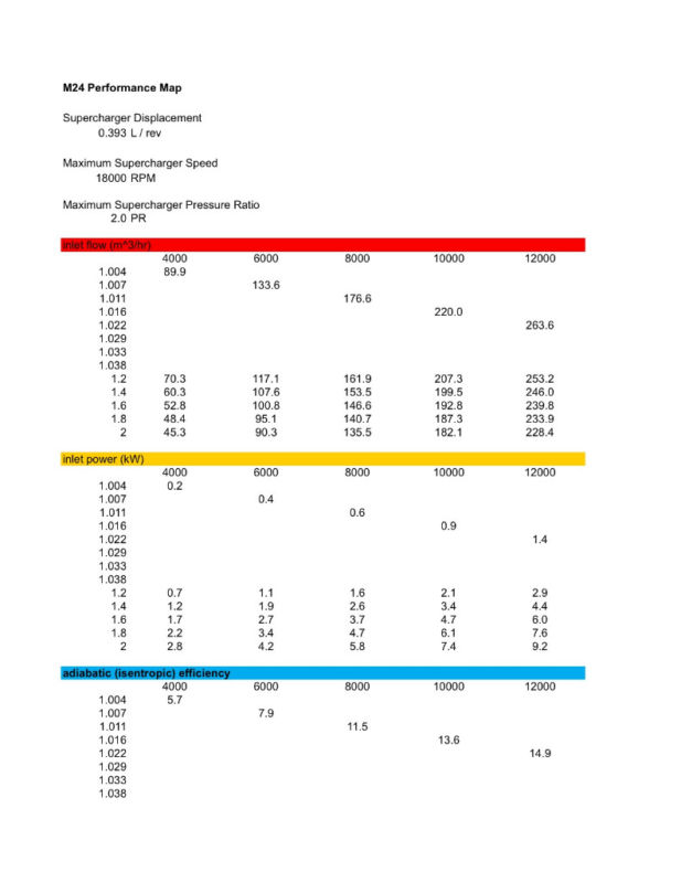

Has anyone ever seen a compressor map for an Eaton M24 Supercharger?

From what i have managed to find on this supercharger it is designed to be used on engine between 800 - 1000 cc but i havent found much else other than that
The only info I have is as follows:
Swept volume - 24 cu ins, 400 cc
Max speed - 15000 rpm
So at a 2:1 drive ratio it will provide around 9psi of boost on a 998.
Good for 100hp with a decent intercooler.
Now just need to convince Sturgeo that he needs one on his car. He can then pay for the one I've just bought on ebay!

3 years later but maybe it helps
Kompressor:
Modell: EATON M24 Supercharger
weight: 4,8 kg
cc per revolution: 0,390 Liter
max. pressure ratio: 2,0 Bar
Max. RPM 17.000 (18.000)
pumps at highest rpm at 1,8 Bar so about 13psi: 380 m³ / h
Edited by mymedusa on 8th Nov, 2010.

Interesting though Paul. for 110 bhp you're off the top of the map (2.1 PR 300m^3/hr
www.twin-turbo.co.uk
Yes, superchargers really are crap at anything more than 5-10psi boost.
I can't understand why anyone would want to use one, but then not a lot of people understand the map.
That's a bit of a generalisation Paul. Might be farer to say Eaten M24s and M45s are not very efficient in our application.

Totally agree paul, also look at the kW required to drive it, that's all power gone from the engine.

No, that was with a M45 and a GT17 in series, both running a 1.6 ish pressure ratio and both running at max efficiency. I came to my senses when I realised that a single turbo would do a better job.
The problem is not limited to Eaton blowers, it a function of the roots blower design that most use.

Thanks for that efficiency map. I couldn't find one anywhere. I have one from a Golf tsi which was to be used on a Reliant 850, now an imp 875 which driven at 1.98 x engine speeds looks like it will be quite efficient (for an eaton!)

Anyone fancy explaining that map up there for someone that has absolutely no idea what hes looking at???
This makes good reading http://www.turbobygarrett.com/turbobygarre...bo_tech103.html
that map contains lots of info, but the most intersting is the green squiggly lines. these are the efficiency curves (the higher the efficiency the less heat is put into the charge).
Y axis is boost (in pressure ratio) x axis is flow.
From the link above you can calculate what flow rate and boost you need to make your desired power. then plot this onto the map to see what efficiency the compressor will be running.
The other lines show power consumption and rotor speed.
