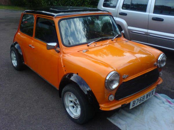

I have attached a picture of my mini too, this was before the supercharger was fitted (it now doesnt fit under the bonnet properly!)
