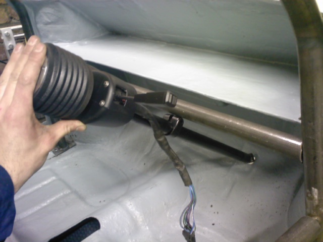

As title really, how have you mounted them (using standard mini column) Pics and ideas please.

Obviously not exactly like that but you could use the rose joint or weld it to cage if you have a dash bar.

Cheers Rick, I was thinking more along the lines of a bracket fixed to the dash bar similar to what is usually mounted to the lower dash rail (which I dont actually have)

Back on tpoic! lol! Im thinking of fabricating up a bracket similar ti what V posted, Going to have to get some seats on order now and fit the pedal box to get an idea of position, joy! now, am I better to bolt this to the dash bar (as this is how it mounts to the dash rail usually) or weld it to the dash bar?

I actually welded the bracket for the column to mount on in Vegards car for him. We welded it to the bar, but did just stitch it and did not seam weld it to the bar.
