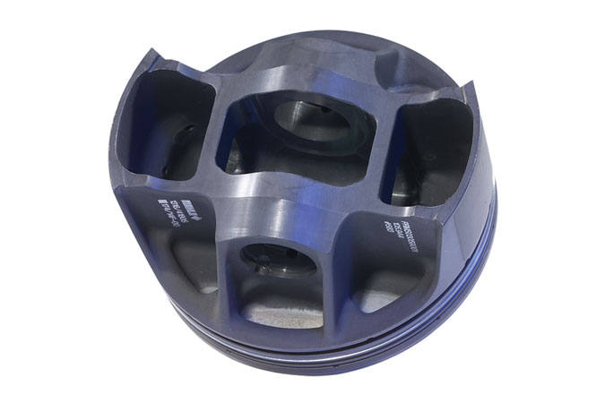

If you really must design your own , a version of this one would probably have the best specific performance (strength/weight ratio) when fully optimised
(if there is no pic attached then do a google image search for 'Mahle box piston)

I've got a set of Hypatecs sitting beside me! *tongue* *wink*
Good point I guess, If it ain't broke don't fix it...
EDIT: That's like what I was thinking... when do you see a piston like that for a smallbore!?

SHort skirtless pistons like that are good for high revving, short stroke motors.
The longer the stroke, the bigger the skirt IMO, to stop the piston rocking about in the bore.
