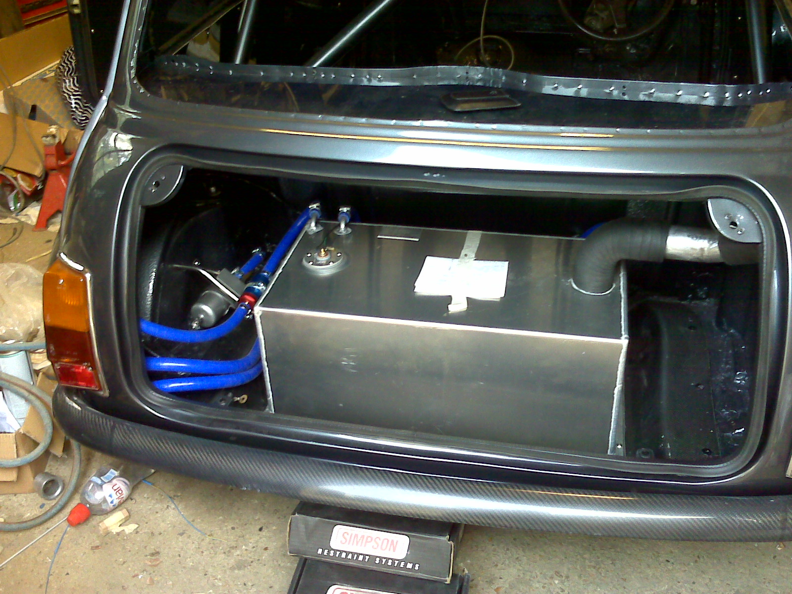

Well after many years and a lot of money...i am nearing the end of my project. hope you look the car. Yes it is road legal!

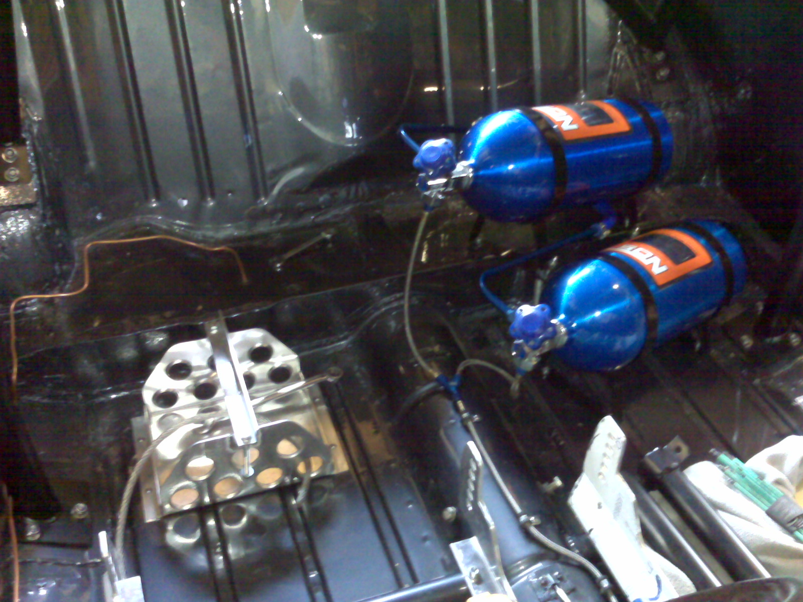

does your car run mainly on nitrous or do you blend in som petrol

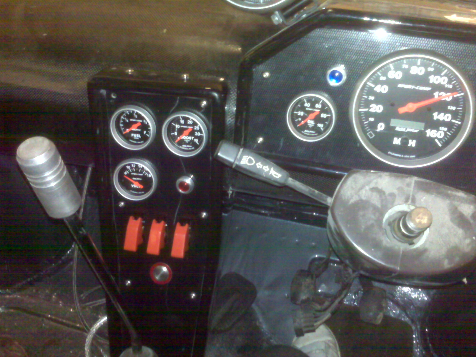

No steering wheel, and 120 mph!, your braver than me!!

Right, i'll try and think of the spec list, but will probably miss something out....
Engine.....
1293 with forged pistons 16cc dish, blanced and lightened rods crank etc, arp bolts through out, 266/276 cam (can't really remember) cometic head gasket, lightend cam followers and push rods, 11 stud med head 36, 31 with 30cc chambers, full roller rockers. metro turbo fuel system. fairly standard carb just with different needles etc. t25 turbo on a t3 manifold. custom exhaust system. intercooler, oil cooler, remote oil filter housing, kybota alternator, mini coil pack, catch tank etc, all samco housing inc fuel.

Kad 6 pots up front on 8.3" disks, Kad rear brakes, bias adjuster, Kad aluminium rear arms with coilovers. lightened and seam welded rear subframe. rose jointed bottom arms. Mb racing wheels with a032r.

Omex distribuless ignition fully mapable. Nitrous controller fully mapable, boost controller from grddy e01 fully mapable as well.
