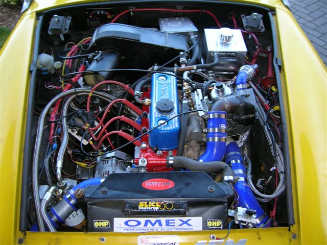

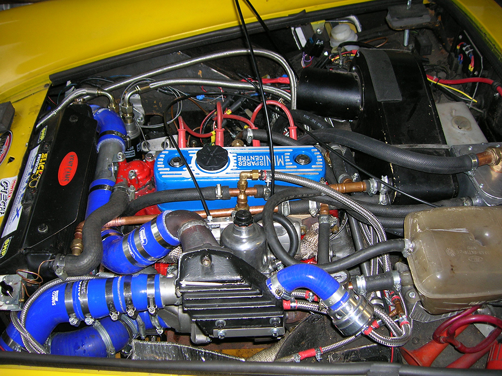

Finally got it back on the road.Winter work included:

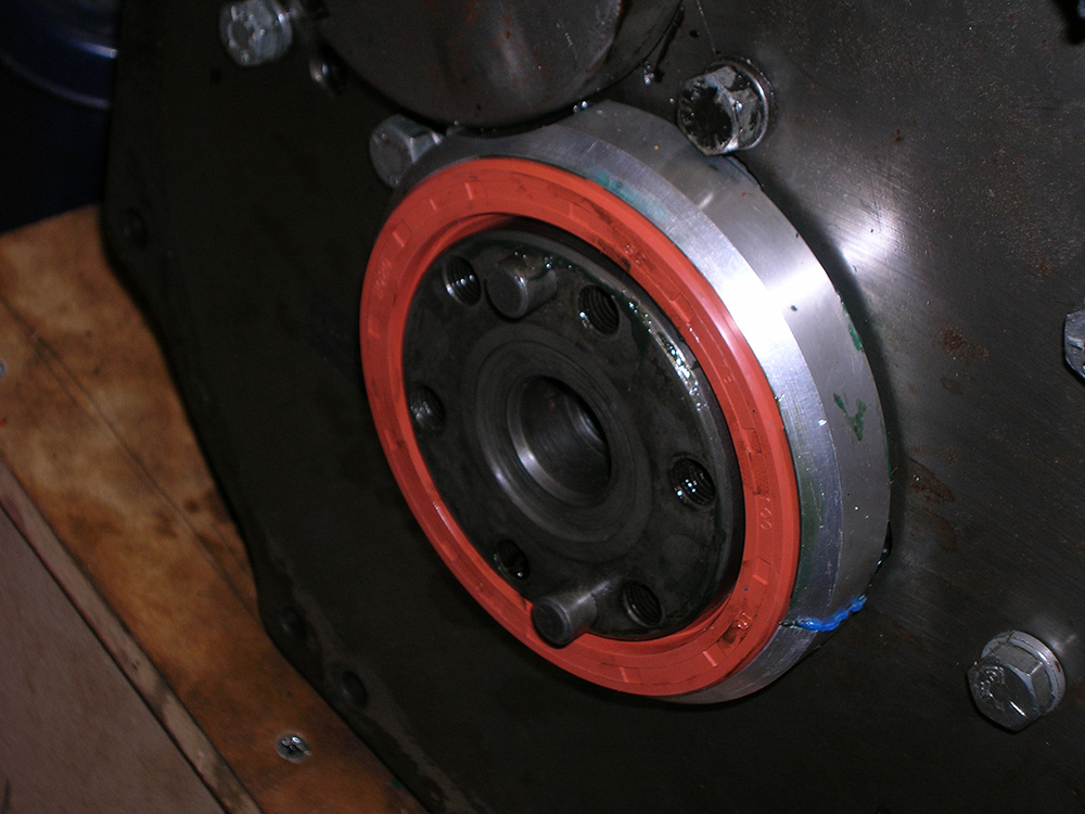

New rear oil seal set up (and a bigger driptray!)
Oil pressure adjuster-now 55psi max cold,45psi hot
1.5 roller rockers and a new top cover to clear them
AEM wideband-12.5 afr at full boost (17psi)

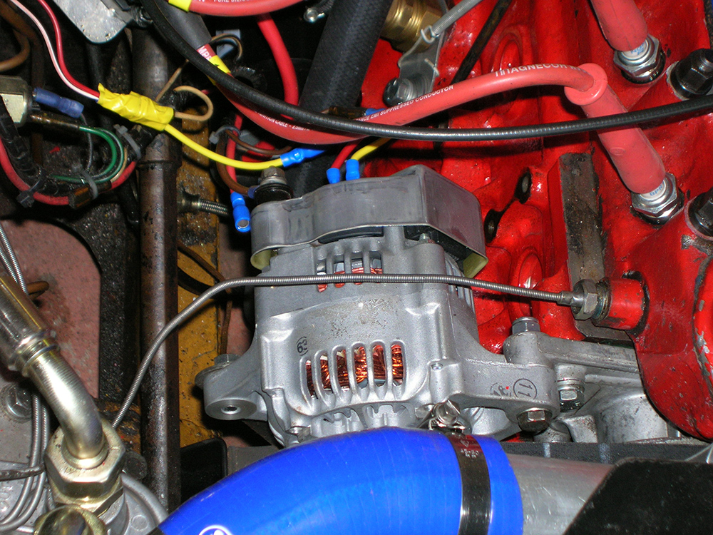

Japanese alternator-so far the belt stays on!

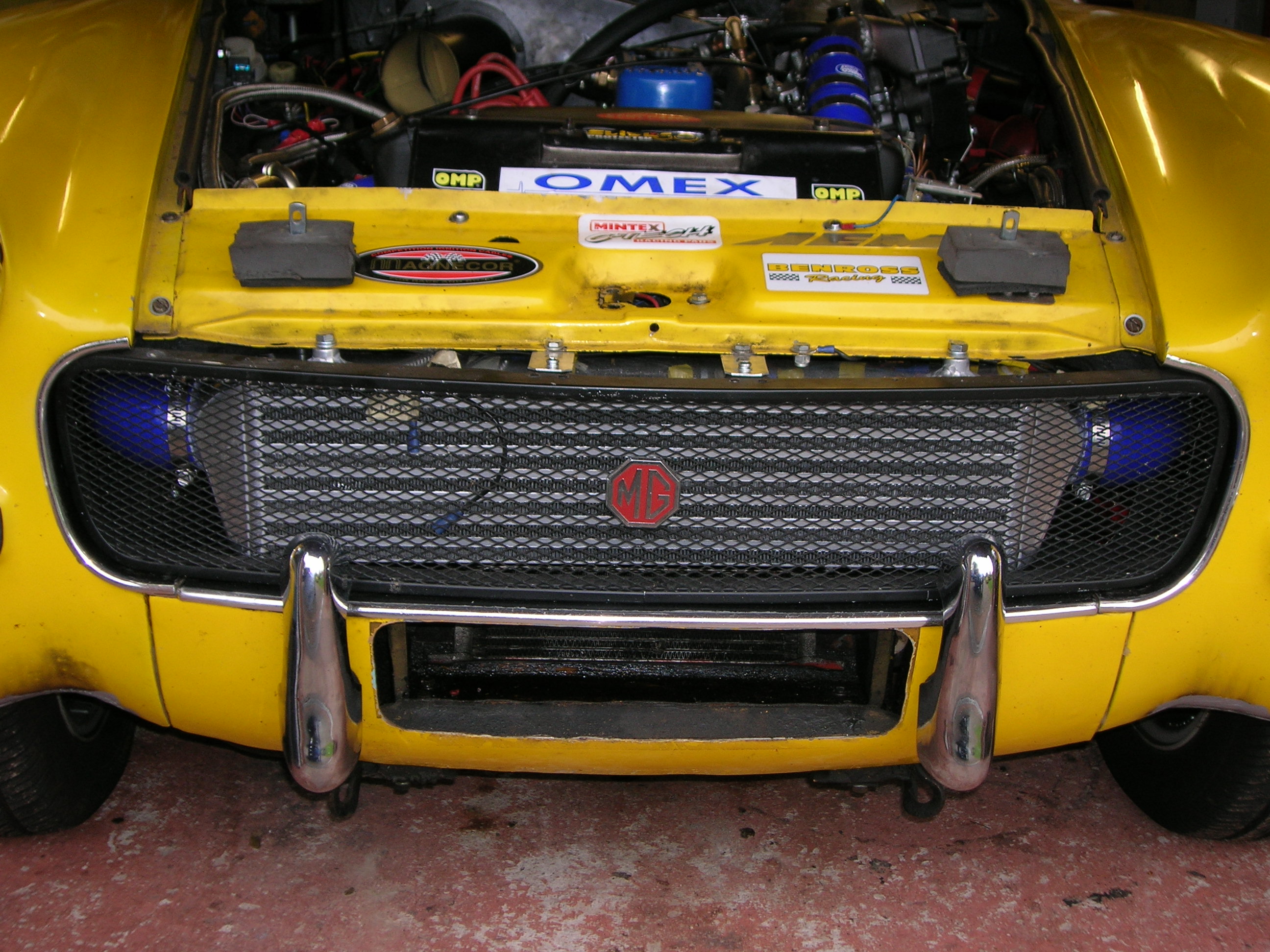

BIG intercooler and pipework-ebay shop item
New 4 core radiator-it cools now!
Pictures of this lot below (I hope!)and in my photographs
'Where does the engine go?'
bet that will honk on a bit !

That intercooler fitting looks great!

Robert,boost comes on around 4000.then it's like the original starship Enterprise shifting to warp speed.Hope to get some RR numbers soon.

gosh that seems high steve ,what turbo is it ?

A rebuilt T3 from Avonbar.From recent posts I suspect the turbine is too big-an RS turbo one?

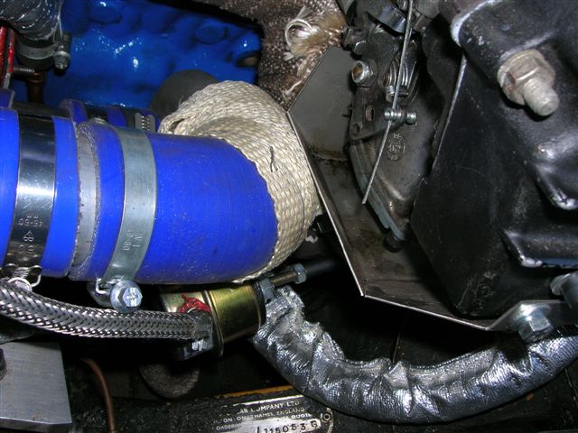

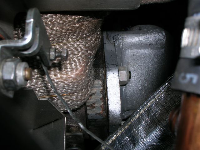

After last year's disaster with a blown engine I've rebuilt with Accralite forged pistons giving 8:1 CR.Then over Winter I,ve fitted a T2.Different challenge on an in-line engine,lots of room along side,none at the back.Also wanted to keep T3 elbow/exhaust pipe interface.Anyway,I moved the compressor outlet round and re-tapped it for the actuator bracket (modified).Used a sandwich plate on the turbine outlet and welded a T3 elbow to a second plate.BENROSS worked his fettling magic on this and it came together quite well.All the usual hassles on water/oil feeds and lots of insulation where the air pipe and exhaust manifold are VERY close.Now have to run in and set up on RR.

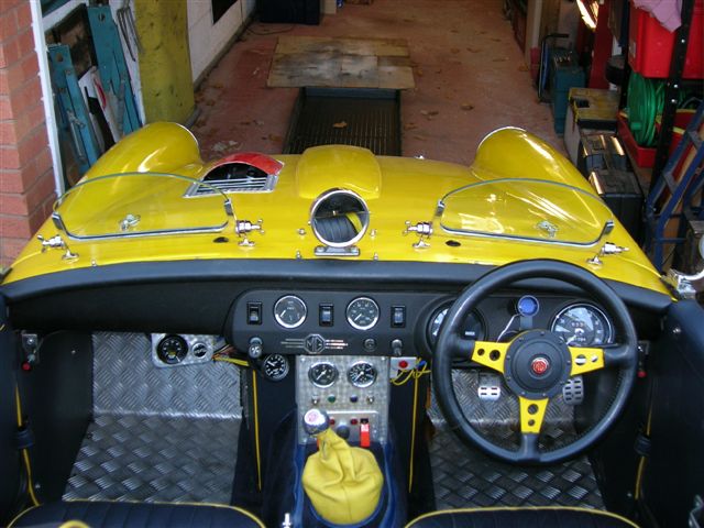

Also decided to increase the in-car ventilation (lol).See pictures above.

Just running in on 5psi boost now,but later 15psi.the head is quite trick,the T2 has a larger compressor,like a Tomcat,Megajolt,so your guess is better than mine!

Let us know how the oil seal holds out.
