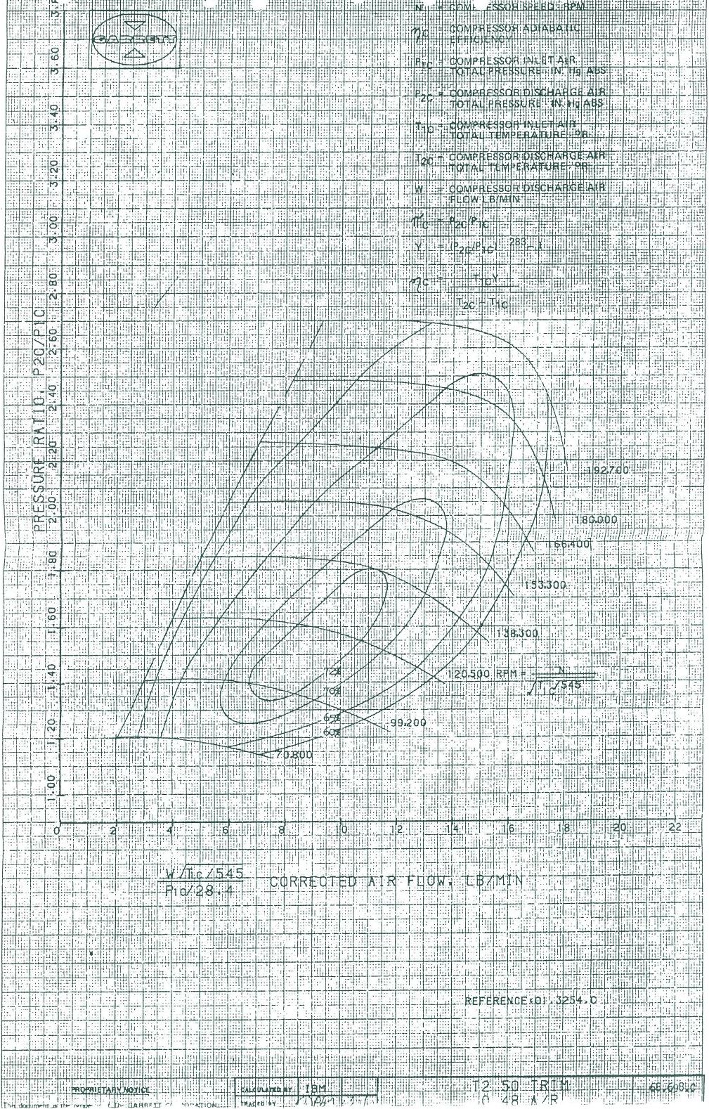

Not sure if one has been posted- haven't seen one, but I found this link which seems to have a map of a Garrett T2 turbo.
Page 42 of the PDF document shows the map.

I've looked at this file and can't see a map, not on page 42 anyway.
I have a T2 map, but was given it on the understanding that it stayd mine, so it has. Pointless telling you really, but it makes me feel special.

There is actually a map inside the thesis.
Seen it now, dosen't look like the one I have

image page 29
pdf page 42

Is your map measured in lb's per minute, lbs per second or CFM?

lbs per min

did any one happen to save the map for the T2, seems to be harder to find than area 51 lol

I'm sure wil can put it on the board now that the gt1752 one hbave succeded in interest, if he don't i'll look in the hd of my old scrapped computer, you can also PM Tdave he 's the only one to have found it.
