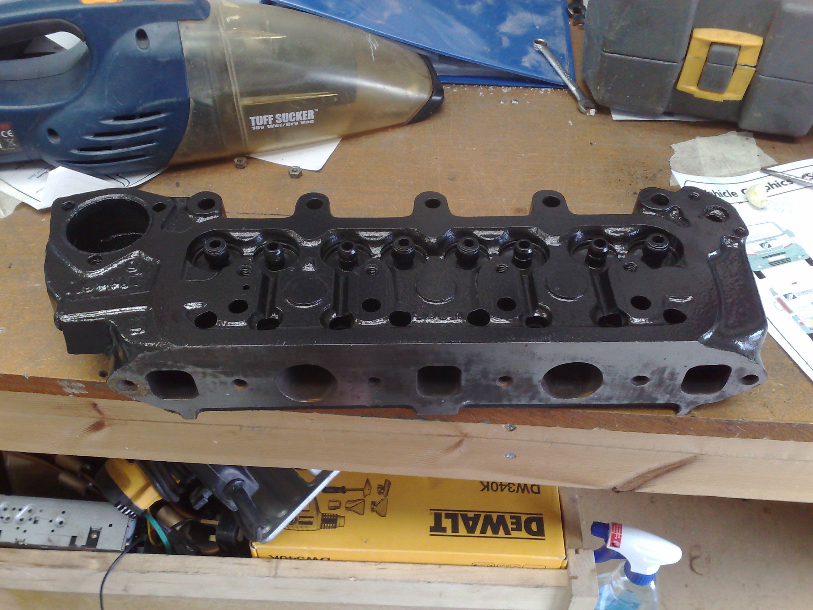

Just thought i'd post up some pics of what i'm doing to my old stage 4 head, I should have taken a before picture, but hind site is a wonderfull thing.

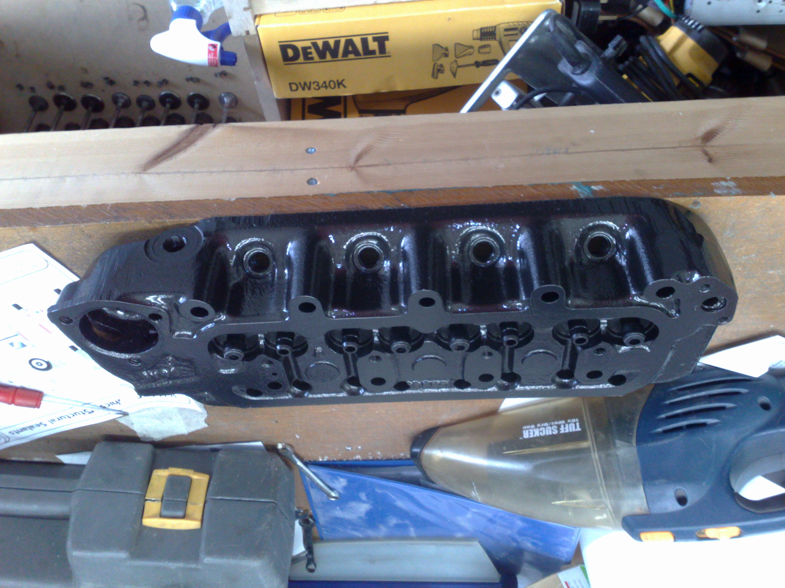

Anyway, it was about 3 different colours and I took it right back to the metal and masked off the important bits and took all the valves out and proceded to paint it, loads of nice thick coats.
Just need to polish the inlets and outlets to make them shiny again and put it all back together with the new double springs and it'll be ready for ebay, lol.
What do you reckon?

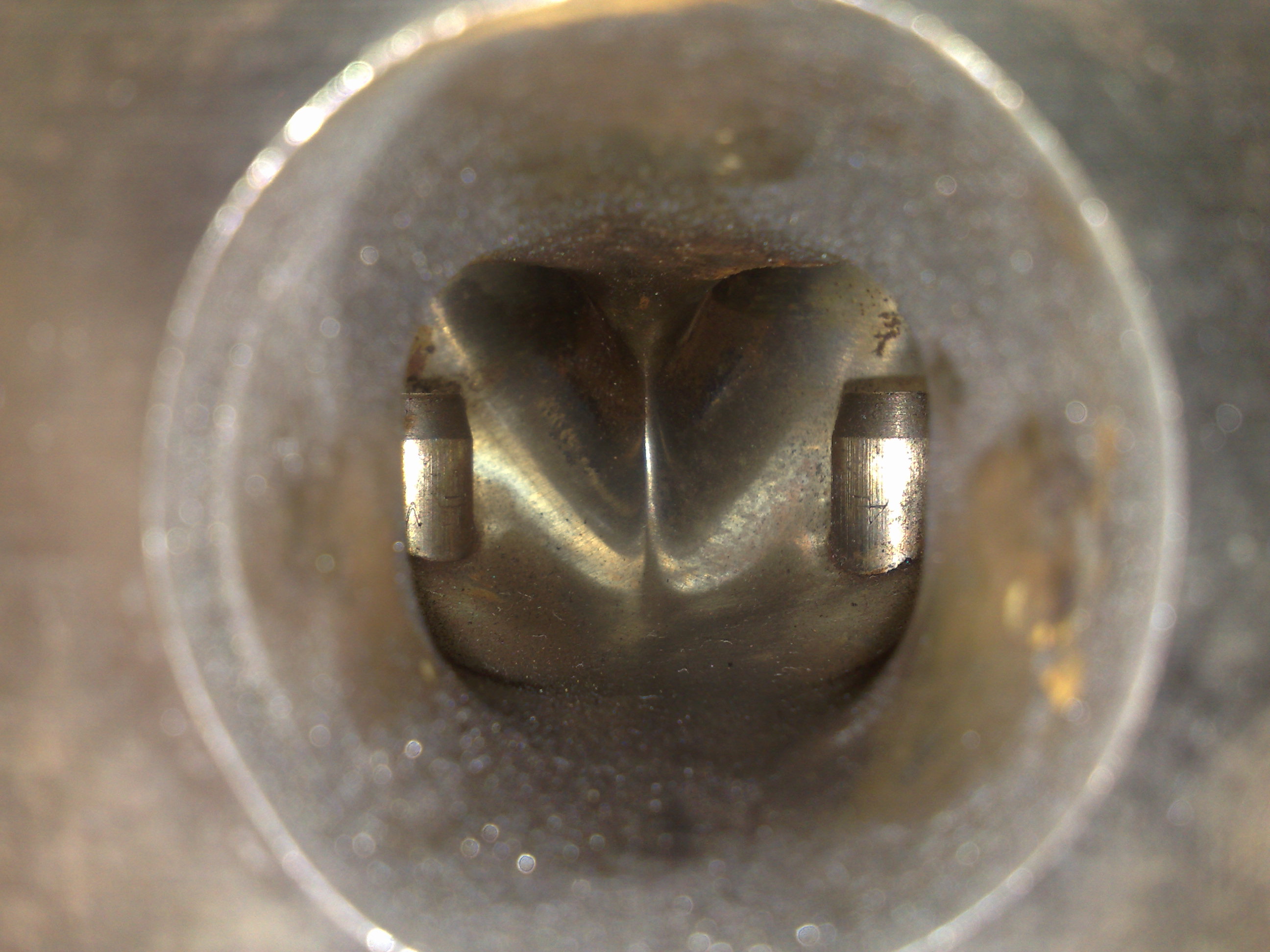

What happened to chamber no.2?

The valve came off the stem at around 7000rpm and must have bounced around a bit before lodging itself firmly in the piston, i'm going to grind it smooth, luckily there is no damage to the valve seat.

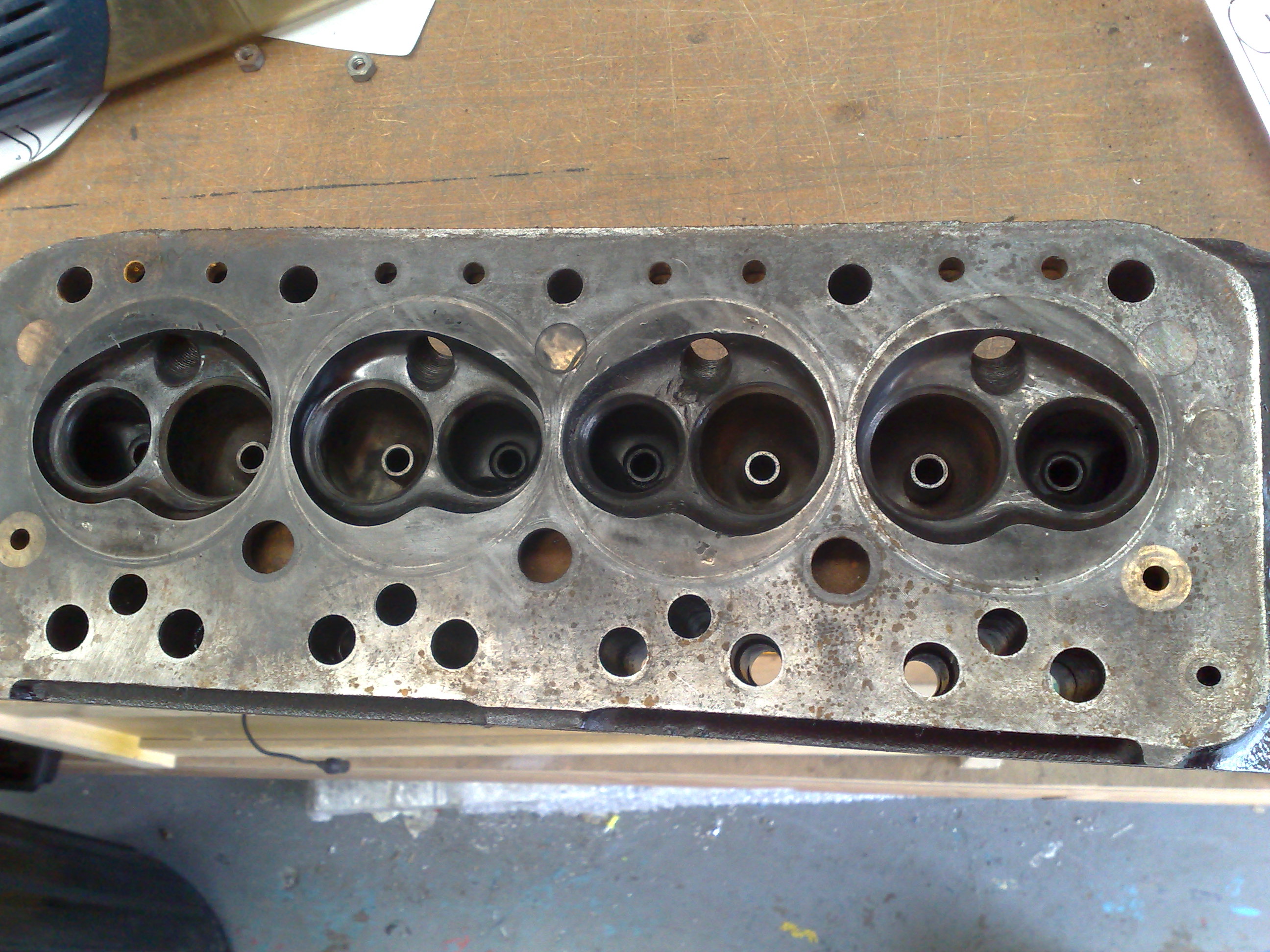

At least have the valve seats recut, they look rubbish. Also, polishing the inlets is NOT a good idea. Exhaust ports OK, but even there a waste of time. Remove the exh valve guides and have that area properly ported instead.

I agree the seats look crap in the photo, but they are actually quite good, as for polishing I was only going to take off any surface rust and clean it up a bit to make it look more appealing on flea bay, I don't want to spend any money or un-needed time on it.

They're not good. They're wide with no radius!

the seats from this chamber (damaged one ) are too close the valve didn't drop of the stem, the other valve have pushed it , look at it closely three others are ok but number two is a big fish in the bocal
