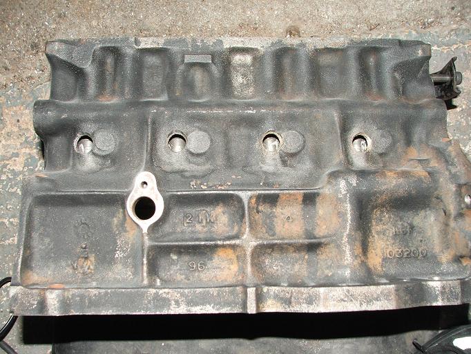

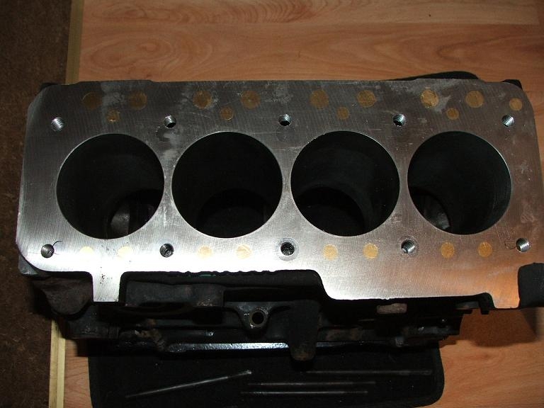

MPi block. Deck completely plugged off for dry deck head assembly, using brass plugs and steel where new stud holes intersect. All new stud locations now have plugs fitted to ensure perfect full form threads.
Offset bored to line up cylinders perfectly center to center with the BMW head. Stud holes drilled and tapped to move the head forward on the block to line up the combustion chambers centrally over the cylinders. All that done on CNC to CAD drawings, so Perfect!
Steel liners fitted to return bore to standard 70.61mm and 1275cc.
Block skimmed so pistons sit flush with the deck.

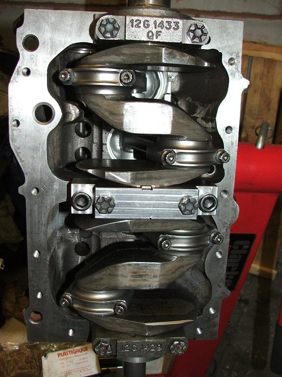

Four bolt main cap fitted, line bored and honed.
Crank case machined for clearance of steel h section conrods.

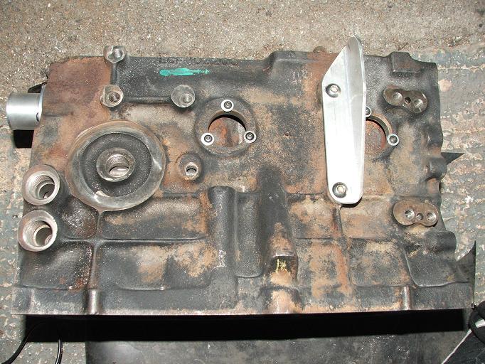

Under crown piston oil cooling jets fitted.
Core plugs have 'safety' retention screws fitted, Probibly not nescisary but it looks cool *tongue*
Holes drilled and tapped into old tappet chest for oil drains for both head and the turbo in the very near future
Engine/ Gearbox bolts enlarged to M8.
Head modified as per normal plus all coolant passages welded up for dry deck assembly, adapters welded on back end for coolant and oil drain
Crankshaft Wedged, Bladed, cross drilled, Toughened, balanced to the nth degree.
Steel h section conrods modified to give propper clearance on little end with pistons due to the offset bore.
