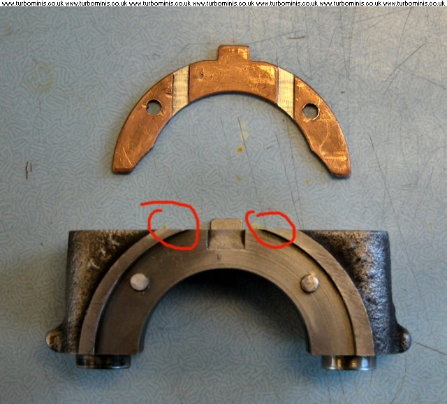

how different are small bore thrusts to large bore ones?
18th Nov, 2008 at 03:40:19pm

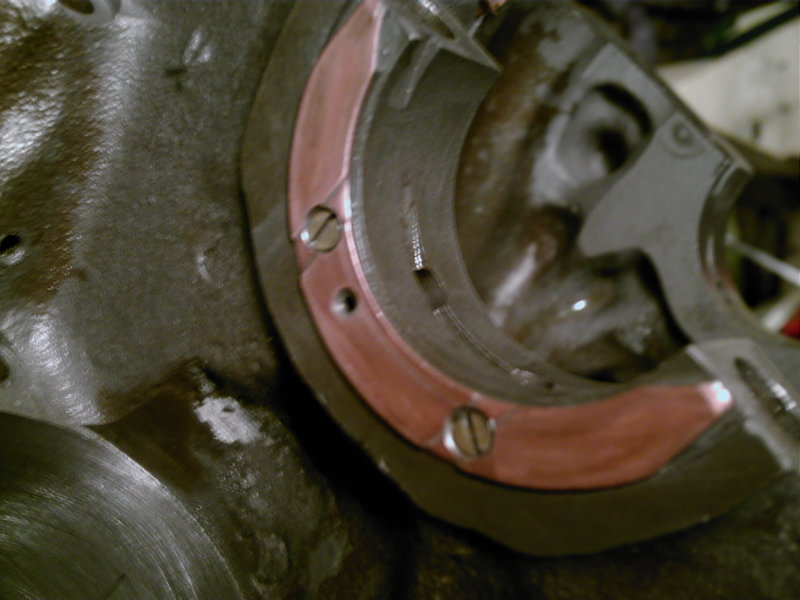

I'd deffo go with the screws if using 2 thrusts. This is because I'd rather any iol stays between the crank and thrust rather than between 2 thrusts.
18th Nov, 2008 at 03:42:52pm
On 18th Nov, 2008 mini13 said:
how different are small bore thrusts to large bore ones? there was somon on the vintage mini racing forum who was looking at doing thicker thrusts for putting S cranks into A blocks. The large bore thrusts are the same thickness but 1/4" bigger on the ID and 1/8" bigger on the OD. I would have thought that an S crank fitted an A block with standard parts. Saul Bellow - "A great deal of intelligence can be invested in ignorance when the need for illusion is deep."
18th Nov, 2008 at 03:45:15pm
On 18th Nov, 2008 wil_h said:
I'd deffo go with the screws if using 2 thrusts. This is because I'd rather any iol stays between the crank and thrust rather than between 2 thrusts. I can't see that using 2 thrusts screwed on would be a problem. Just a bit trickier to do. Don't fancy the idea of breaking a tap in a block that has had a few hundred quid spent on it
Edited by Paul S on 18th Nov, 2008. Saul Bellow - "A great deal of intelligence can be invested in ignorance when the need for illusion is deep."

Paul , claqmp the two parts together in a vice with soft jaws, the just run the tig along the outer edge using no filler rod, you would get no noticable distorsion if you leave it in the vice to cool |

I agree with Carl that an autogenous weld, performed clamped in a vice, is unlikely to create distortion enough to worry about, BUT, I would be concerned about the affect the heat of welding would have on the bond between the bearing material and the steel backing plate.

I'm hoping that a magnetic grinding table will pull through the bearing material. A good machine shop would put a couple of suitable thickness steel "plates" around the bearing when pulling the magnet through the non-magnetic material, to act as restraints/holders in case the grip isn't strong enough by itself. The magnets on a surface grinder mag table are incredibly strong though, especially if you know where to position things on the "snakey" line. Schrödinger's cat - so which one am I ??? |

Oselli have come back with a price of £90 which was less than I thought it would be. They would still need finishing to size on a surface grinder.

Why surface grinder, what about fly cut? I think the only way to hold them would be a magnetic table. Then a fly-cut would be a bit aggressive. Saul Bellow - "A great deal of intelligence can be invested in ignorance when the need for illusion is deep."

would it be possable to tack them to a piece of round bar and finish them in the lathe On 17th Feb, 2009 Rob H said:

Why surface grinder, what about fly cut? I think the only way to hold them would be a magnetic table. Then a fly-cut would be a bit aggressive. This is by FAR the easiest way! On 13th Jul, 2012 Ben H said:

Well, I think this might just work.
22nd Nov, 2008 at 04:48:43pm
just put the worst ones on the radiator end where thy won't take the clutch force. On 28th Aug, 2011 Kean said:
22nd Nov, 2008 at 04:50:56pm
On 22nd Nov, 2008 mini13 said:
just put the worst ones on the radiator end where thy won't take the clutch force. That's just what I was thinking. I might even just remove some of the bearing material where there are shrinkage cracks in the surface. Saul Bellow - "A great deal of intelligence can be invested in ignorance when the need for illusion is deep."
22nd Nov, 2008 at 04:52:25pm
yes, i agree, better remove it now than have it flake later. On 28th Aug, 2011 Kean said:
