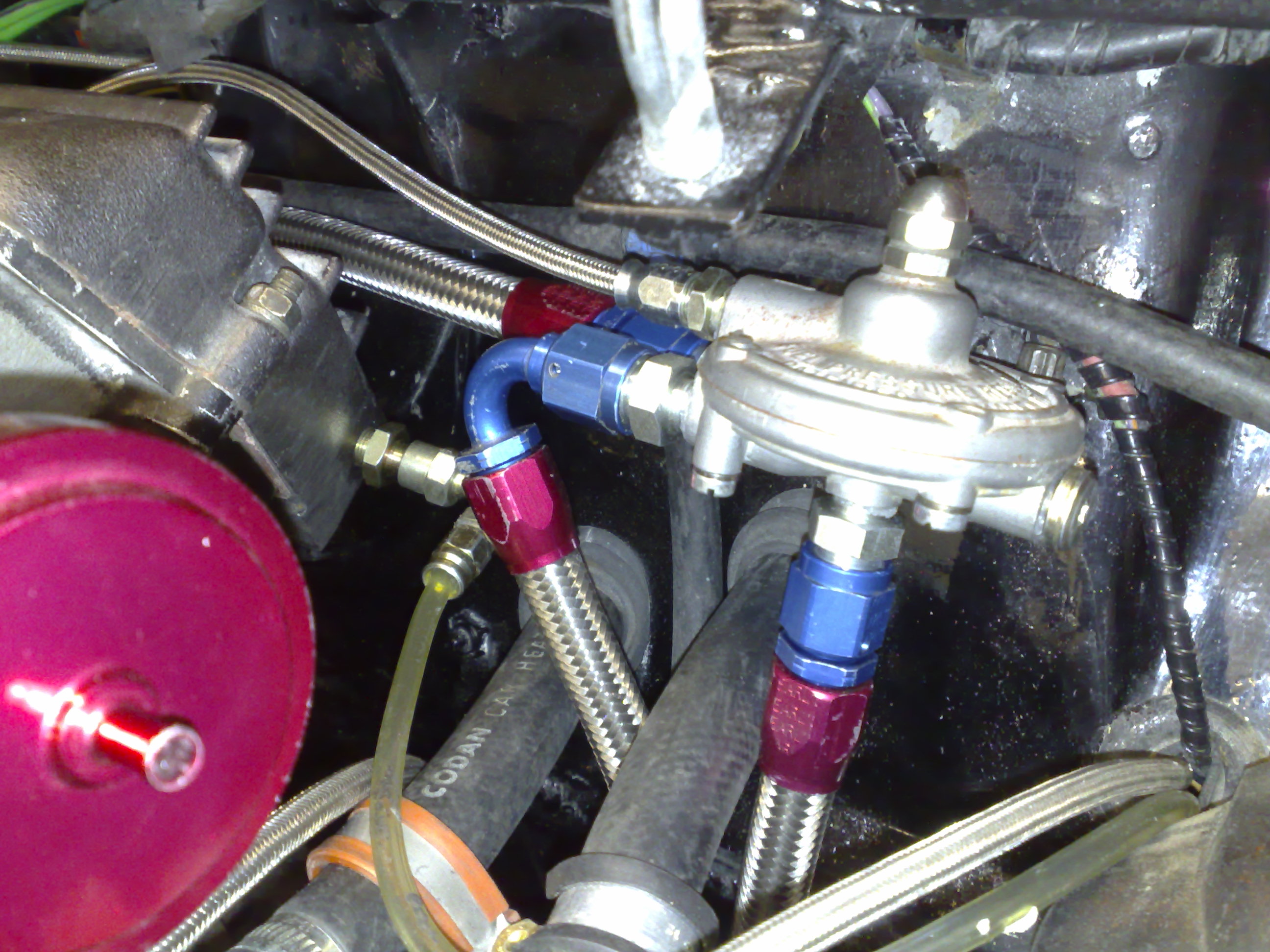

Drilled and tapped mine easy job. Never even considered buying an after market item.

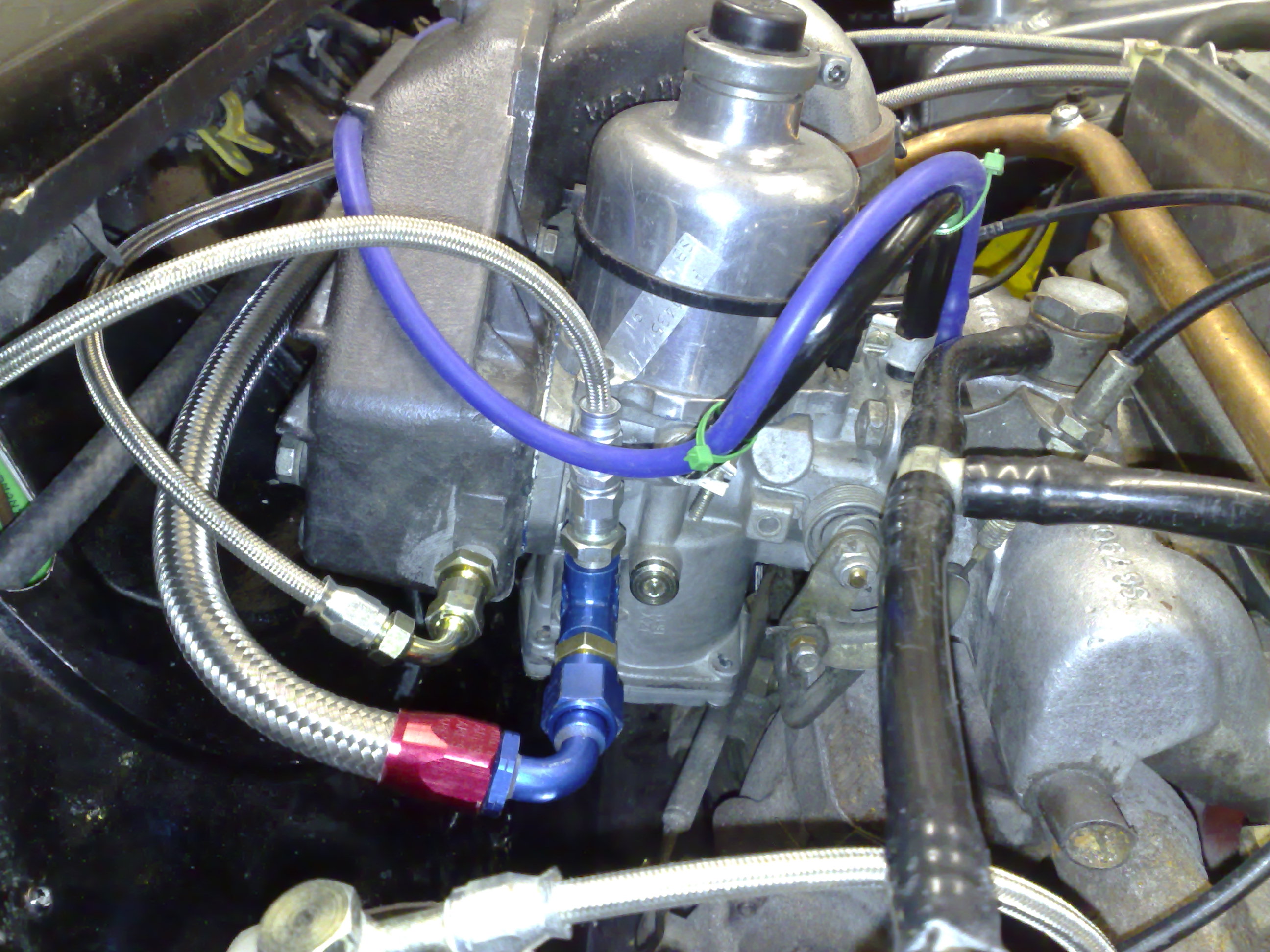

did the lot the fittings were1/8 BSPT AND 1/8 NPT I believe the tapping drill was 11/32
I will dig up the phone number of the company I got the parts from. Its on Queens road in Watford but I cant remember the name Custom Hoses possibly.
Own the day

Here is a list of the part numbers you can choose from to adapt your fuel regulator.
Blanking plugs
From Burnett Hillman:-
Plug +'O' ring seal 1/8" part No. BSPP 3869-02-SPG
Plug + Bonded 'O' ring seal 1/8" part No. BSPP 9025-02-SPG
Plug +'O' ring seal 10 x 1 part No. BSPP 3869-M10-SPG
From AIGNEP:-
SS 1/8 part No. 62315-1/8"
Ni plated brass 1/8" part No. ZV-10 (includes 'O' ring seal)
Adaptors
1/8 x1/8 part No. IB T0202
From AIGNEP:-
SS 1/8" part No. 62000-1/8
Ni plated brass BSPT-BSPT part No. DN10/10K
From HY FITT:-
1/8-1/8 BSPT-BSPT part No. 2025-1708
1/8-1/8 BSPP-NPTF part No. 2025-1633
GOODRICH anodised fittings
120 degree swept female 9/16 x 18 Part No. 236-12006
straight female 9/16 x 18 part No. 236-0106
90 degree swept female 9/16 x 18 part No. 236-9006
There are a lot of companies that will do the adaptors and blanks it would be a personal choice. I fitted SS steel through out.
I got my fittings from here:-
Custom Hose & Fitting
194 Queens Watford
phone:-01923 225534
And Here
hts
28-34 Latimer road
Luton
phone 01582 458405
Hope this helps those interested.
Own the day
