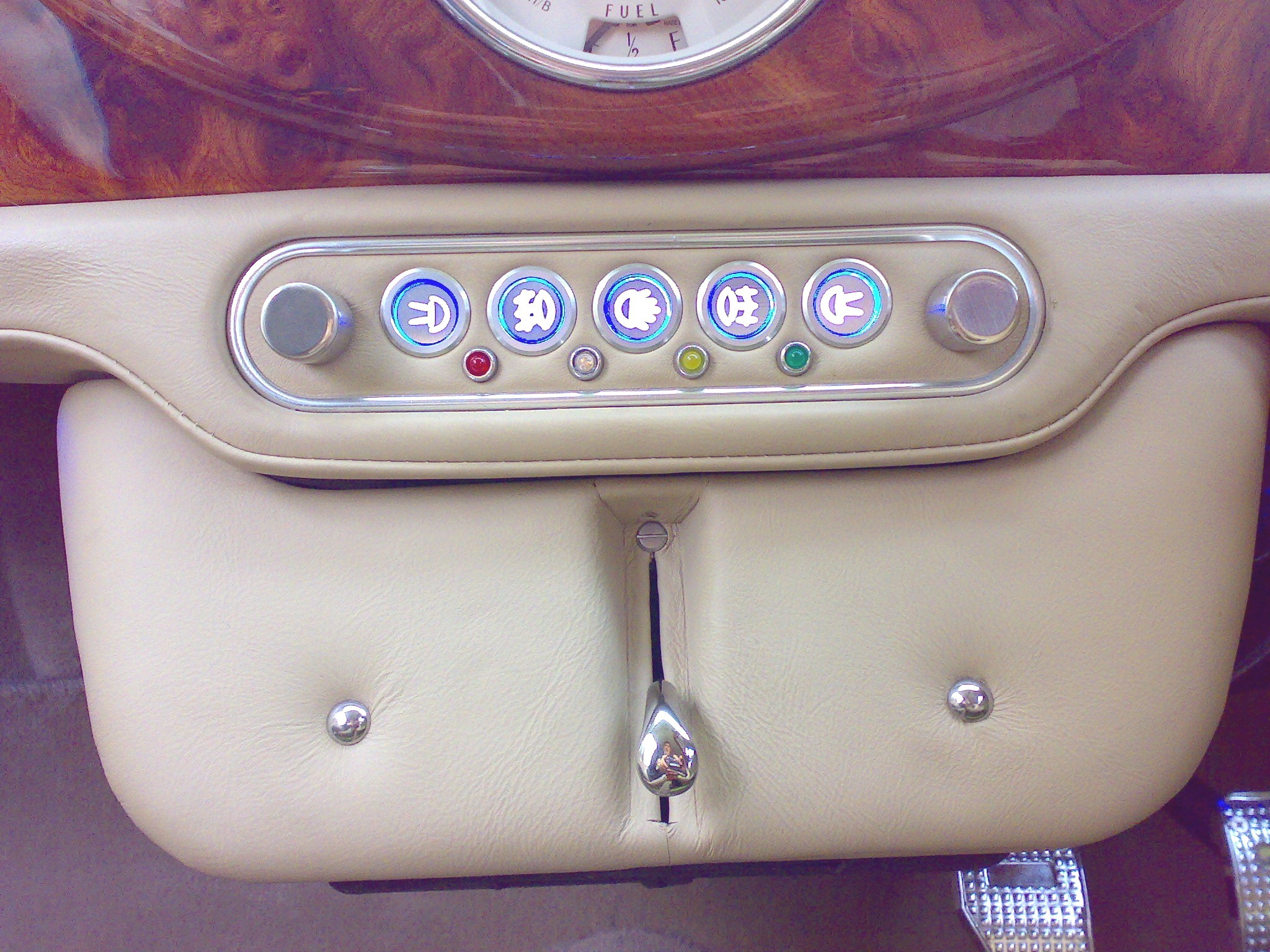

You could obtain some Savage engraved switches from Demon Tweeks instead of a double rocker then make up your own 5 switch panel to fit them (you will however need a sidelight switch and a separate headlight switch).
I've attached a couple of shots from my van showing these switches fitted. The blue LED backlight when the switch is depressed is very good. The hazard has a flashing red backlight.
They're relatively easly to connect up too.

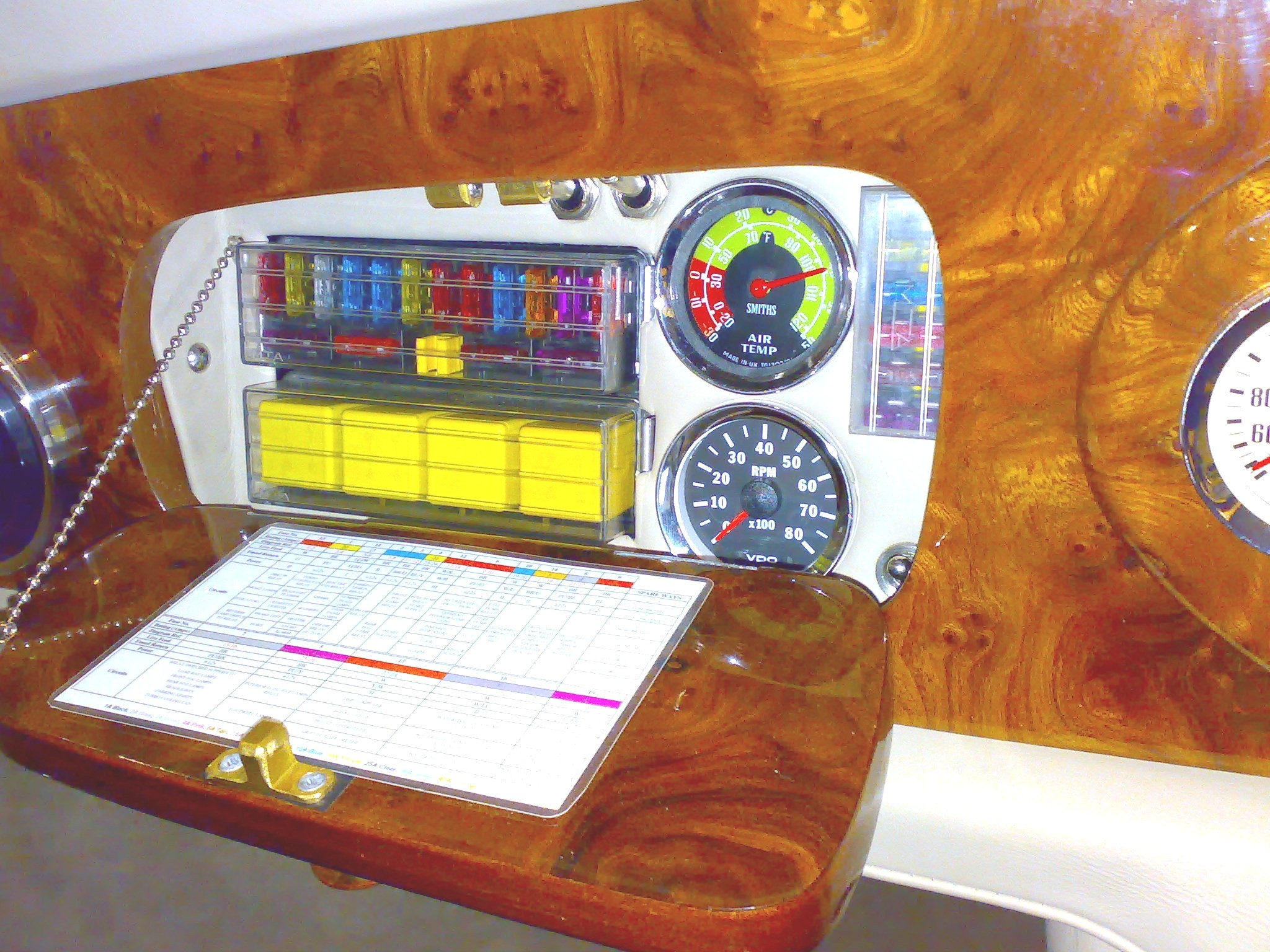

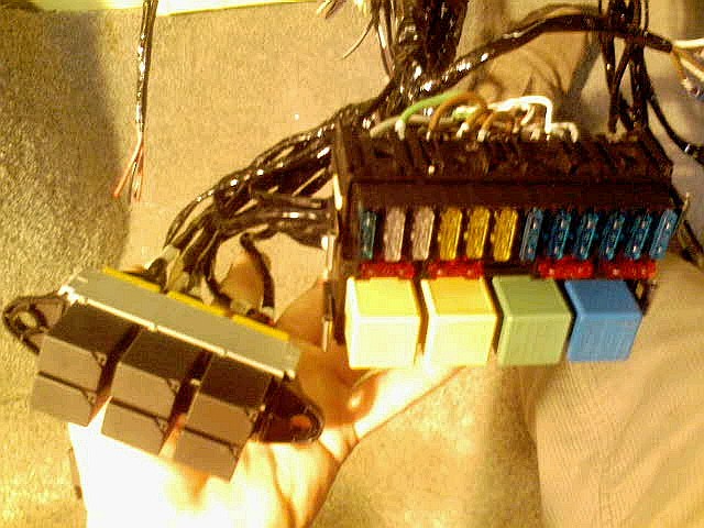

I've also added a shot of the fuse box and relay box on the van. These parts are from Vehicle Wiring Products and slot together. Again, really easy and good quality. I've got this lot in my LH glovebox and the main earth is nice and dry, up above the heater on the bulkhead out of the wet.

The cable pull knobs are actually st.steel switch covers from a double pole wall light switch plate bought at B&Q.
I removed them from the plate, trimmed my plastic choke and heater knobs to suit the internal diameter of the stainless jobbies then stuck em on using one of those white ultra strength DIY adhesives.
The plastic ones just looked completely out of place against the rest of the dash.
