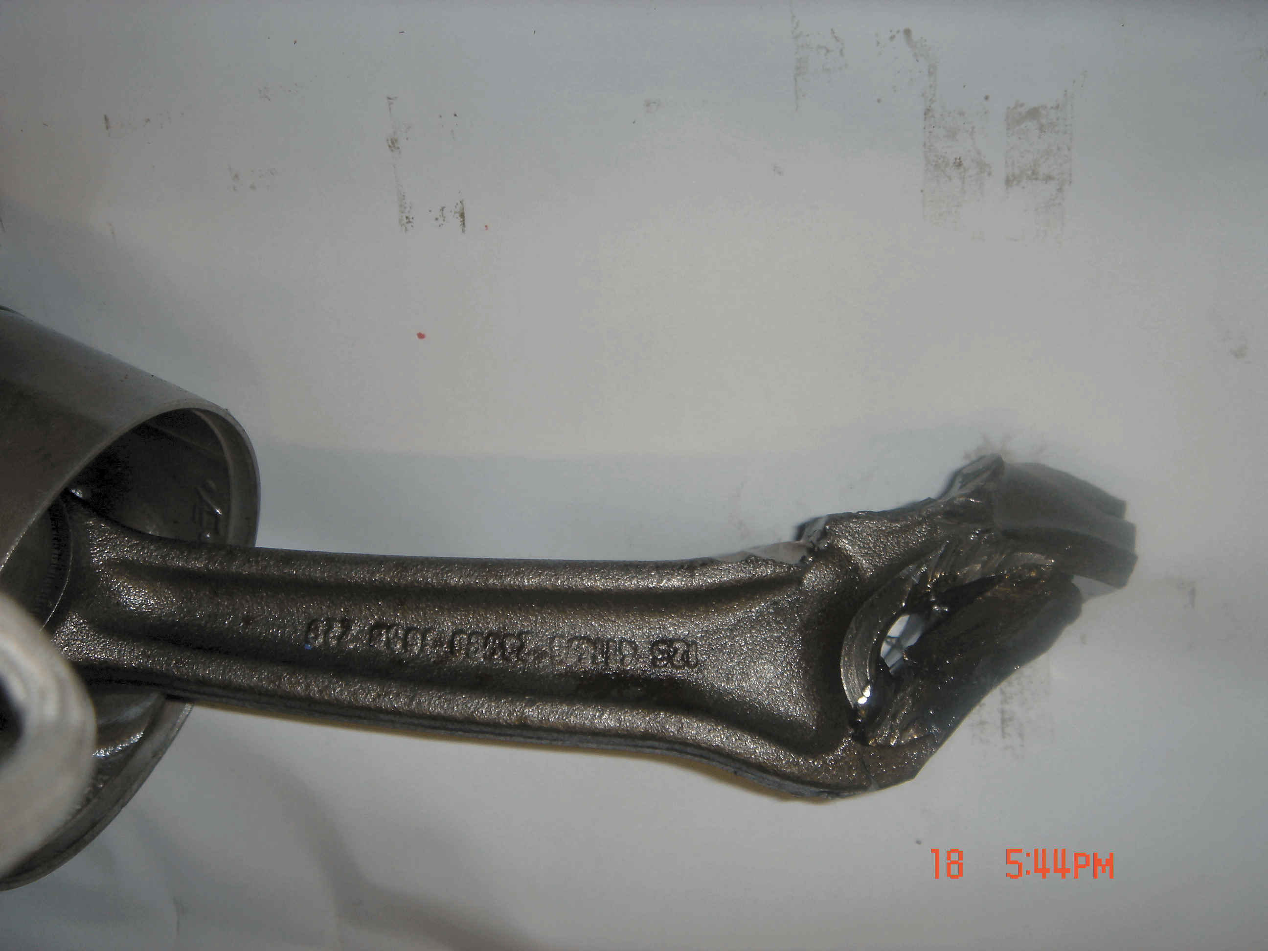

Just number 3 is needed really. The piston got friendly with the head after the big end bolts on the rod decided they weren't going to play anymore. So rod and Piston are US. Thankfully the block survived and the crank is in intensive care but may still pull through.

Also the rod bolt hoe can wander a fair bit on A+ rods, do you have a pic of the one that let go, or is it now scrapnell.

Mini13 - I still have the mullered rod and piston but i doesn't tell me much. I'll see if I can get some pics of it.
4310 Posts
We love to see damage:)

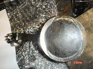

hopefully a picture of the piston damaged
got it to work. see Damage.

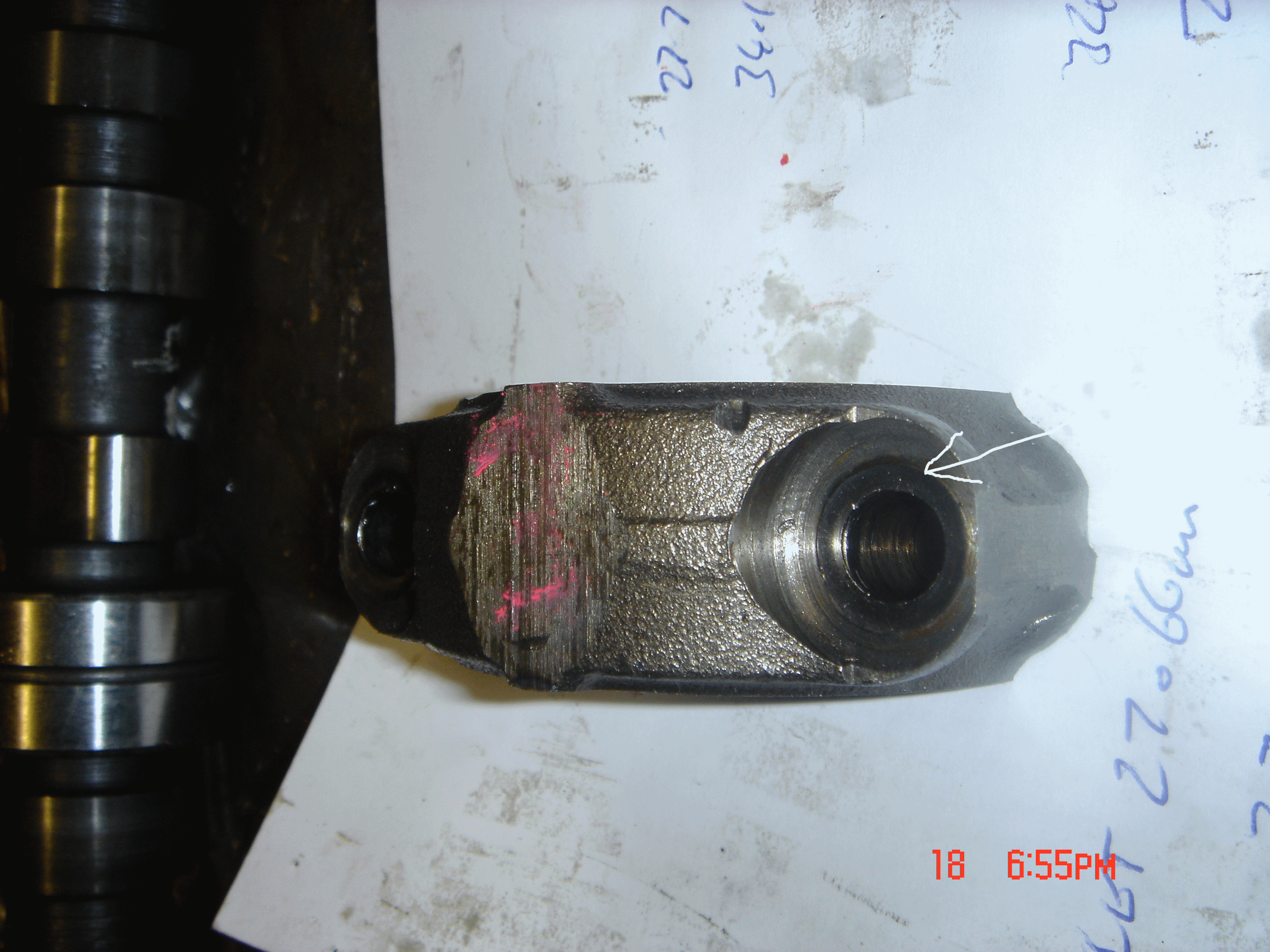

Other info
I can't find one of the nuts and the other had a stripped thread that we on the big end. Strange wear pattern on ght big end (see pic) any ideas?
Oh I've now sourced another Piston, The Crank is out of intensive care and will be up and running in a couple of weeks. A new rod will be joining the crew along with some more ARP bolts.
